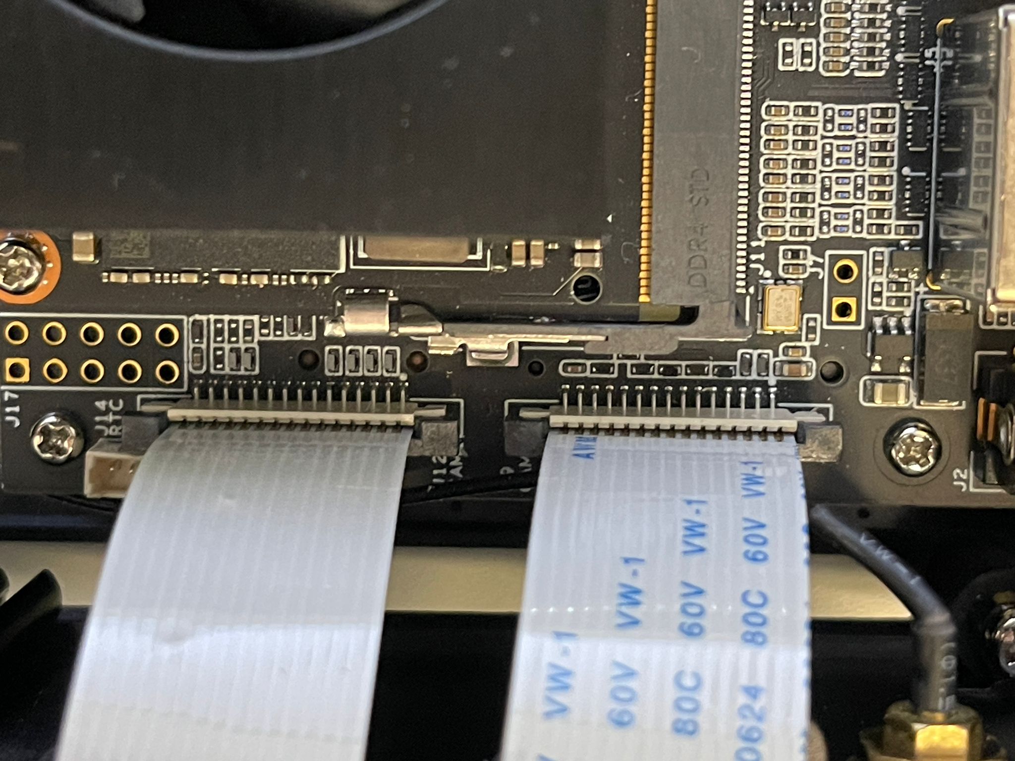

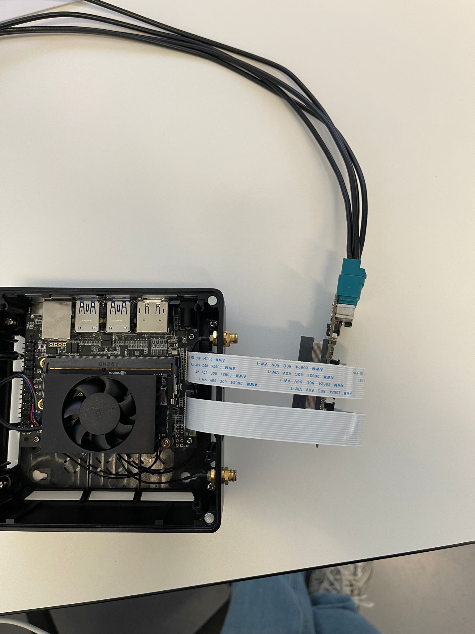

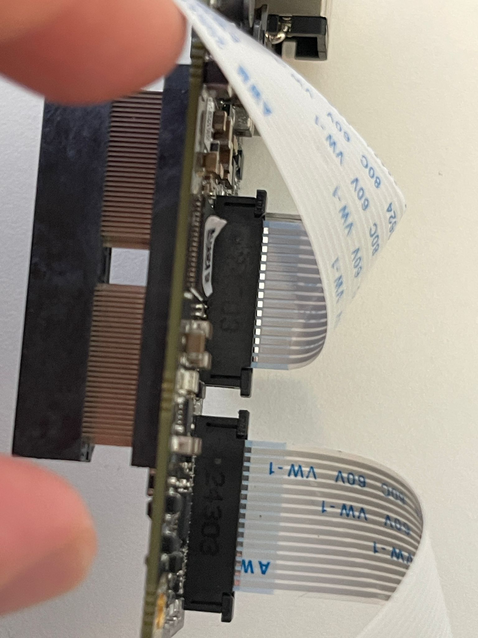

Hi @daiduc
We replicated your setup and were unable to replicate the issue.
The problem could be caused by unstable I2C communication, possibly due to a poor capture card setup.
Please send pictures of the Jetson with all the GMSL2 connections.
daiduc
September 16, 2025, 8:57am
6
Hi @Myzhar
here are the pictures you asked for
It is kind of odd. I can open the camera in ZED Explorer and through the Python API on SDK 4.2.5. But whenever I try it on SDK 5.x nothing works, it always shows the bmi08g error.
What else can I try?

So I’ve tried to uninstall the driver and the ZED SDK and even used the newest version 5.0.7.
But I’m getting the same error
