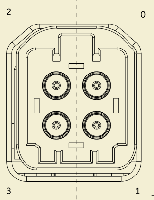

Considering you have 2 ZED X One GS and 1 ZED X, please plug them like so :
Port 0 : ZED X One GS
Port 1 : ZED X
Port 2 : ZED X One GS
If you’re only using your 2 ZED X One GS, you can plug them however you want.

Indeed, due to the weird behavior you are encountering, I had to constraint the pluggin possibilities. I just saw I made a mistake in my answer earlier. Indeed in order for this system to work, a ZED X should share the same i2c bus as a ZED X One GS.
in order to have all 3 cameras working, connect your cameras as such :
  • Port 0 : ZED X One GS
  • Port 1 : ZED X One GS
  • Port 2 : ZED X
In order to check if the configuration is alright, you can check the i2c buses with :
sudo i2cdetect -r 30 and sudo i2cdetect -r 31
If you see two IMUs (0x18 0x68 and 0x19 0x69) on a same bus, it means the configuration is alright.
