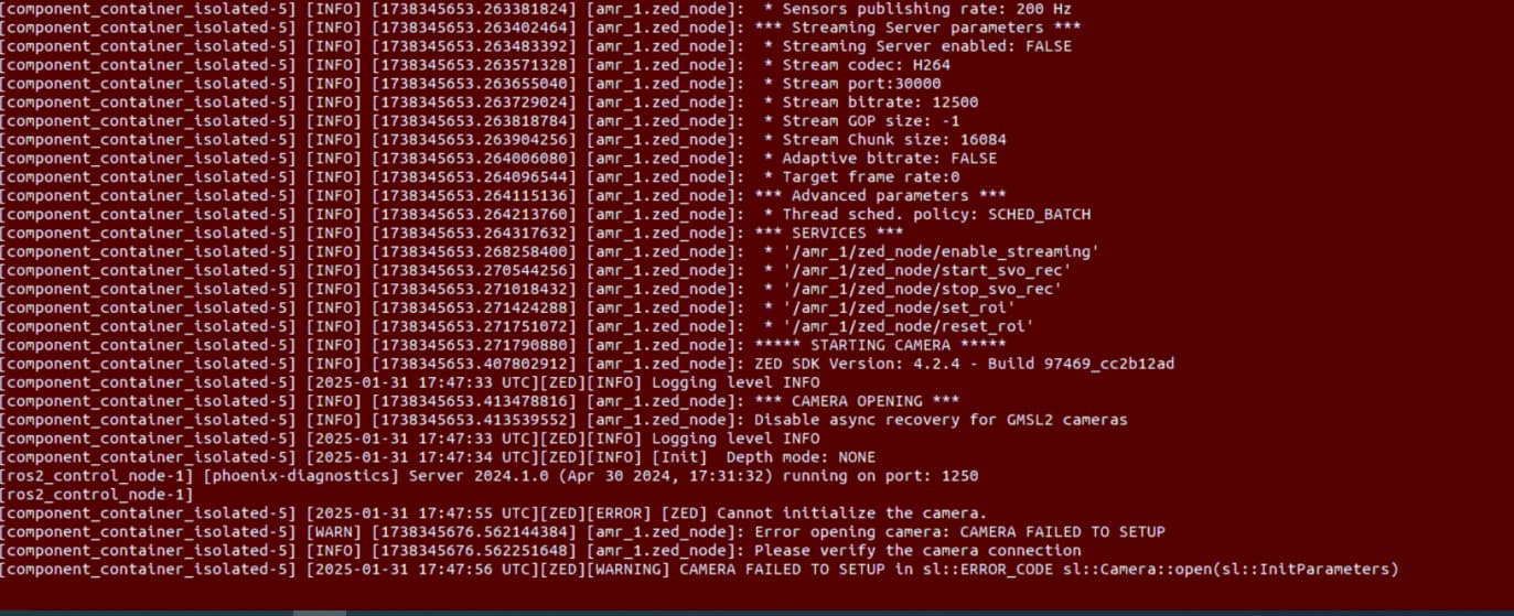

Currently running ZED SDK Version: 4.2.4 - Build 97469_cc2b12ad and latest ROS2 branch build from master, while trying to open ZEDX camera with SVGA @60FPS from Explorer or ROS driver, the camera opening fails, other FPS modes, its fine.
Also question, can GMSL camera’s firmware be upgraded too ? If so, how ?

Hi @anath93
anath93:
Can you post the error message that you get?
There’s no updated firmware for the ZED X camera available.
Hi @Myzhar There is no error on terminal or kernel side of dmesg just the Explorer never loads or on ROS side it says CAMERA OPENING ERROR only with SVGA @60 FPS, other than that all other modes have no issues.
My suggestion, please do bench test if possible.

Please post the console log

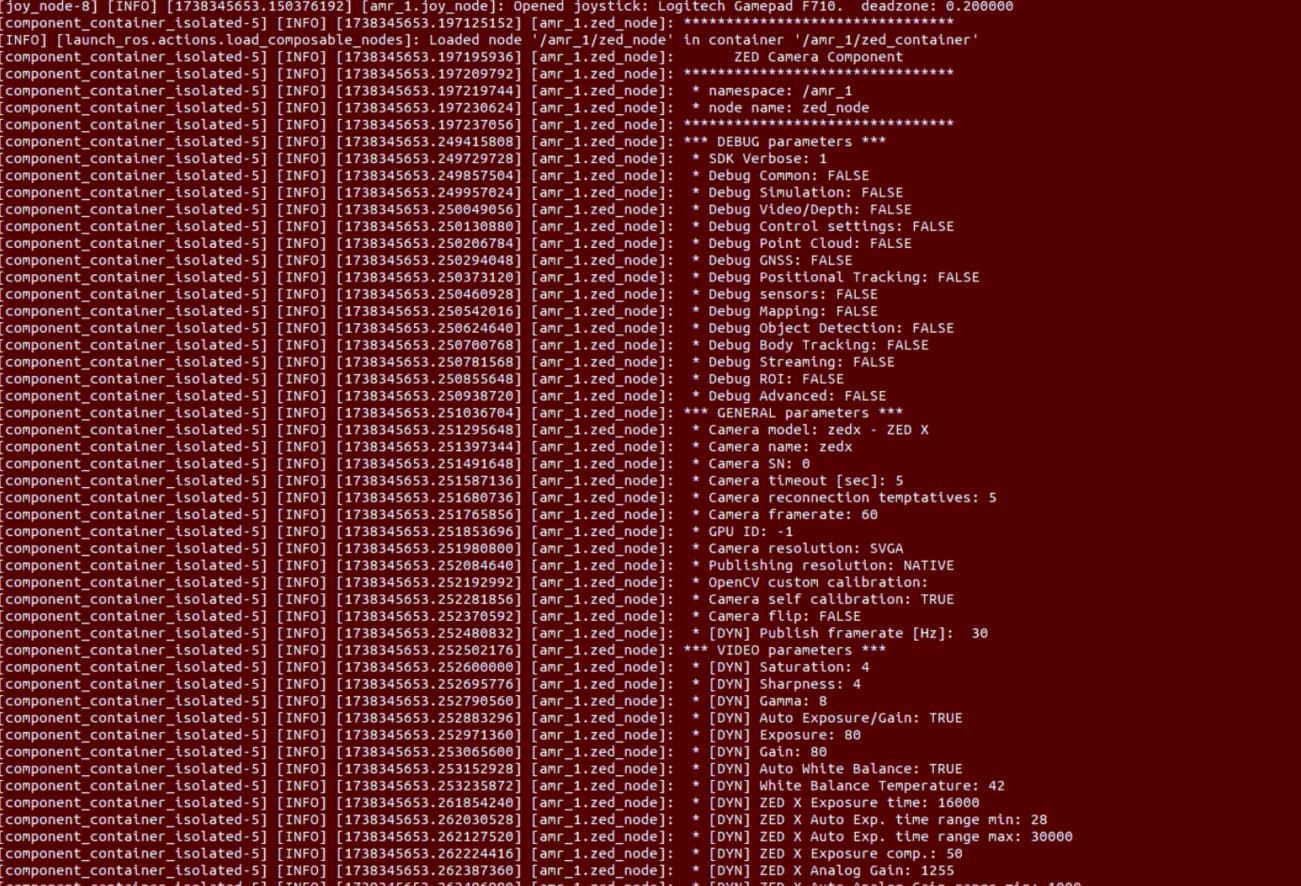

Hi @anath93
I’ve just tested and it works as expected:
[INFO] [launch]: All log files can be found below /home/user/.ros/log/2025-01-31-18-51-13-253894-ubuntu-16401
[INFO] [launch]: Default logging verbosity is set to INFO
Using common configuration file: /home/user/devel/ros2/ros2_ws/install/zed_wrapper/share/zed_wrapper/config/common_stereo.yaml
[INFO] [robot_state_publisher-1]: process started with pid [16414]
[INFO] [component_container_isolated-2]: process started with pid [16416]
[robot_state_publisher-1] [INFO] [1738345873.671132444] [zed.zed_state_publisher]: got segment zed_camera_center
[robot_state_publisher-1] [INFO] [1738345873.671265885] [zed.zed_state_publisher]: got segment zed_camera_link
[robot_state_publisher-1] [INFO] [1738345873.671285501] [zed.zed_state_publisher]: got segment zed_left_camera_frame
[robot_state_publisher-1] [INFO] [1738345873.671295581] [zed.zed_state_publisher]: got segment zed_left_camera_optical_frame
[robot_state_publisher-1] [INFO] [1738345873.671303677] [zed.zed_state_publisher]: got segment zed_right_camera_frame
[robot_state_publisher-1] [INFO] [1738345873.671311261] [zed.zed_state_publisher]: got segment zed_right_camera_optical_frame
[component_container_isolated-2] [INFO] [1738345873.897859561] [zed.zed_container]: Load Library: /home/user/devel/ros2/ros2_ws/install/zed_components/lib/libzed_camera_component.so
[component_container_isolated-2] [INFO] [1738345874.116706519] [zed.zed_container]: Found class: rclcpp_components::NodeFactoryTemplate<stereolabs::ZedCamera>
[component_container_isolated-2] [INFO] [1738345874.116815416] [zed.zed_container]: Instantiate class: rclcpp_components::NodeFactoryTemplate<stereolabs::ZedCamera>
[component_container_isolated-2] [INFO] [1738345874.217043323] [zed.zed_node]: ********************************
[component_container_isolated-2] [INFO] [1738345874.217132444] [zed.zed_node]: ZED Camera Component
[component_container_isolated-2] [INFO] [1738345874.217146492] [zed.zed_node]: ********************************
[component_container_isolated-2] [INFO] [1738345874.217157596] [zed.zed_node]: * namespace: /zed
[component_container_isolated-2] [INFO] [1738345874.217167644] [zed.zed_node]: * node name: zed_node
[component_container_isolated-2] [INFO] [1738345874.217176764] [zed.zed_node]: ********************************
[INFO] [launch_ros.actions.load_composable_nodes]: Loaded node '/zed/zed_node' in container '/zed/zed_container'
[component_container_isolated-2] [INFO] [1738345874.267444158] [zed.zed_node]: *** DEBUG parameters ***
[component_container_isolated-2] [INFO] [1738345874.267731679] [zed.zed_node]: * SDK Verbose: 1
[component_container_isolated-2] [INFO] [1738345874.267830688] [zed.zed_node]: * Debug Common: FALSE
[component_container_isolated-2] [INFO] [1738345874.267917184] [zed.zed_node]: * Debug Simulation: FALSE
[component_container_isolated-2] [INFO] [1738345874.268007456] [zed.zed_node]: * Debug Video/Depth: FALSE
[component_container_isolated-2] [INFO] [1738345874.268080449] [zed.zed_node]: * Debug Control settings: FALSE
[component_container_isolated-2] [INFO] [1738345874.268148833] [zed.zed_node]: * Debug Point Cloud: FALSE
[component_container_isolated-2] [INFO] [1738345874.268208865] [zed.zed_node]: * Debug GNSS: FALSE
[component_container_isolated-2] [INFO] [1738345874.268265025] [zed.zed_node]: * Debug Positional Tracking: FALSE
[component_container_isolated-2] [INFO] [1738345874.268326146] [zed.zed_node]: * Debug sensors: FALSE
[component_container_isolated-2] [INFO] [1738345874.268384034] [zed.zed_node]: * Debug Mapping: FALSE
[component_container_isolated-2] [INFO] [1738345874.268445794] [zed.zed_node]: * Debug Object Detection: FALSE
[component_container_isolated-2] [INFO] [1738345874.268499650] [zed.zed_node]: * Debug Body Tracking: FALSE
[component_container_isolated-2] [INFO] [1738345874.268558562] [zed.zed_node]: * Debug Streaming: FALSE
[component_container_isolated-2] [INFO] [1738345874.268618947] [zed.zed_node]: * Debug ROI: FALSE
[component_container_isolated-2] [INFO] [1738345874.268679427] [zed.zed_node]: * Debug Advanced: FALSE
[component_container_isolated-2] [INFO] [1738345874.268764771] [zed.zed_node]: *** GENERAL parameters ***
[component_container_isolated-2] [INFO] [1738345874.268950084] [zed.zed_node]: * Camera model: zedx - ZED X
[component_container_isolated-2] [INFO] [1738345874.269022180] [zed.zed_node]: * Camera name: zed
[component_container_isolated-2] [INFO] [1738345874.269085732] [zed.zed_node]: * Camera SN: 0
[component_container_isolated-2] [INFO] [1738345874.269151749] [zed.zed_node]: * Camera timeout [sec]: 5
[component_container_isolated-2] [INFO] [1738345874.269213093] [zed.zed_node]: * Camera reconnection temptatives: 5
[component_container_isolated-2] [INFO] [1738345874.269275077] [zed.zed_node]: * Camera framerate: 60
[component_container_isolated-2] [INFO] [1738345874.269328677] [zed.zed_node]: * GPU ID: -1
[component_container_isolated-2] [INFO] [1738345874.269437350] [zed.zed_node]: * Camera resolution: SVGA
[component_container_isolated-2] [INFO] [1738345874.269507846] [zed.zed_node]: * Publishing resolution: CUSTOM
[component_container_isolated-2] [INFO] [1738345874.269601702] [zed.zed_node]: * Publishing downscale factor: 2
[component_container_isolated-2] [INFO] [1738345874.269664487] [zed.zed_node]: * OpenCV custom calibration:
[component_container_isolated-2] [INFO] [1738345874.269726119] [zed.zed_node]: * Camera self calibration: TRUE
[component_container_isolated-2] [INFO] [1738345874.269781991] [zed.zed_node]: * Camera flip: FALSE
[component_container_isolated-2] [INFO] [1738345874.269847975] [zed.zed_node]: * [DYN] Publish framerate [Hz]: 15
[component_container_isolated-2] [INFO] [1738345874.269866183] [zed.zed_node]: *** VIDEO parameters ***
[component_container_isolated-2] [INFO] [1738345874.269929224] [zed.zed_node]: * [DYN] Saturation: 4
[component_container_isolated-2] [INFO] [1738345874.269988424] [zed.zed_node]: * [DYN] Sharpness: 4
[component_container_isolated-2] [INFO] [1738345874.270046664] [zed.zed_node]: * [DYN] Gamma: 8
[component_container_isolated-2] [INFO] [1738345874.270107720] [zed.zed_node]: * [DYN] Auto Exposure/Gain: TRUE
[component_container_isolated-2] [INFO] [1738345874.270165481] [zed.zed_node]: * [DYN] Exposure: 80
[component_container_isolated-2] [INFO] [1738345874.270231689] [zed.zed_node]: * [DYN] Gain: 80
[component_container_isolated-2] [INFO] [1738345874.270288969] [zed.zed_node]: * [DYN] Auto White Balance: TRUE
[component_container_isolated-2] [INFO] [1738345874.270349417] [zed.zed_node]: * [DYN] White Balance Temperature: 42
[component_container_isolated-2] [INFO] [1738345874.270408874] [zed.zed_node]: * [DYN] ZED X Exposure time: 16000
[component_container_isolated-2] [INFO] [1738345874.270470890] [zed.zed_node]: * [DYN] ZED X Auto Exp. time range min: 28
[component_container_isolated-2] [INFO] [1738345874.270530858] [zed.zed_node]: * [DYN] ZED X Auto Exp. time range max: 30000
[component_container_isolated-2] [INFO] [1738345874.270590218] [zed.zed_node]: * [DYN] ZED X Exposure comp.: 50
[component_container_isolated-2] [INFO] [1738345874.270729195] [zed.zed_node]: * [DYN] ZED X Analog Gain: 1255
[component_container_isolated-2] [INFO] [1738345874.270796363] [zed.zed_node]: * [DYN] ZED X Auto Analog Gain range min: 1000
[component_container_isolated-2] [INFO] [1738345874.270855915] [zed.zed_node]: * [DYN] ZED X Auto Analog Gain range max: 16000
[component_container_isolated-2] [INFO] [1738345874.270916940] [zed.zed_node]: * [DYN] ZED X Digital Gain: 1
[component_container_isolated-2] [INFO] [1738345874.270975724] [zed.zed_node]: * [DYN] ZED X Auto Digital Gain range min: 1
[component_container_isolated-2] [INFO] [1738345874.271037388] [zed.zed_node]: * [DYN] ZED X Auto Digital Gain range max: 256
[component_container_isolated-2] [INFO] [1738345874.271092684] [zed.zed_node]: * [DYN] ZED X Auto Digital Gain range max: 50
[component_container_isolated-2] [INFO] [1738345874.271113004] [zed.zed_node]: *** DEPTH parameters ***
[component_container_isolated-2] [INFO] [1738345874.271197325] [zed.zed_node]: * Depth mode: NEURAL [4]
[component_container_isolated-2] [INFO] [1738345874.271266669] [zed.zed_node]: * Min depth [m]: 0.3
[component_container_isolated-2] [INFO] [1738345874.271338701] [zed.zed_node]: * Max depth [m]: 10
[component_container_isolated-2] [INFO] [1738345874.271405005] [zed.zed_node]: * Depth Stabilization: 1
[component_container_isolated-2] [INFO] [1738345874.271465966] [zed.zed_node]: * OpenNI mode (16bit point cloud): FALSE
[component_container_isolated-2] [INFO] [1738345874.271530958] [zed.zed_node]: * [DYN] Point cloud rate [Hz]: 5
[component_container_isolated-2] [INFO] [1738345874.271594094] [zed.zed_node]: * [DYN] Depth Confidence: 50
[component_container_isolated-2] [INFO] [1738345874.271661486] [zed.zed_node]: * [DYN] Depth Texture Confidence: 100
[component_container_isolated-2] [INFO] [1738345874.271723183] [zed.zed_node]: * [DYN] Remove saturated areas: TRUE
[component_container_isolated-2] [INFO] [1738345874.271742671] [zed.zed_node]: *** GNSS FUSION parameters ***
[component_container_isolated-2] [INFO] [1738345874.271812655] [zed.zed_node]: * GNSS fusion enabled: FALSE
[component_container_isolated-2] [INFO] [1738345874.271834031] [zed.zed_node]: *** POSITIONAL TRACKING parameters ***
[component_container_isolated-2] [INFO] [1738345874.271888143] [zed.zed_node]: * Positional tracking enabled: TRUE
[component_container_isolated-2] [INFO] [1738345874.271962128] [zed.zed_node]: * Positional tracking mode: GEN 1
[component_container_isolated-2] [INFO] [1738345874.272086640] [zed.zed_node]: * Map frame id: map
[component_container_isolated-2] [INFO] [1738345874.272150992] [zed.zed_node]: * Odometry frame id: odom
[component_container_isolated-2] [INFO] [1738345874.272218449] [zed.zed_node]: * Broadcast Odometry TF: TRUE
[component_container_isolated-2] [INFO] [1738345874.272276913] [zed.zed_node]: * Broadcast Pose TF: TRUE
[component_container_isolated-2] [INFO] [1738345874.272340721] [zed.zed_node]: * [DYN] Depth minimum range: 0
[component_container_isolated-2] [INFO] [1738345874.272397649] [zed.zed_node]: * [DYN] TF timestamp offset: 0
[component_container_isolated-2] [INFO] [1738345874.272454321] [zed.zed_node]: * [DYN] Path publishing rate: 2
[component_container_isolated-2] [INFO] [1738345874.272514418] [zed.zed_node]: * Path history lenght: -1
[component_container_isolated-2] [INFO] [1738345874.272579282] [zed.zed_node]: * Initial pose: [0,0,0,0,0,0,]
[component_container_isolated-2] [INFO] [1738345874.272648818] [zed.zed_node]: * Area Memory: TRUE
[component_container_isolated-2] [INFO] [1738345874.272702546] [zed.zed_node]: * Area Memory DB:
[component_container_isolated-2] [INFO] [1738345874.272765011] [zed.zed_node]: * Camera is static: FALSE
[component_container_isolated-2] [INFO] [1738345874.272822355] [zed.zed_node]: * Gravity as origin [not for ZED]: TRUE
[component_container_isolated-2] [INFO] [1738345874.272884851] [zed.zed_node]: * IMU Fusion [not for ZED]: TRUE
[component_container_isolated-2] [INFO] [1738345874.272940723] [zed.zed_node]: * Floor Alignment: FALSE
[component_container_isolated-2] [INFO] [1738345874.273001076] [zed.zed_node]: * Reset Odometry with Loop Closure: TRUE
[component_container_isolated-2] [INFO] [1738345874.273059412] [zed.zed_node]: * 2D mode: FALSE
[component_container_isolated-2] [INFO] [1738345874.273079316] [zed.zed_node]: *** Region of Interest parameters ***
[component_container_isolated-2] [INFO] [1738345874.273140436] [zed.zed_node]: * Automatic ROI generation: FALSE
[component_container_isolated-2] [INFO] [1738345874.273246773] [zed.zed_node]: * Manual ROI polygon: []
[component_container_isolated-2] [INFO] [1738345874.273272661] [zed.zed_node]: *** SENSORS STACK parameters ***
[component_container_isolated-2] [INFO] [1738345874.273327285] [zed.zed_node]: * Broadcast IMU TF [not for ZED]: TRUE
[component_container_isolated-2] [INFO] [1738345874.273382837] [zed.zed_node]: * Sensors Camera Sync: FALSE

What version of the ZED SDK and ZED X Driver are you using?
On the SDK, Version: 4.2.4 - Build 97469_cc2b12ad
On the driver side, stereolabs -zedlink-duo 1.1.0-LI-MAX96712-L4T36.3.0 arm64 NVIDIA Kernel DTB Modified Package by Stereolabs
I did not see this is lower 4.2.2 SDK or lower than that,
