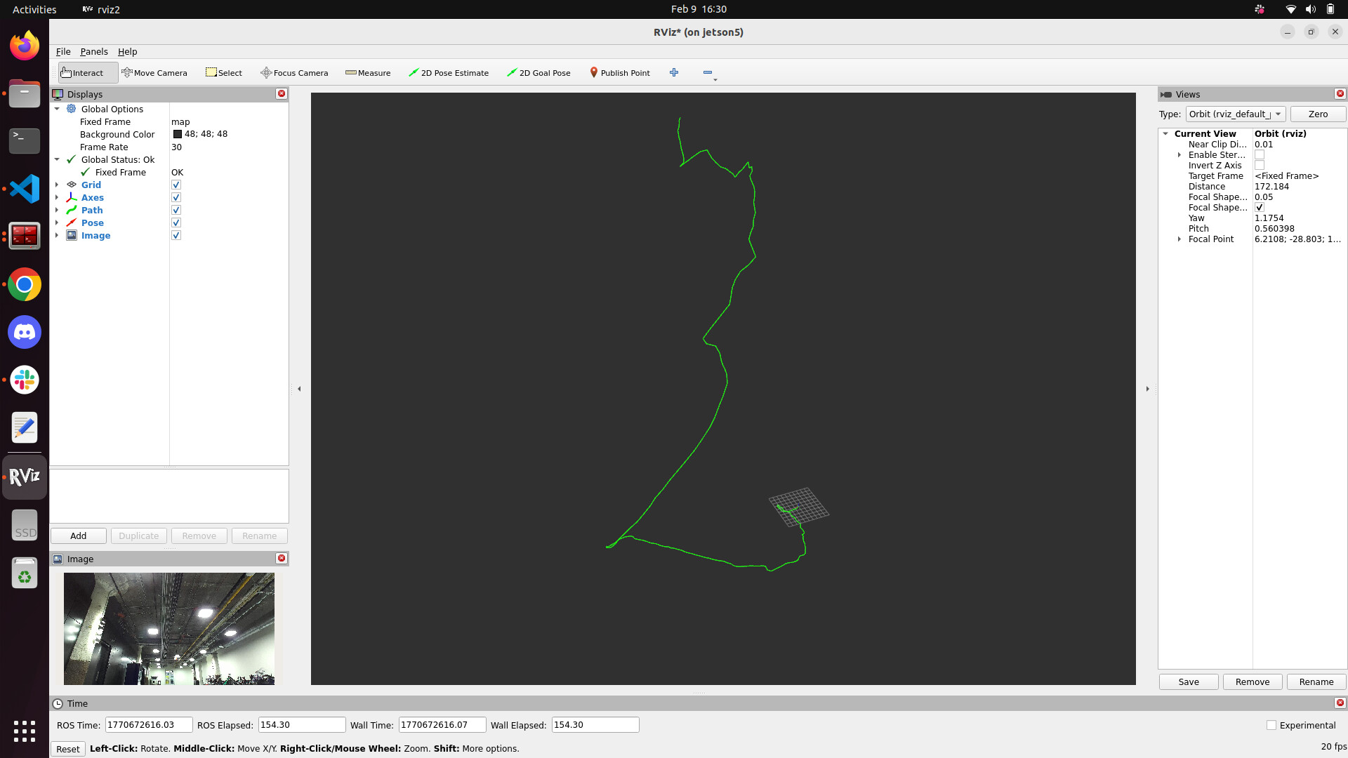

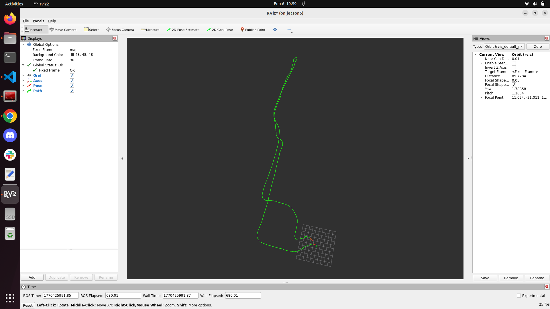

I have been using 5.0.5 for a while with my JetsonOrin NX Jetpack 6.2 and Zed 2i, and it has been working okay with some issues. I updated the SDK to 5.1.2, and it is performing worse. I have attached the params for both cases with results. Please let me know if I am missing something
One more thing to note, when I set 2D mode to true, the pose still moves in the Z axis
ZED SDK 5.1.2 output
ZED SDK 5.0.5 output (close to actual path)
Tried turning ON and OFF loop closure, gravity alignment, the results are the same, happy to provide more info and data if needed

Hi @hey_you
With ZED SDK v5.1.2 we recommend using Positional Tracking GEN_2 instead of GEN_3 because the new version is not yet optimized.
Starting from the next ZED SDK v5.2 GEN_3 will become the default mode for Positional Tracking with improved behaviors and optimized results.
Hi Thank you for the response. I’d suggest, in that case, the config file should also select GEN_2 as the default.
Are there any expected release timelines for 5.2 yet?
Thanks again!
It will be released very soon. We are performing the latest QA tests.
Thank you for the update, that sounds awesome! I will post the results with GEN_2. Also, can I turn off depth from Neural_light while using GEN_2 or GEN_3?
Hi, Tried Gen2 and its performing the worst out of all. I have attached the results.
Please test GEN_3 with the just-released ZED SDK v5.2.

[component_container_isolated-2] [WARN] [1770745351.222512414] [zed.zed_node]: Pos. Track. seems to be locked (pose diff.: 0 m) since 120 frames - Status: MAP_UPDATE
[component_container_isolated-2] [WARN] [1770745351.289575500] [zed.zed_node]: Pos. Track. seems to be locked (pose diff.: 0 m) since 121 frames - Status: MAP_UPDATE
[component_container_isolated-2] [WARN] [1770745351.356505299] [zed.zed_node]: Pos. Track. seems to be locked (pose diff.: 0 m) since 122 frames - Status: MAP_UPDATE
[component_container_isolated-2] [WARN] [1770745351.423463963] [zed.zed_node]: Pos. Track. seems to be locked (pose diff.: 0 m) since 123 frames - Status: MAP_UPDATE
[component_container_isolated-2] [WARN] [1770745351.490483590] [zed.zed_node]: Pos. Track. seems to be locked (pose diff.: 0 m) since 124 frames - Status: MAP_UPDATE
[component_container_isolated-2] [WARN] [1770745351.557486993] [zed.zed_node]: Pos. Track. seems to be locked (pose diff.: 0 m) since 125 frames - Status: MAP_UPDATE
[component_container_isolated-2] [WARN] [1770745351.624444057] [zed.zed_node]: Pos. Track. seems to be locked (pose diff.: 0 m) since 126 frames - Status: MAP_UPDATE
[component_container_isolated-2] [WARN] [1770745351.691711376] [zed.zed_node]: Pos. Track. seems to be locked (pose diff.: 0 m) since 127 frames - Status: MAP_UPDATE
[component_container_isolated-2] [WARN] [1770745351.758357802] [zed.zed_node]: Pos. Track. seems to be locked (pose diff.: 0 m) since 128 frames - Status: MAP_UPDATE
[component_container_isolated-2] [WARN] [1770745351.825365237] [zed.zed_node]: Pos. Track. seems to be locked (pose diff.: 0 m) since 129 frames - Status: MAP_UPDATE
[component_container_isolated-2] [WARN] [1770745351.892350366] [zed.zed_node]: Pos. Track. seems to be locked (pose diff.: 0 m) since 130 frames - Status: MAP_UPDATE
Please also pull the latest version of the ZED ROS2 Wrapper.
Do you have an SVO to share with us to try to replicate this behavior?
I am using the latest wrapper; the previous one anyway doesn’t work. The behaviour is inconsistent, but sure, I can collect an SVO and share if that helps
Thanks!

data: https://drive.google.com/file/d/13_pFVVsaQ1hUpu7GffXikyilWzwqXqNq/view?usp=sharing
Changing the grab rate to 30 did help a little
will keep you posted with my findings
edit: with high grab rate i noticed a glitch where the cam stopped streaming and the poses were not being updated without any eorror, will try 720
I have made a screen recording where it stops publishing images and pose at the exact same spot with high grab rate without any errors.
Yes, this is correct. Higher grab rates improve the performance of the Positional Tracking GEN_3 module.
You can use the publishing rate parameters for depth and images to reduce the system load if you do not need them to be published at the maximum rate.
The Diagnostic information provides details regarding the status of the Positional Tracking module.
Can you post a screenshot of the Runtime Monitor in rqt when the lock happens?
