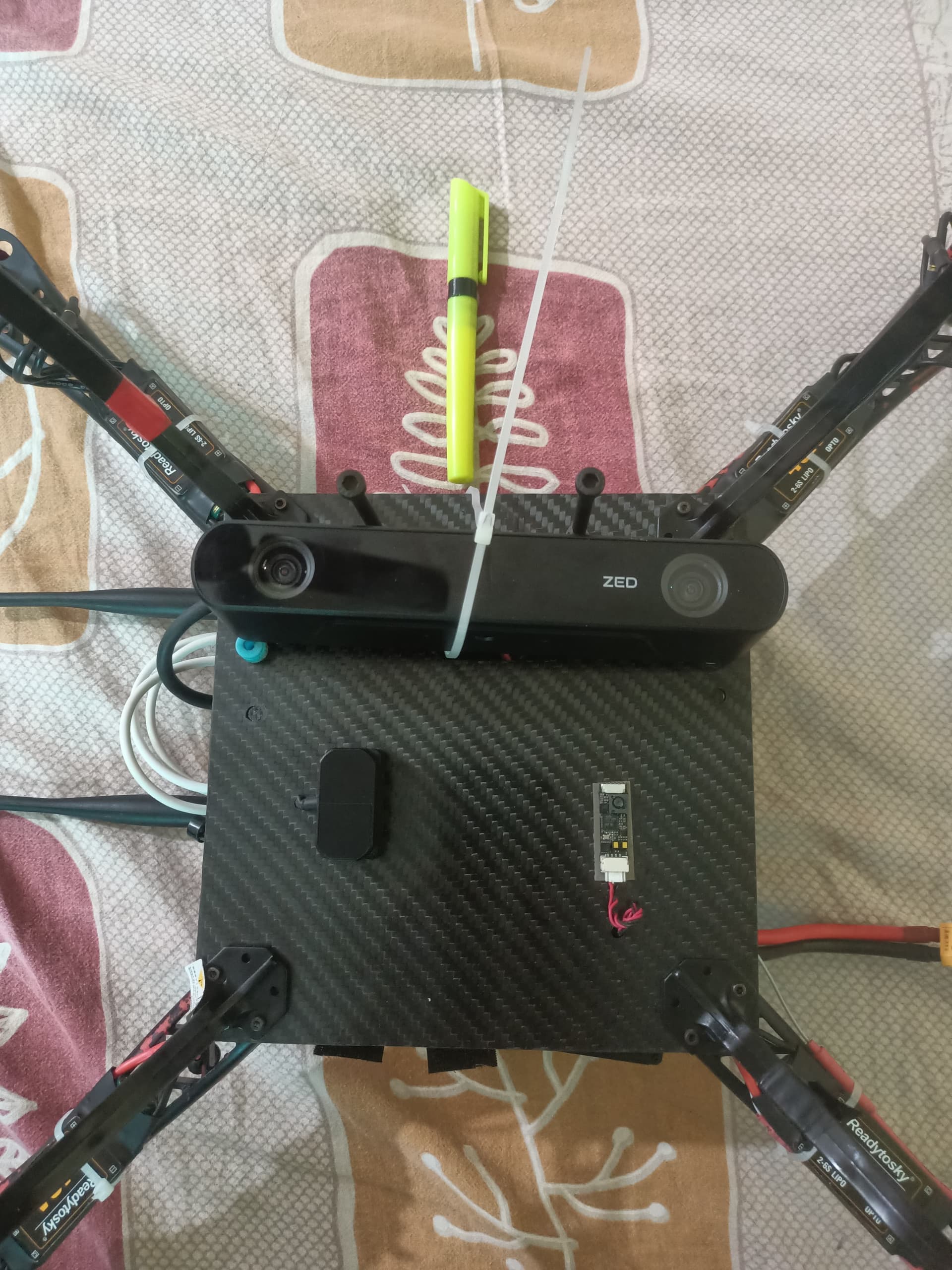

this is how the camera has been mounted.
this image is the down side of the camera and the yellow colour higligther points the nose of the drone
