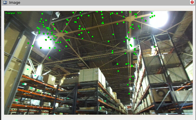

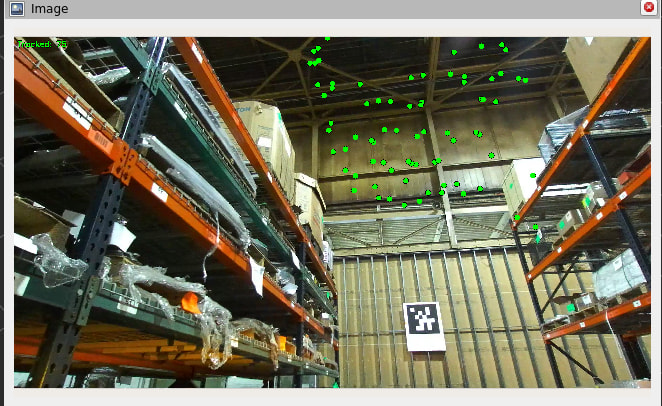

I was wondering what would be a good threshold for map_lm3d.size() and map_lm2d.size() to reset slam to avoid erroneous measurements
When the vehicle is very close to features, as seen in the image

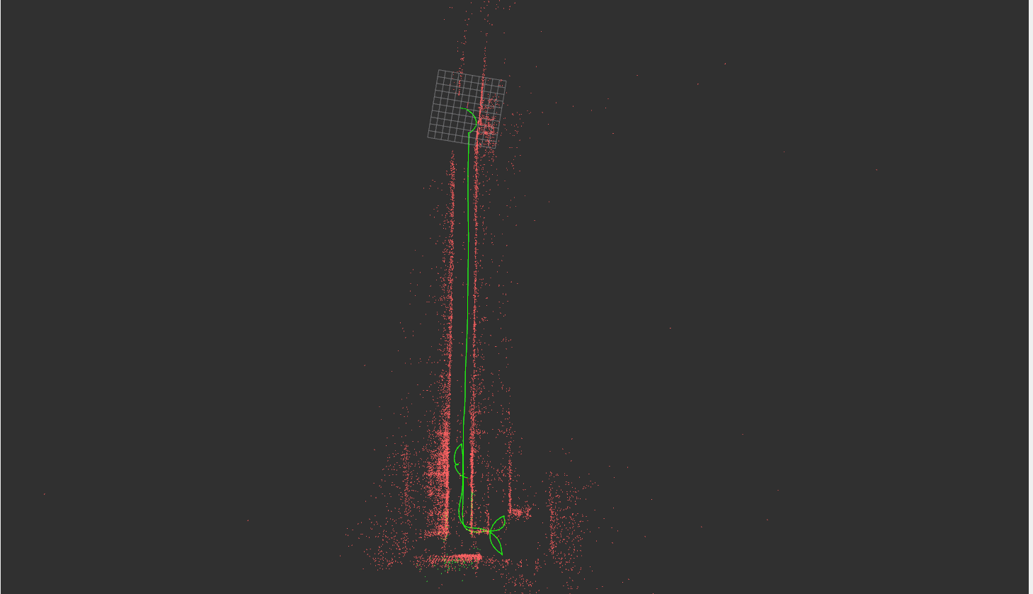

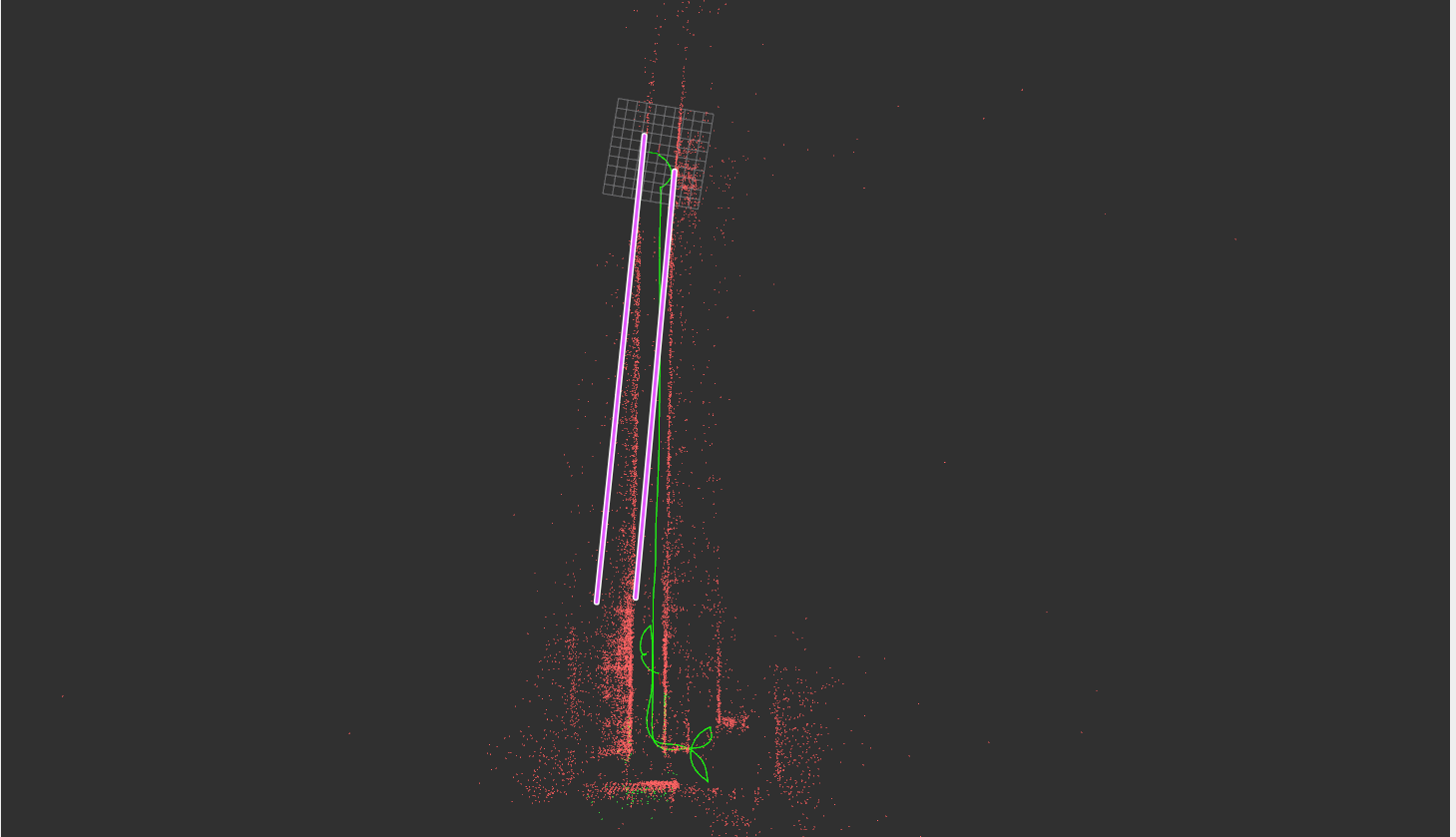

The system accumulates angular error as seen in the next images
The pink line is the approximate real alignment of the asile, and the red points are the tracked points of the slam, which have some error as seen in the image

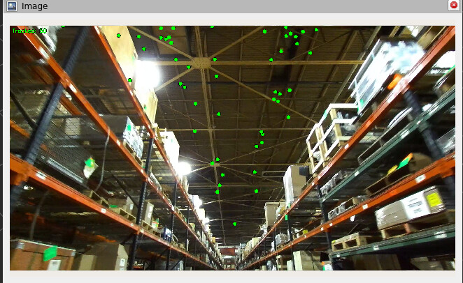

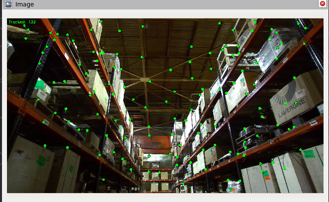

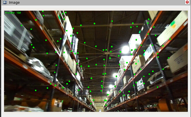

I have some more findings. I was trying to visualize the landmarks in the image. I see that in some images, it just tracks ceiling points. What could be the reason for that
Ideally, it should be like this imo

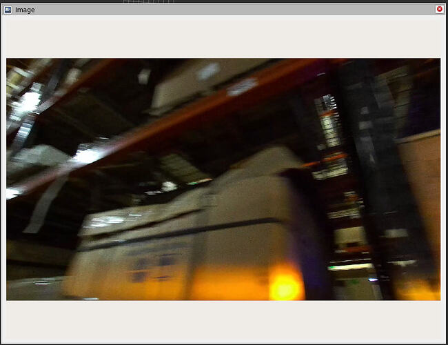

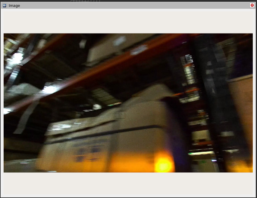

It looks like the motion blur is one of the causes of the reduced number of features
This condition is normally accentuated when the robot is rotating.
You could try to fix the exposure time to a low value to reduce the amount of blur effect.
