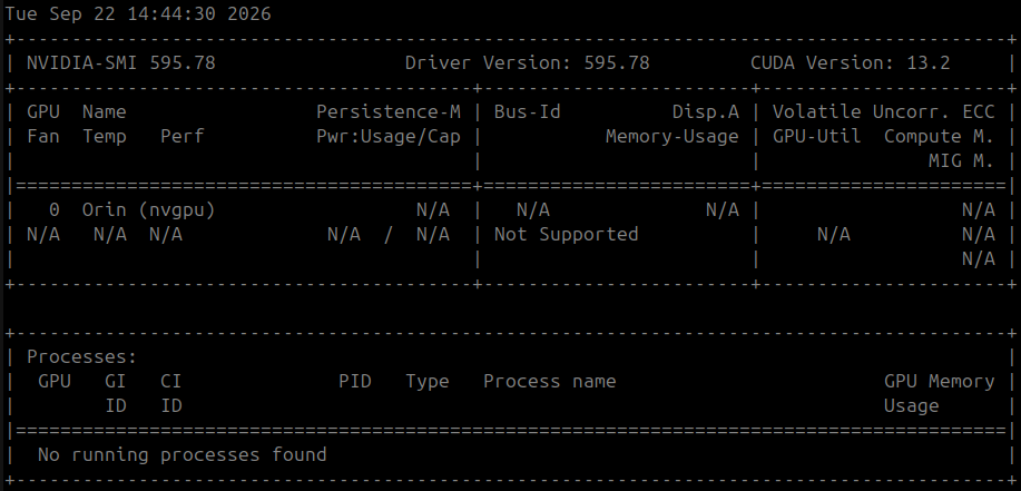

I tested the GPU detection with the nvidia-smi command outside of Docker and got this result :
It looks like it detects the GPU just fine ?
After turning everything off for about 1h, it works again now, but I don’t know for how much longer… What could cause this issue and how could I fix it ?
