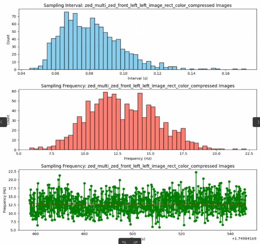

After recording, we extract the rosbag and save the images with a timestamp. Analyzing the timestamps shows that the distribution of the frequency / interval goes from about 7 to 20 Hz which seems a quite high variance to me.
My question is now, if this is a “normal” behavior or if there are some tricks / optimization reduce this high variance of the publishing frequency.

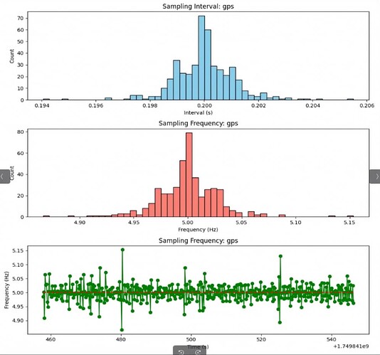

For example we have done the same for our GPS data, there the distribution is much smaller (publishing frequency: 5Hz):

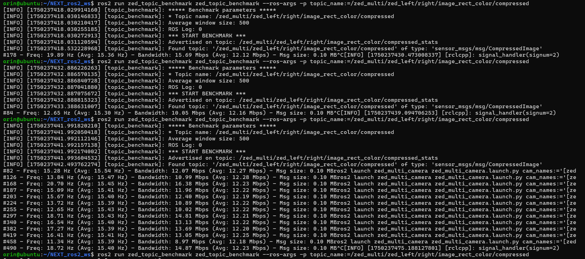

Hi @Myzhar
We have now done some recording subscribing only to one stereo camera (two topics and not eight). Additional to this we have also done some optimiziations in the recording node. The distribution of the frequency variance is still the same…
We are using a Jetson Orin AGX 64GB with a 1TB SSD which has the following properties:
Read speed max.: 7450 MB/s, write speed max.: 6900 MB/s

If have implemented a simple node for checking the timestamps of the each published message and calculate the frequency of it. It seems, the the ZED node mostly correctly publishes the data, but there are some data packages with 7.5 Hz in between. Is there a way to somehow optimize the publishing?
orin@ubuntu:~/NEXT_ros2_ws$ ros2 run zed_check_publishing_hz zed_hz_check_node
[INFO] [1750170996.592782612] [frequency_tracker]: Subscribed to 1 topics
[INFO] [1750170996.693249341] [frequency_tracker]: [/zed_multi/zed_front_left/left/image_rect_color/compressed]: Δt = 0.0667 s → ~14.99 Hz
[INFO] [1750170996.785960508] [frequency_tracker]: [/zed_multi/zed_front_left/left/image_rect_color/compressed]: Δt = 0.0668 s → ~14.96 Hz
[INFO] [1750170996.865553605] [frequency_tracker]: [/zed_multi/zed_front_left/left/image_rect_color/compressed]: Δt = 0.1334 s → ~7.50 Hz
[INFO] [1750170996.919060647] [frequency_tracker]: [/zed_multi/zed_front_left/left/image_rect_color/compressed]: Δt = 0.0668 s → ~14.97 Hz
[INFO] [1750170996.989042092] [frequency_tracker]: [/zed_multi/zed_front_left/left/image_rect_color/compressed]: Δt = 0.0667 s → ~15.00 Hz
[INFO] [1750170997.037101699] [frequency_tracker]: [/zed_multi/zed_front_left/left/image_rect_color/compressed]: Δt = 0.0665 s → ~15.03 Hz
[INFO] [1750170997.118537958] [frequency_tracker]: [/zed_multi/zed_front_left/left/image_rect_color/compressed]: Δt = 0.0667 s → ~15.00 Hz
[INFO] [1750170997.180051542] [frequency_tracker]: [/zed_multi/zed_front_left/left/image_rect_color/compressed]: Δt = 0.0668 s → ~14.96 Hz
[INFO] [1750170997.250865350] [frequency_tracker]: [/zed_multi/zed_front_left/left/image_rect_color/compressed]: Δt = 0.0666 s → ~15.02 Hz
[INFO] [1750170997.325840912] [frequency_tracker]: [/zed_multi/zed_front_left/left/image_rect_color/compressed]: Δt = 0.0666 s → ~15.01 Hz
[INFO] [1750170997.380415968] [frequency_tracker]: [/zed_multi/zed_front_left/left/image_rect_color/compressed]: Δt = 0.0668 s → ~14.98 Hz
[INFO] [1750170997.449452728] [frequency_tracker]: [/zed_multi/zed_front_left/left/image_rect_color/compressed]: Δt = 0.0665 s → ~15.03 Hz
[INFO] [1750170997.502971322] [frequency_tracker]: [/zed_multi/zed_front_left/left/image_rect_color/compressed]: Δt = 0.0667 s → ~14.99 Hz
[INFO] [1750170997.601400487] [frequency_tracker]: [/zed_multi/zed_front_left/left/image_rect_color/compressed]: Δt = 0.0667 s → ~14.98 Hz
[INFO] [1750170997.665126869] [frequency_tracker]: [/zed_multi/zed_front_left/left/image_rect_color/compressed]: Δt = 0.0667 s → ~14.99 Hz
[INFO] [1750170997.717162915] [frequency_tracker]: [/zed_multi/zed_front_left/left/image_rect_color/compressed]: Δt = 0.0666 s → ~15.02 Hz
[INFO] [1750170997.776804281] [frequency_tracker]: [/zed_multi/zed_front_left/left/image_rect_color/compressed]: Δt = 0.0672 s → ~14.88 Hz
[INFO] [1750170997.841117999] [frequency_tracker]: [/zed_multi/zed_front_left/left/image_rect_color/compressed]: Δt = 0.0662 s → ~15.11 Hz
[INFO] [1750170997.926893614] [frequency_tracker]: [/zed_multi/zed_front_left/left/image_rect_color/compressed]: Δt = 0.0669 s → ~14.94 Hz
[INFO] [1750170997.982199432] [frequency_tracker]: [/zed_multi/zed_front_left/left/image_rect_color/compressed]: Δt = 0.0665 s → ~15.05 Hz
[INFO] [1750170998.057597336] [frequency_tracker]: [/zed_multi/zed_front_left/left/image_rect_color/compressed]: Δt = 0.0669 s → ~14.95 Hz
[INFO] [1750170998.149062756] [frequency_tracker]: [/zed_multi/zed_front_left/left/image_rect_color/compressed]: Δt = 0.0667 s → ~14.99 Hz
[INFO] [1750170998.209260194] [frequency_tracker]: [/zed_multi/zed_front_left/left/image_rect_color/compressed]: Δt = 0.0664 s → ~15.06 Hz
[INFO] [1750170998.290055835] [frequency_tracker]: [/zed_multi/zed_front_left/left/image_rect_color/compressed]: Δt = 0.0667 s → ~15.00 Hz
[INFO] [1750170998.380416505] [frequency_tracker]: [/zed_multi/zed_front_left/left/image_rect_color/compressed]: Δt = 0.0669 s → ~14.95 Hz
[INFO] [1750170998.454492246] [frequency_tracker]: [/zed_multi/zed_front_left/left/image_rect_color/compressed]: Δt = 0.1331 s → ~7.51 Hz
[INFO] [1750170998.530207689] [frequency_tracker]: [/zed_multi/zed_front_left/left/image_rect_color/compressed]: Δt = 0.0667 s → ~14.99 Hz
[INFO] [1750170998.602964148] [frequency_tracker]: [/zed_multi/zed_front_left/left/image_rect_color/compressed]: Δt = 0.0667 s → ~14.99 Hz
[INFO] [1750170998.657373250] [frequency_tracker]: [/zed_multi/zed_front_left/left/image_rect_color/compressed]: Δt = 0.0668 s → ~14.97 Hz
[INFO] [1750170998.726706557] [frequency_tracker]: [/zed_multi/zed_front_left/left/image_rect_color/compressed]: Δt = 0.0668 s → ~14.97 Hz
[INFO] [1750170998.800974493] [frequency_tracker]: [/zed_multi/zed_front_left/left/image_rect_color/compressed]: Δt = 0.0665 s → ~15.03 Hz
[INFO] [1750170998.867133869] [frequency_tracker]: [/zed_multi/zed_front_left/left/image_rect_color/compressed]: Δt = 0.0667 s → ~15.00 Hz
[INFO] [1750170998.927162568] [frequency_tracker]: [/zed_multi/zed_front_left/left/image_rect_color/compressed]: Δt = 0.0667 s → ~15.00 Hz
[INFO] [1750170998.978638926] [frequency_tracker]: [/zed_multi/zed_front_left/left/image_rect_color/compressed]: Δt = 0.0669 s → ~14.95 Hz
[INFO] [1750170999.072807679] [frequency_tracker]: [/zed_multi/zed_front_left/left/image_rect_color/compressed]: Δt = 0.0666 s → ~15.01 Hz
[INFO] [1750170999.130698205] [frequency_tracker]: [/zed_multi/zed_front_left/left/image_rect_color/compressed]: Δt = 0.0669 s → ~14.94 Hz
[INFO] [1750170999.211748889] [frequency_tracker]: [/zed_multi/zed_front_left/left/image_rect_color/compressed]: Δt = 0.0665 s → ~15.04 Hz
[INFO] [1750170999.277251104] [frequency_tracker]: [/zed_multi/zed_front_left/left/image_rect_color/compressed]: Δt = 0.0666 s → ~15.02 Hz
[INFO] [1750170999.333807403] [frequency_tracker]: [/zed_multi/zed_front_left/left/image_rect_color/compressed]: Δt = 0.0665 s → ~15.03 Hz
[INFO] [1750170999.409121945] [frequency_tracker]: [/zed_multi/zed_front_left/left/image_rect_color/compressed]: Δt = 0.0667 s → ~14.99 Hz
[INFO] [1750170999.475848016] [frequency_tracker]: [/zed_multi/zed_front_left/left/image_rect_color/compressed]: Δt = 0.0667 s → ~15.00 Hz
[INFO] [1750170999.558232095] [frequency_tracker]: [/zed_multi/zed_front_left/left/image_rect_color/compressed]: Δt = 0.0669 s → ~14.94 Hz
[INFO] [1750170999.636692664] [frequency_tracker]: [/zed_multi/zed_front_left/left/image_rect_color/compressed]: Δt = 0.0664 s → ~15.06 Hz
[INFO] [1750170999.712160136] [frequency_tracker]: [/zed_multi/zed_front_left/left/image_rect_color/compressed]: Δt = 0.0669 s → ~14.96 Hz
[INFO] [1750170999.787662552] [frequency_tracker]: [/zed_multi/zed_front_left/left/image_rect_color/compressed]: Δt = 0.0665 s → ~15.04 Hz
[INFO] [1750170999.858731659] [frequency_tracker]: [/zed_multi/zed_front_left/left/image_rect_color/compressed]: Δt = 0.0667 s → ~14.99 Hz
[INFO] [1750170999.956588592] [frequency_tracker]: [/zed_multi/zed_front_left/left/image_rect_color/compressed]: Δt = 0.1332 s → ~7.51 Hz
[INFO] [1750171000.046027808] [frequency_tracker]: [/zed_multi/zed_front_left/left/image_rect_color/compressed]: Δt = 0.0669 s → ~14.94 Hz
[INFO] [1750171000.098491730] [frequency_tracker]: [/zed_multi/zed_front_left/left/image_rect_color/compressed]: Δt = 0.0667 s → ~14.98 Hz
[INFO] [1750171000.183403620] [frequency_tracker]: [/zed_multi/zed_front_left/left/image_rect_color/compressed]: Δt = 0.0666 s → ~15.02 Hz
[INFO] [1750171000.232096163] [frequency_tracker]: [/zed_multi/zed_front_left/left/image_rect_color/compressed]: Δt = 0.0667 s → ~15.00 Hz
[INFO] [1750171000.301490078] [frequency_tracker]: [/zed_multi/zed_front_left/left/image_rect_color/compressed]: Δt = 0.0664 s → ~15.05 Hz
[INFO] [1750171000.393856503] [frequency_tracker]: [/zed_multi/zed_front_left/left/image_rect_color/compressed]: Δt = 0.0668 s → ~14.96 Hz
[INFO] [1750171000.458598834] [frequency_tracker]: [/zed_multi/zed_front_left/left/image_rect_color/compressed]: Δt = 0.1332 s → ~7.51 Hz
[INFO] [1750171000.526099604] [frequency_tracker]: [/zed_multi/zed_front_left/left/image_rect_color/compressed]: Δt = 0.0667 s → ~14.99 Hz
[INFO] [1750171000.593604918] [frequency_tracker]: [/zed_multi/zed_front_left/left/image_rect_color/compressed]: Δt = 0.0666 s → ~15.00 Hz
[INFO] [1750171000.647060086] [frequency_tracker]: [/zed_multi/zed_front_left/left/image_rect_color/compressed]: Δt = 0.0667 s → ~15.00 Hz
[INFO] [1750171000.736430501] [frequency_tracker]: [/zed_multi/zed_front_left/left/image_rect_color/compressed]: Δt = 0.0667 s → ~15.00 Hz
[INFO] [1750171000.802445938] [frequency_tracker]: [/zed_multi/zed_front_left/left/image_rect_color/compressed]: Δt = 0.0667 s → ~15.00 Hz
[INFO] [1750171000.858675577] [frequency_tracker]: [/zed_multi/zed_front_left/left/image_rect_color/compressed]: Δt = 0.0668 s → ~14.97 Hz
[INFO] [1750171000.912144761] [frequency_tracker]: [/zed_multi/zed_front_left/left/image_rect_color/compressed]: Δt = 0.0668 s → ~14.97 Hz
[INFO] [1750171000.973501798] [frequency_tracker]: [/zed_multi/zed_front_left/left/image_rect_color/compressed]: Δt = 0.0666 s → ~15.01 Hz
[INFO] [1750171001.041963125] [frequency_tracker]: [/zed_multi/zed_front_left/left/image_rect_color/compressed]: Δt = 0.0665 s → ~15.05 Hz
[INFO] [1750171001.130998047] [frequency_tracker]: [/zed_multi/zed_front_left/left/image_rect_color/compressed]: Δt = 0.0673 s → ~14.87 Hz
[INFO] [1750171001.198031194] [frequency_tracker]: [/zed_multi/zed_front_left/left/image_rect_color/compressed]: Δt = 0.0665 s → ~15.05 Hz
[INFO] [1750171001.250395275] [frequency_tracker]: [/zed_multi/zed_front_left/left/image_rect_color/compressed]: Δt = 0.0667 s → ~14.99 Hz
[INFO] [1750171001.323668028] [frequency_tracker]: [/zed_multi/zed_front_left/left/image_rect_color/compressed]: Δt = 0.0666 s → ~15.02 Hz
[INFO] [1750171001.378918133] [frequency_tracker]: [/zed_multi/zed_front_left/left/image_rect_color/compressed]: Δt = 0.0668 s → ~14.96 Hz
[INFO] [1750171001.458295450] [frequency_tracker]: [/zed_multi/zed_front_left/left/image_rect_color/compressed]: Δt = 0.0662 s → ~15.09 Hz
[INFO] [1750171001.514226588] [frequency_tracker]: [/zed_multi/zed_front_left/left/image_rect_color/compressed]: Δt = 0.0668 s → ~14.97 Hz

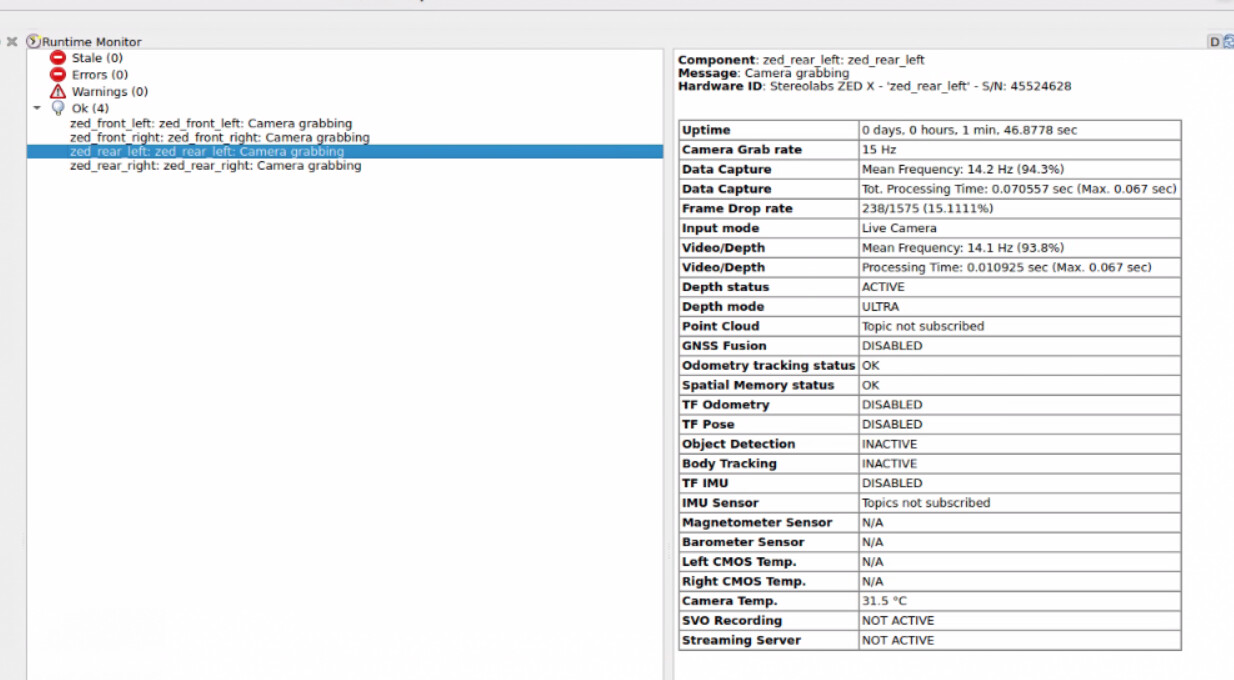

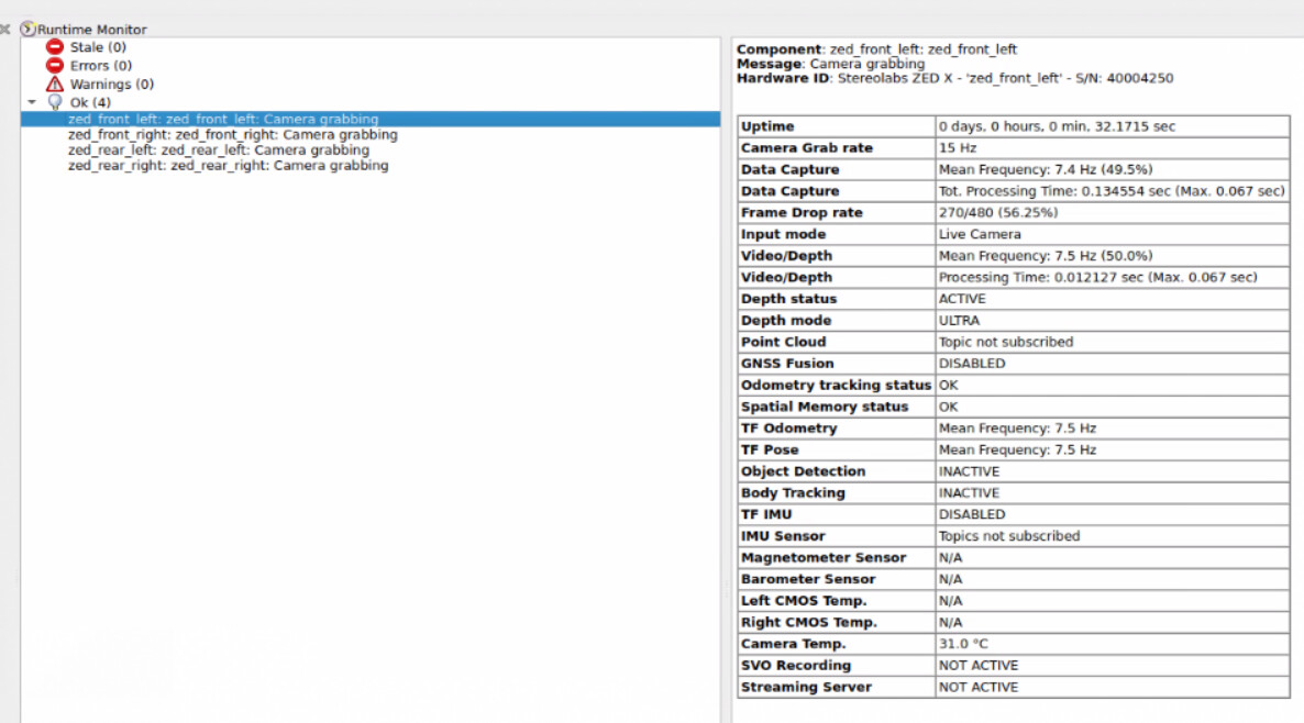

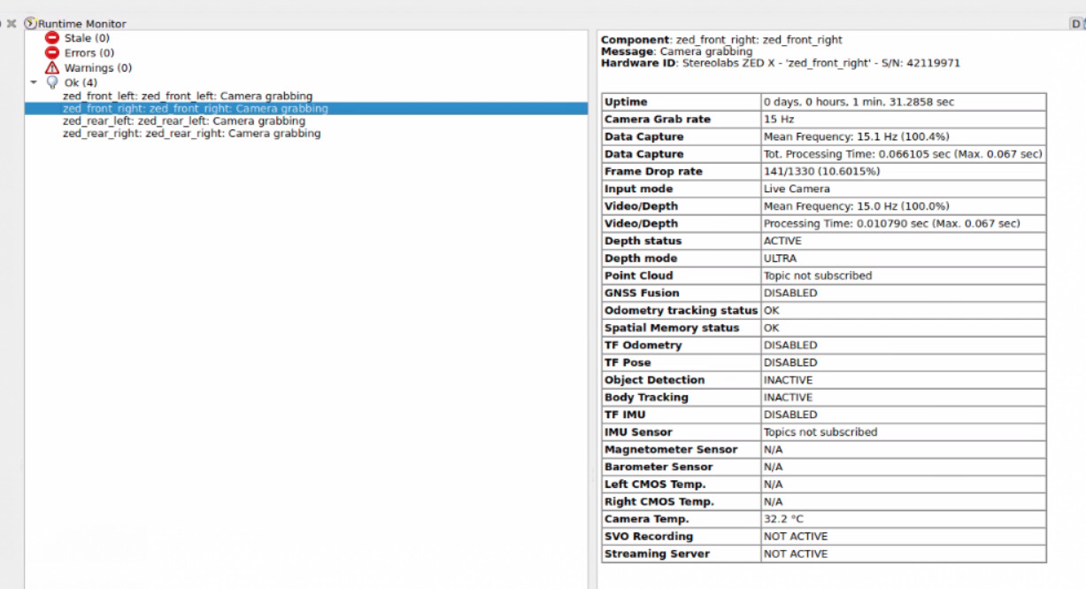

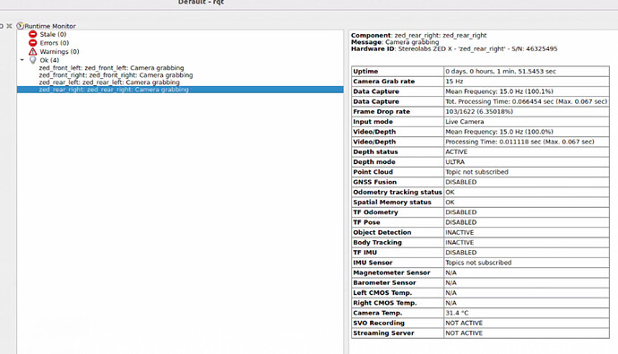

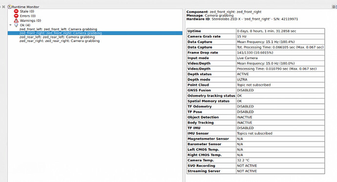

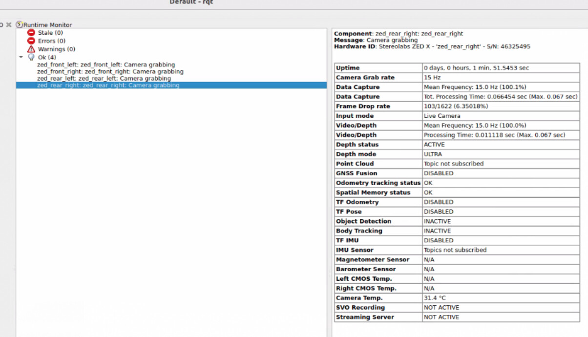

You can monitor the running frequencies of all the ZED ROS2 Node modules (threads) by using the rqt diagnostic plugin.
The ZED ROS2 Wrapper publishes full diagnostic information.
Read more here.
Nothing more than what’s explained here.

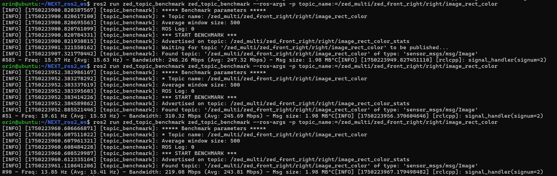

I also recommend not using compressed topics if not sending messages over the network.
I’ve tested it with the uncompressed images, but the publishing frequency looks even worse…
[INFO] [1750172476.430788040] [frequency_tracker]: Subscribed to 8 topics
[INFO] [1750172476.573832946] [frequency_tracker]: [/zed_multi/zed_rear_left/left/image_rect_color]: Δt = 0.1334 s → ~7.50 Hz
[INFO] [1750172476.584124055] [frequency_tracker]: [/zed_multi/zed_rear_left/right/image_rect_color]: Δt = 0.1334 s → ~7.50 Hz
[INFO] [1750172476.589326934] [frequency_tracker]: [/zed_multi/zed_front_left/left/image_rect_color]: Δt = 0.1334 s → ~7.49 Hz
[INFO] [1750172476.599541470] [frequency_tracker]: [/zed_multi/zed_front_left/right/image_rect_color]: Δt = 0.1334 s → ~7.49 Hz
[INFO] [1750172476.618381490] [frequency_tracker]: [/zed_multi/zed_front_right/left/image_rect_color]: Δt = 0.2004 s → ~4.99 Hz
[INFO] [1750172476.627169079] [frequency_tracker]: [/zed_multi/zed_front_right/right/image_rect_color]: Δt = 0.2004 s → ~4.99 Hz
[INFO] [1750172476.650566119] [frequency_tracker]: [/zed_multi/zed_rear_right/left/image_rect_color]: Δt = 0.1330 s → ~7.52 Hz
[INFO] [1750172476.659563555] [frequency_tracker]: [/zed_multi/zed_rear_right/right/image_rect_color]: Δt = 0.1330 s → ~7.52 Hz
[INFO] [1750172476.690707781] [frequency_tracker]: [/zed_multi/zed_rear_left/left/image_rect_color]: Δt = 0.1332 s → ~7.51 Hz
[INFO] [1750172476.700634873] [frequency_tracker]: [/zed_multi/zed_rear_left/right/image_rect_color]: Δt = 0.1332 s → ~7.51 Hz
[INFO] [1750172476.719130779] [frequency_tracker]: [/zed_multi/zed_front_right/left/image_rect_color]: Δt = 0.1330 s → ~7.52 Hz
[INFO] [1750172476.727034727] [frequency_tracker]: [/zed_multi/zed_front_left/left/image_rect_color]: Δt = 0.0665 s → ~15.03 Hz
[INFO] [1750172476.732059246] [frequency_tracker]: [/zed_multi/zed_front_right/right/image_rect_color]: Δt = 0.1330 s → ~7.52 Hz
[INFO] [1750172476.746748437] [frequency_tracker]: [/zed_multi/zed_front_left/right/image_rect_color]: Δt = 0.0665 s → ~15.03 Hz
[INFO] [1750172476.789282796] [frequency_tracker]: [/zed_multi/zed_rear_right/left/image_rect_color]: Δt = 0.1337 s → ~7.48 Hz
[INFO] [1750172476.798115023] [frequency_tracker]: [/zed_multi/zed_rear_right/right/image_rect_color]: Δt = 0.1337 s → ~7.48 Hz
[INFO] [1750172476.809069431] [frequency_tracker]: [/zed_multi/zed_front_left/left/image_rect_color]: Δt = 0.1335 s → ~7.49 Hz
[INFO] [1750172476.822787240] [frequency_tracker]: [/zed_multi/zed_front_left/right/image_rect_color]: Δt = 0.1335 s → ~7.49 Hz
[INFO] [1750172476.827528475] [frequency_tracker]: [/zed_multi/zed_rear_left/left/image_rect_color]: Δt = 0.1334 s → ~7.49 Hz
[INFO] [1750172476.845958113] [frequency_tracker]: [/zed_multi/zed_rear_left/right/image_rect_color]: Δt = 0.1334 s → ~7.49 Hz
[INFO] [1750172476.855337581] [frequency_tracker]: [/zed_multi/zed_front_right/left/image_rect_color]: Δt = 0.0667 s → ~14.99 Hz
[INFO] [1750172476.859841226] [frequency_tracker]: [/zed_multi/zed_front_right/right/image_rect_color]: Δt = 0.0667 s → ~14.99 Hz
[INFO] [1750172476.934006510] [frequency_tracker]: [/zed_multi/zed_front_right/left/image_rect_color]: Δt = 0.1333 s → ~7.50 Hz
[INFO] [1750172476.948152748] [frequency_tracker]: [/zed_multi/zed_front_left/left/image_rect_color]: Δt = 0.1333 s → ~7.50 Hz
[INFO] [1750172476.952971100] [frequency_tracker]: [/zed_multi/zed_front_right/right/image_rect_color]: Δt = 0.1333 s → ~7.50 Hz
[INFO] [1750172476.957709680] [frequency_tracker]: [/zed_multi/zed_rear_right/left/image_rect_color]: Δt = 0.1333 s → ~7.50 Hz
[INFO] [1750172476.962724120] [frequency_tracker]: [/zed_multi/zed_front_left/right/image_rect_color]: Δt = 0.1333 s → ~7.50 Hz
[INFO] [1750172476.970242132] [frequency_tracker]: [/zed_multi/zed_rear_right/right/image_rect_color]: Δt = 0.1333 s → ~7.50 Hz
[INFO] [1750172476.975735847] [frequency_tracker]: [/zed_multi/zed_rear_left/left/image_rect_color]: Δt = 0.1335 s → ~7.49 Hz
[INFO] [1750172476.985298059] [frequency_tracker]: [/zed_multi/zed_rear_left/right/image_rect_color]: Δt = 0.1335 s → ~7.49 Hz
[INFO] [1750172477.042263797] [frequency_tracker]: [/zed_multi/zed_front_right/left/image_rect_color]: Δt = 0.0666 s → ~15.01 Hz
[INFO] [1750172477.051292176] [frequency_tracker]: [/zed_multi/zed_rear_right/left/image_rect_color]: Δt = 0.1333 s → ~7.50 Hz
[INFO] [1750172477.069106833] [frequency_tracker]: [/zed_multi/zed_front_right/right/image_rect_color]: Δt = 0.0666 s → ~15.01 Hz
[INFO] [1750172477.074932438] [frequency_tracker]: [/zed_multi/zed_rear_right/right/image_rect_color]: Δt = 0.1333 s → ~7.50 Hz
[INFO] [1750172477.089831733] [frequency_tracker]: [/zed_multi/zed_rear_left/left/image_rect_color]: Δt = 0.1331 s → ~7.51 Hz
[INFO] [1750172477.098901806] [frequency_tracker]: [/zed_multi/zed_rear_left/right/image_rect_color]: Δt = 0.1331 s → ~7.51 Hz
[INFO] [1750172477.124878159] [frequency_tracker]: [/zed_multi/zed_front_left/left/image_rect_color]: Δt = 0.0667 s → ~15.00 Hz
[INFO] [1750172477.131699082] [frequency_tracker]: [/zed_multi/zed_front_left/right/image_rect_color]: Δt = 0.0667 s → ~15.00 Hz
[INFO] [1750172477.142056844] [frequency_tracker]: [/zed_multi/zed_front_right/left/image_rect_color]: Δt = 0.1334 s → ~7.50 Hz
[INFO] [1750172477.157079909] [frequency_tracker]: [/zed_multi/zed_front_right/right/image_rect_color]: Δt = 0.1334 s → ~7.50 Hz
[INFO] [1750172477.172135484] [frequency_tracker]: [/zed_multi/zed_rear_right/left/image_rect_color]: Δt = 0.1357 s → ~7.37 Hz
[INFO] [1750172477.211501053] [frequency_tracker]: [/zed_multi/zed_rear_left/left/image_rect_color]: Δt = 0.1335 s → ~7.49 Hz
[INFO] [1750172477.217056494] [frequency_tracker]: [/zed_multi/zed_rear_right/right/image_rect_color]: Δt = 0.1357 s → ~7.37 Hz
[INFO] [1750172477.235026024] [frequency_tracker]: [/zed_multi/zed_rear_left/right/image_rect_color]: Δt = 0.1335 s → ~7.49 Hz
[INFO] [1750172477.247486159] [frequency_tracker]: [/zed_multi/zed_front_right/left/image_rect_color]: Δt = 0.1333 s → ~7.50 Hz
[INFO] [1750172477.255441209] [frequency_tracker]: [/zed_multi/zed_front_right/right/image_rect_color]: Δt = 0.1333 s → ~7.50 Hz
[INFO] [1750172477.279081375] [frequency_tracker]: [/zed_multi/zed_front_left/left/image_rect_color]: Δt = 0.2000 s → ~5.00 Hz
[INFO] [1750172477.289083216] [frequency_tracker]: [/zed_multi/zed_front_left/right/image_rect_color]: Δt = 0.2000 s → ~5.00 Hz
[INFO] [1750172477.302864926] [frequency_tracker]: [/zed_multi/zed_rear_right/left/image_rect_color]: Δt = 0.1971 s → ~5.07 Hz
[INFO] [1750172477.313770281] [frequency_tracker]: [/zed_multi/zed_rear_right/right/image_rect_color]: Δt = 0.1971 s → ~5.07 Hz
[INFO] [1750172477.358168081] [frequency_tracker]: [/zed_multi/zed_rear_left/left/image_rect_color]: Δt = 0.1330 s → ~7.52 Hz
[INFO] [1750172477.363752256] [frequency_tracker]: [/zed_multi/zed_front_right/left/image_rect_color]: Δt = 0.0662 s → ~15.12 Hz
[INFO] [1750172477.369565094] [frequency_tracker]: [/zed_multi/zed_rear_left/right/image_rect_color]: Δt = 0.1330 s → ~7.52 Hz
[INFO] [1750172477.375942995] [frequency_tracker]: [/zed_multi/zed_front_right/right/image_rect_color]: Δt = 0.0662 s → ~15.12 Hz
[INFO] [1750172477.387415397] [frequency_tracker]: [/zed_multi/zed_front_left/left/image_rect_color]: Δt = 0.2004 s → ~4.99 Hz
[INFO] [1750172477.406820226] [frequency_tracker]: [/zed_multi/zed_front_left/right/image_rect_color]: Δt = 0.2004 s → ~4.99 Hz
[INFO] [1750172477.422895917] [frequency_tracker]: [/zed_multi/zed_rear_right/left/image_rect_color]: Δt = 0.0666 s → ~15.02 Hz
[INFO] [1750172477.430560675] [frequency_tracker]: [/zed_multi/zed_rear_right/right/image_rect_color]: Δt = 0.0666 s → ~15.02 Hz
[INFO] [1750172477.479114840] [frequency_tracker]: [/zed_multi/zed_front_right/left/image_rect_color]: Δt = 0.1333 s → ~7.50 Hz
[INFO] [1750172477.486834284] [frequency_tracker]: [/zed_multi/zed_front_right/right/image_rect_color]: Δt = 0.1333 s → ~7.50 Hz
[INFO] [1750172477.503901421] [frequency_tracker]: [/zed_multi/zed_rear_left/left/image_rect_color]: Δt = 0.1333 s → ~7.50 Hz
[INFO] [1750172477.527189378] [frequency_tracker]: [/zed_multi/zed_rear_left/right/image_rect_color]: Δt = 0.1333 s → ~7.50 Hz
[INFO] [1750172477.533273724] [frequency_tracker]: [/zed_multi/zed_front_left/left/image_rect_color]: Δt = 0.0661 s → ~15.13 Hz
[INFO] [1750172477.545484558] [frequency_tracker]: [/zed_multi/zed_front_left/right/image_rect_color]: Δt = 0.0661 s → ~15.13 Hz
[INFO] [1750172477.550526325] [frequency_tracker]: [/zed_multi/zed_rear_right/left/image_rect_color]: Δt = 0.1337 s → ~7.48 Hz
[INFO] [1750172477.561743954] [frequency_tracker]: [/zed_multi/zed_rear_right/right/image_rect_color]: Δt = 0.1337 s → ~7.48 Hz
[INFO] [1750172477.638835450] [frequency_tracker]: [/zed_multi/zed_front_right/left/image_rect_color]: Δt = 0.0665 s → ~15.05 Hz
[INFO] [1750172477.645281732] [frequency_tracker]: [/zed_multi/zed_front_right/right/image_rect_color]: Δt = 0.0665 s → ~15.05 Hz
[INFO] [1750172477.657112711] [frequency_tracker]: [/zed_multi/zed_rear_left/left/image_rect_color]: Δt = 0.1334 s → ~7.50 Hz
[INFO] [1750172477.663783080] [frequency_tracker]: [/zed_multi/zed_rear_right/left/image_rect_color]: Δt = 0.1333 s → ~7.50 Hz
[INFO] [1750172477.670082456] [frequency_tracker]: [/zed_multi/zed_front_left/left/image_rect_color]: Δt = 0.1338 s → ~7.48 Hz
[INFO] [1750172477.674899945] [frequency_tracker]: [/zed_multi/zed_rear_left/right/image_rect_color]: Δt = 0.1334 s → ~7.50 Hz
[INFO] [1750172477.680580692] [frequency_tracker]: [/zed_multi/zed_front_left/right/image_rect_color]: Δt = 0.1338 s → ~7.48 Hz
[INFO] [1750172477.685658777] [frequency_tracker]: [/zed_multi/zed_rear_right/right/image_rect_color]: Δt = 0.1333 s → ~7.50 Hz
[INFO] [1750172477.759661607] [frequency_tracker]: [/zed_multi/zed_front_right/left/image_rect_color]: Δt = 0.2001 s → ~5.00 Hz
[INFO] [1750172477.772759795] [frequency_tracker]: [/zed_multi/zed_front_right/right/image_rect_color]: Δt = 0.2001 s → ~5.00 Hz
[INFO] [1750172477.789073876] [frequency_tracker]: [/zed_multi/zed_front_left/left/image_rect_color]: Δt = 0.1337 s → ~7.48 Hz
[INFO] [1750172477.799244542] [frequency_tracker]: [/zed_multi/zed_rear_left/left/image_rect_color]: Δt = 0.1333 s → ~7.50 Hz
[INFO] [1750172477.804879915] [frequency_tracker]: [/zed_multi/zed_rear_right/left/image_rect_color]: Δt = 0.0668 s → ~14.97 Hz
[INFO] [1750172477.814410609] [frequency_tracker]: [/zed_multi/zed_front_left/right/image_rect_color]: Δt = 0.1337 s → ~7.48 Hz
[INFO] [1750172477.819275839] [frequency_tracker]: [/zed_multi/zed_rear_left/right/image_rect_color]: Δt = 0.1333 s → ~7.50 Hz
[INFO] [1750172477.824928236] [frequency_tracker]: [/zed_multi/zed_rear_right/right/image_rect_color]: Δt = 0.0668 s → ~14.97 Hz
[INFO] [1750172477.906137955] [frequency_tracker]: [/zed_multi/zed_front_left/left/image_rect_color]: Δt = 0.1324 s → ~7.55 Hz
[INFO] [1750172477.921262263] [frequency_tracker]: [/zed_multi/zed_front_left/right/image_rect_color]: Δt = 0.1324 s → ~7.55 Hz
[INFO] [1750172477.927340754] [frequency_tracker]: [/zed_multi/zed_rear_right/left/image_rect_color]: Δt = 0.1331 s → ~7.51 Hz
[INFO] [1750172477.933305201] [frequency_tracker]: [/zed_multi/zed_rear_right/right/image_rect_color]: Δt = 0.1331 s → ~7.51 Hz
[INFO] [1750172477.959794044] [frequency_tracker]: [/zed_multi/zed_rear_left/left/image_rect_color]: Δt = 0.1333 s → ~7.50 Hz
[INFO] [1750172477.964553135] [frequency_tracker]: [/zed_multi/zed_front_right/left/image_rect_color]: Δt = 0.1334 s → ~7.49 Hz
[INFO] [1750172477.993271706] [frequency_tracker]: [/zed_multi/zed_front_right/right/image_rect_color]: Δt = 0.1334 s → ~7.49 Hz
[INFO] [1750172478.004332510] [frequency_tracker]: [/zed_multi/zed_rear_left/right/image_rect_color]: Δt = 0.1333 s → ~7.50 Hz
[INFO] [1750172478.048543760] [frequency_tracker]: [/zed_multi/zed_rear_right/left/image_rect_color]: Δt = 0.1333 s → ~7.50 Hz
[INFO] [1750172478.055768185] [frequency_tracker]: [/zed_multi/zed_front_left/left/image_rect_color]: Δt = 0.1333 s → ~7.50 Hz
[INFO] [1750172478.070756692] [frequency_tracker]: [/zed_multi/zed_front_left/right/image_rect_color]: Δt = 0.1333 s → ~7.50 Hz
[INFO] [1750172478.076059472] [frequency_tracker]: [/zed_multi/zed_rear_right/right/image_rect_color]: Δt = 0.1333 s → ~7.50 Hz
[INFO] [1750172478.094916292] [frequency_tracker]: [/zed_multi/zed_rear_left/left/image_rect_color]: Δt = 0.2667 s → ~3.75 Hz
[INFO] [1750172478.102370212] [frequency_tracker]: [/zed_multi/zed_rear_left/right/image_rect_color]: Δt = 0.2667 s → ~3.75 Hz
[INFO] [1750172478.114366207] [frequency_tracker]: [/zed_multi/zed_front_right/left/image_rect_color]: Δt = 0.1998 s → ~5.00 Hz
[INFO] [1750172478.131047026] [frequency_tracker]: [/zed_multi/zed_front_right/right/image_rect_color]: Δt = 0.1998 s → ~5.00 Hz
[INFO] [1750172478.179135197] [frequency_tracker]: [/zed_multi/zed_rear_right/left/image_rect_color]: Δt = 0.1334 s → ~7.50 Hz
[INFO] [1750172478.197022299] [frequency_tracker]: [/zed_multi/zed_front_left/left/image_rect_color]: Δt = 0.1333 s → ~7.50 Hz
[INFO] [1750172478.223689504] [frequency_tracker]: [/zed_multi/zed_rear_right/right/image_rect_color]: Δt = 0.1334 s → ~7.50 Hz
[INFO] [1750172478.228366710] [frequency_tracker]: [/zed_multi/zed_front_left/right/image_rect_color]: Δt = 0.1333 s → ~7.50 Hz
[INFO] [1750172478.275419182] [frequency_tracker]: [/zed_multi/zed_front_right/left/image_rect_color]: Δt = 0.1334 s → ~7.50 Hz
[INFO] [1750172478.284908406] [frequency_tracker]: [/zed_multi/zed_front_right/right/image_rect_color]: Δt = 0.1334 s → ~7.50 Hz
Here are the informations from rqt:
It is visible that the first camera has many frame drops… But over time the publishing frequency will somehow descreasing over time for all cameras. But the pattern of how fast and which camera will have a decreasing frame rate seems to be random…

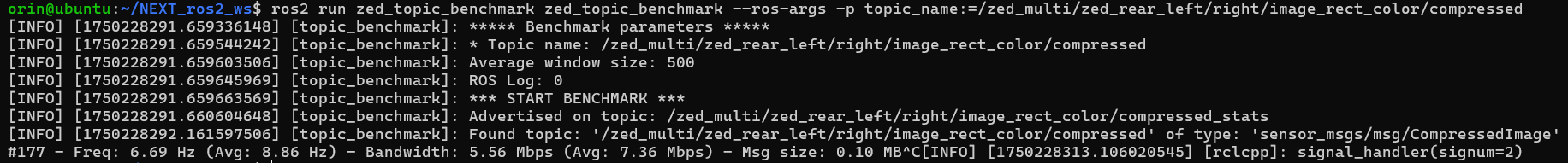

I recommend you perform the same type of tests using our Benchmark package and trying the node composition with IPC to reduce the communication overhead:
I have done the benchmark tests (screen shot below). Our main issue currently is that we can observe using the benchmark test, that there is a jitter of serveral Hz. Is that normal?
Downscale the compressed images by factor 2.0 seems more or less to work (but the frame rate still drops over time - see below), but when we don’t downsample the image the publishing rate drops to about 10 Hz.
Are there other running processes that could explain random jitter?
No, I have tested it with our own launch file, where we start several other nodes, but also running only the ZED-multi node with four cameras the jitter seems to be the same:
