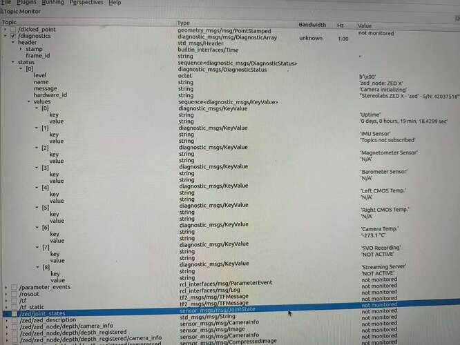

rqt, rviz2, even”ros2 topic echo”, no data was shown up
Please start the node (post the command you use), then open rqt and take a screenshot of the runtime monitor:
ros2 launch zed_wrapper zed_camera.launch.py camera_model:=zedx publish_tf:=false
Please post a screenshot like the one that you can find in the documentation.
In any case, this reports “Camera Initializing”, so the node has not yet started.
Please post the full node log too.

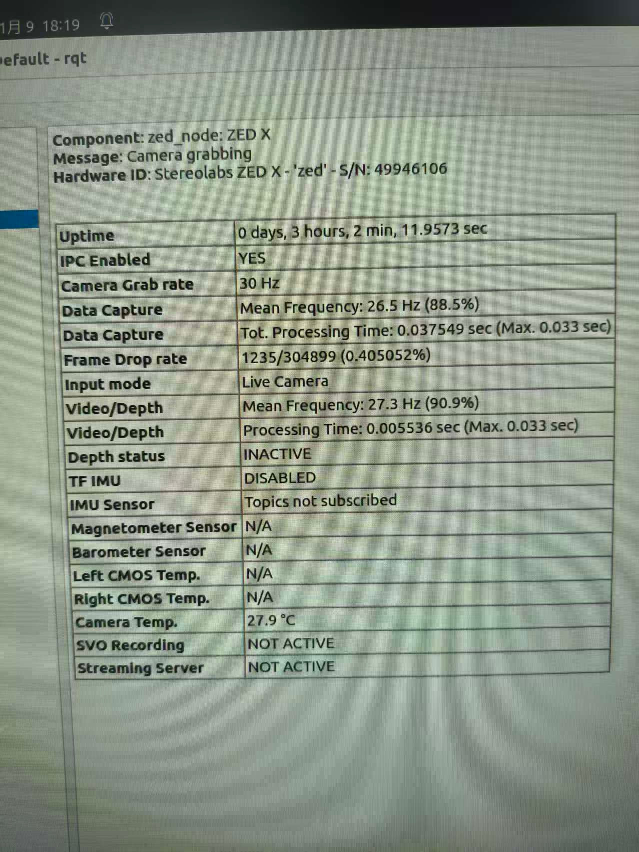

it’s not allowed to upload files, I pasted the last few lines of command line output, there are no errors.
The diagnostic shows that the node is running, but I need the full log to know more.
The new observation is that when a node of mine subscribes to the RGB image and depth map image topics, the feed is visible in RQT. However, when the subscribing node stops running, the feed is no longer visible in RQT either.
This behavior is not expected.
Can you add details regarding your setup?

\[component_container_isolated-2\] \[INFO\] \[1767875681.995278993\] \[zed.zed_node\]: Camera-IMU Translation:
\[component_container_isolated-2\]  0 -0.035649 -0.000147
\[component_container_isolated-2\] \[INFO\] \[1767875681.995349043\] \[zed.zed_node\]: Camera-IMU Rotation:
\[component_container_isolated-2\] FFFF54CFC658
\[component_container_isolated-2\] 0.999983 -0.003611 0.004693
\[component_container_isolated-2\] 0.003624 0.999990 -0.002592
\[component_container_isolated-2\] -0.004684 0.002609 0.999986
\[component_container_isolated-2\] \[INFO\] \[1767875681.995387636\] \[zed.zed_node\]: ===Subscribers ===
\[component_container_isolated-2\] \[INFO\] \[1767875681.996782971\] \[zed.zed_node\]:  \* Plane detection: ‘/clicked_point’
Hi @qiran
I replicated your setup, but not the problem.
The topics are normally published
