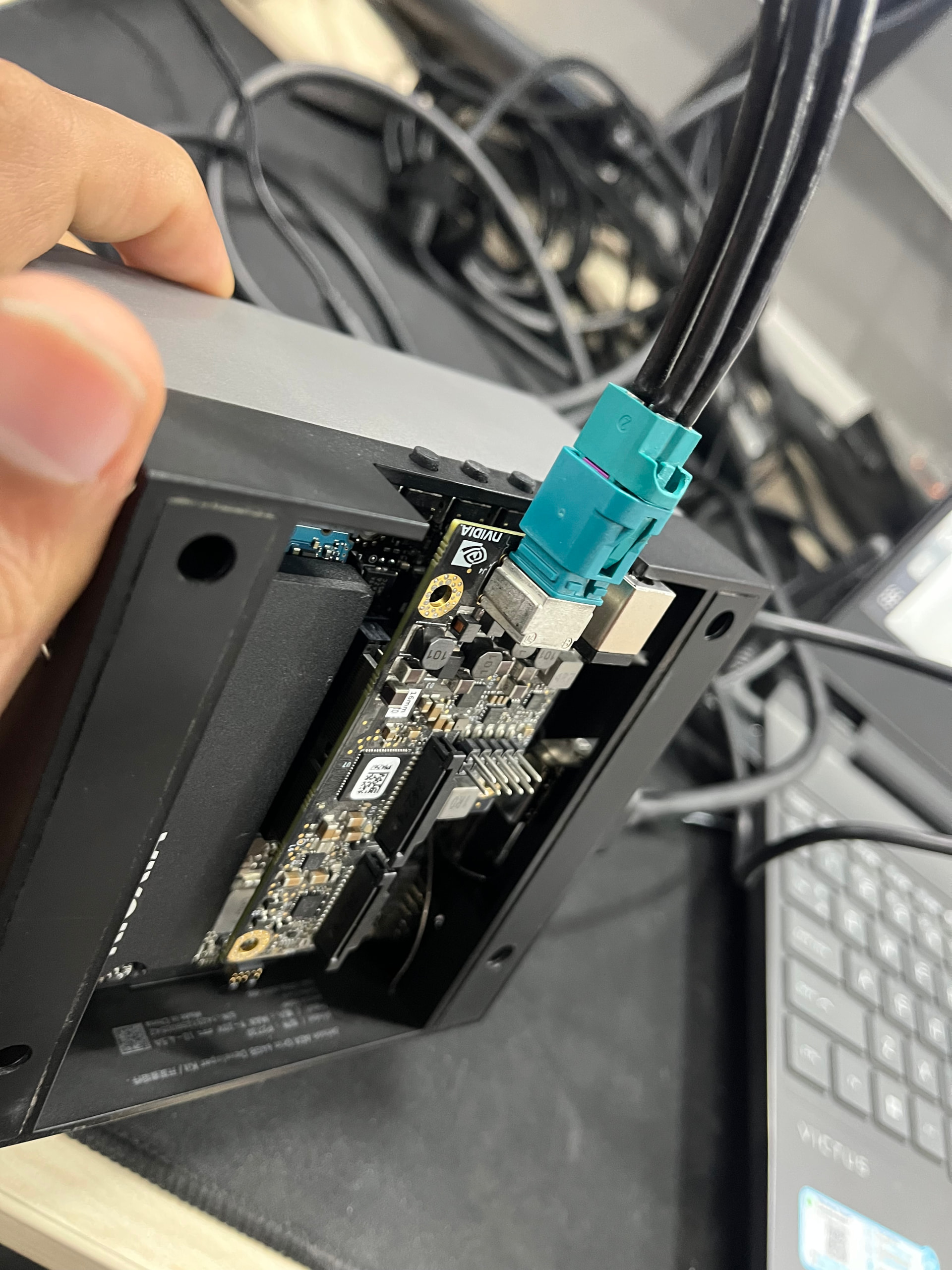

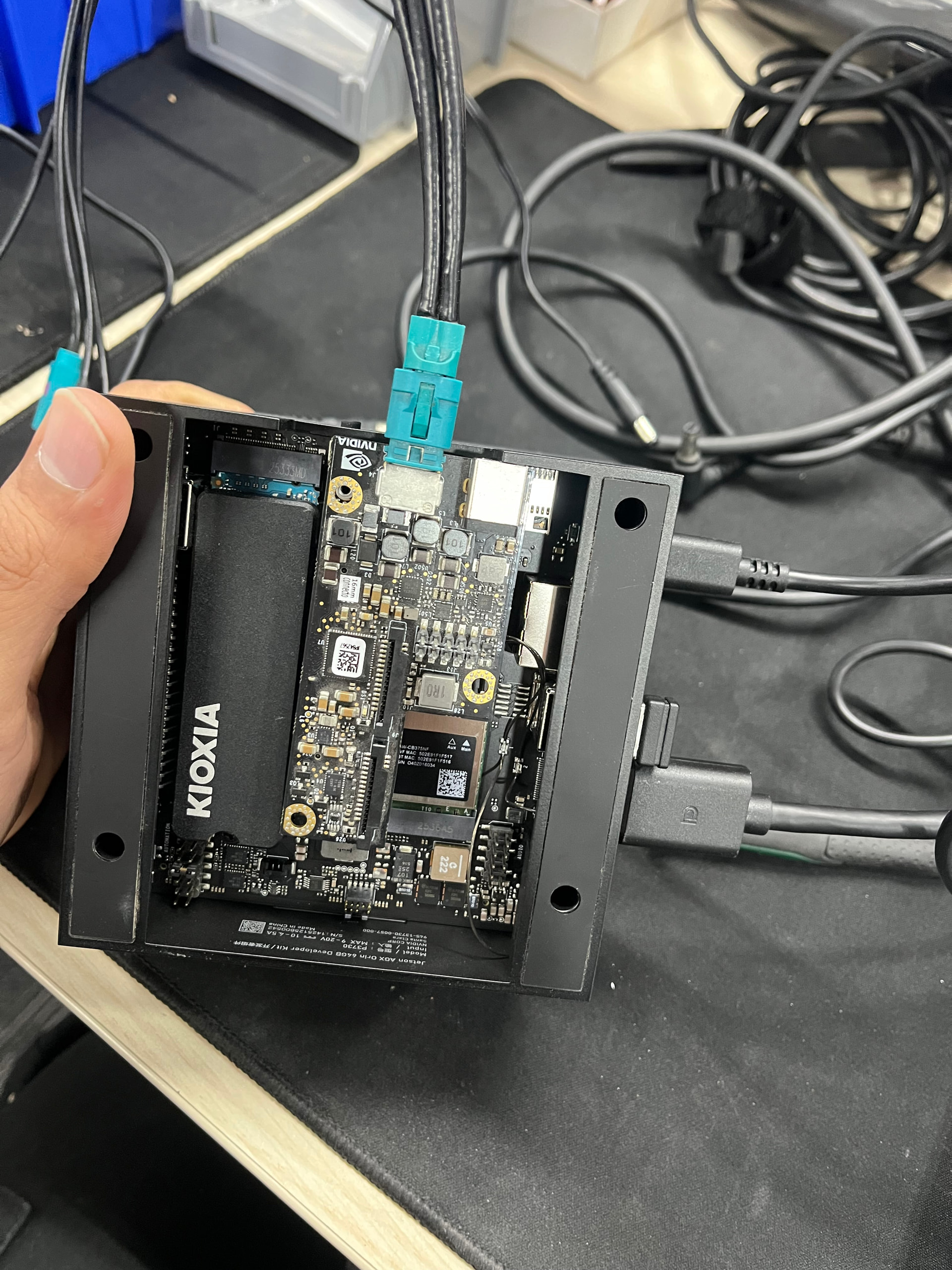

Can you send a picture of the capture card installed on the AGX?
The capture card is clearly not well-connected to the carrier board.

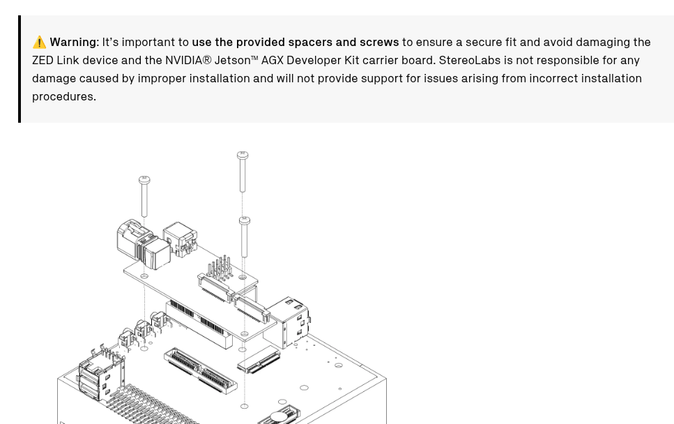

As explained in the documentation, to guarantee a reliable connection and to avoid damage to both the capture card and the carrier board, it’s mandatory to use the spacers and the screws to firmly fix the capture card.
