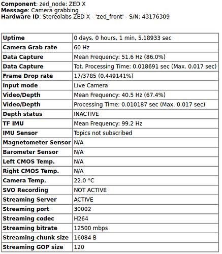

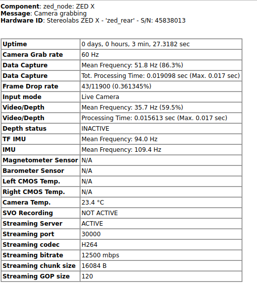

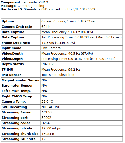

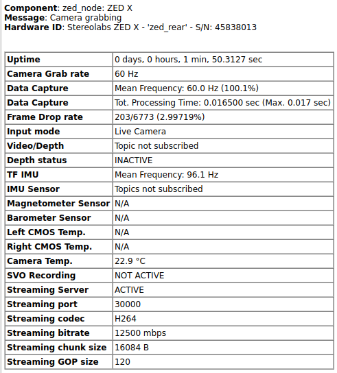

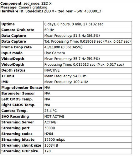

Ok i’ve change the launch files in order to have every single node that need to communicate in the same component container, it augmented the fps but i still have like 45 hz with a downsample_factor of 4 which seems a lot to me,
is this the performance i should wait with a zed_box ?
What’s the depth mode?
I have no Depth activated,
in order to maximise the performance i choose to only use left/right topic everything else is disable
Please share the configuration file of the ZED nodes.

Can you take a screenshot of the node diagnostic in rqt to verify that the depth processing is effectively turned of?
yes here is the diag without vslam:
and there with vslam:
According to this, I can say that the VSLAM processing is taking a lot of host resources.
As you can notice indeed, the Data capture frequency is lowered, and the device cannot keep a stable 60 Hz.
I recommend you consider reducing the resolution for data processing or the grab rate.
yup, whats seems strange to me is that even with only the 2 cameras running and nothing else i got the following result when i do a ros2 topic hz
