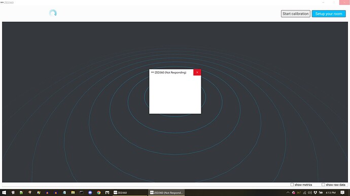

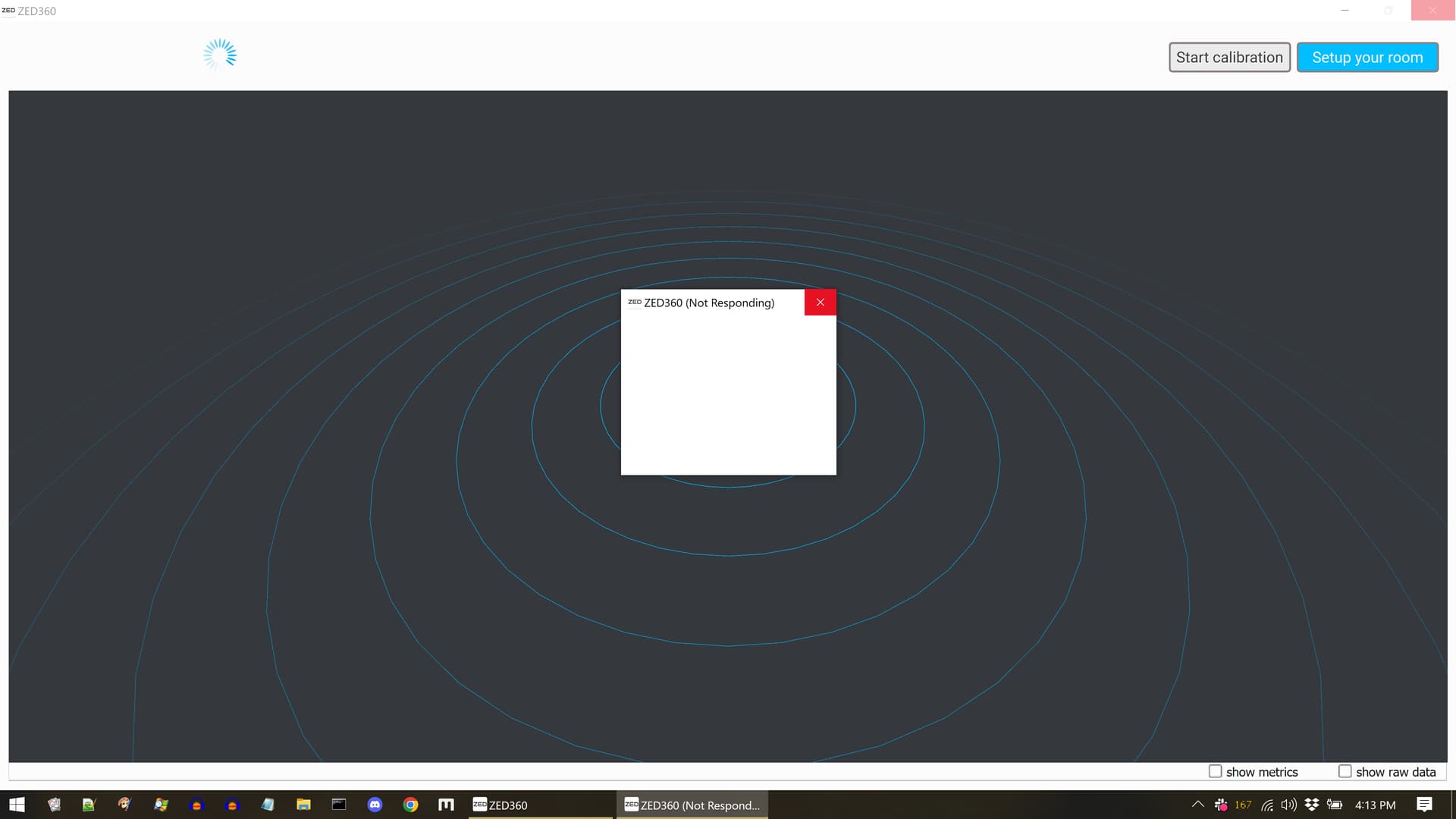

I have two Zed2i’s connected via USB, on a Windows 10 PC. Zed360 detects the cameras. However when I press “Setup the Room” I get a blank dialog and the application stops responding and must be force quit. I let it go for about 10 minutes to see if it would start responding again but it never did:
