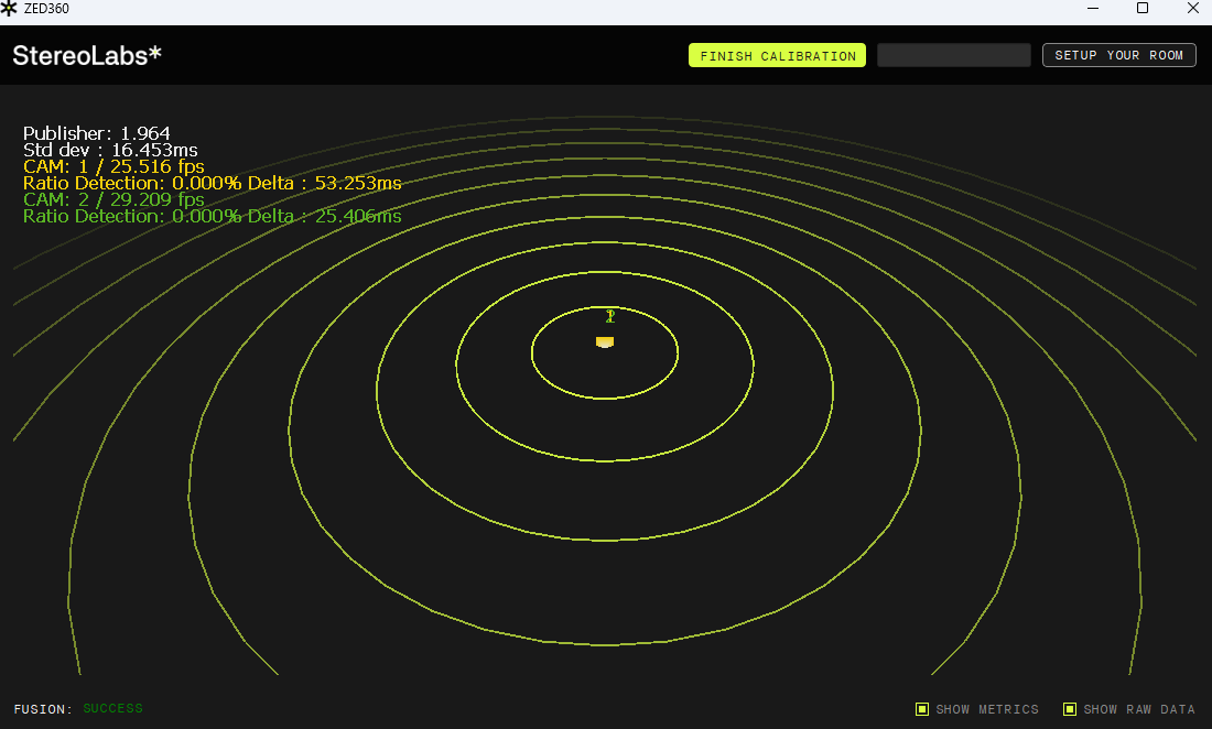

Hi there
Attempting to setup two cameras with 360 fusion.
Two ZED2i with jetsons xavier JETSON_L4T=35.4.1 over the network with SDK 5.1.2 running 360 senders.
Receiver running ZED360 on win 11 SDK 5.1.2 CUDA 13.
Sometimes zed360 just crashes when trying to setup the room. Sometimes it does not and adds both cameras in one spot. See attached image. When in calibration it does not show any bodies detected or moving and calibration saves no data.

Am I missing any crucial parameters on senders? Also is there a log or a way to see zed360 app log to see what is happening?
Last question does zed360 handle time sync of both jetsons or that has to be done as per your documentation Setting Up Multiple 3D Cameras - Stereolabs is this the missing bit in this chain?

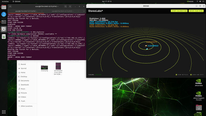

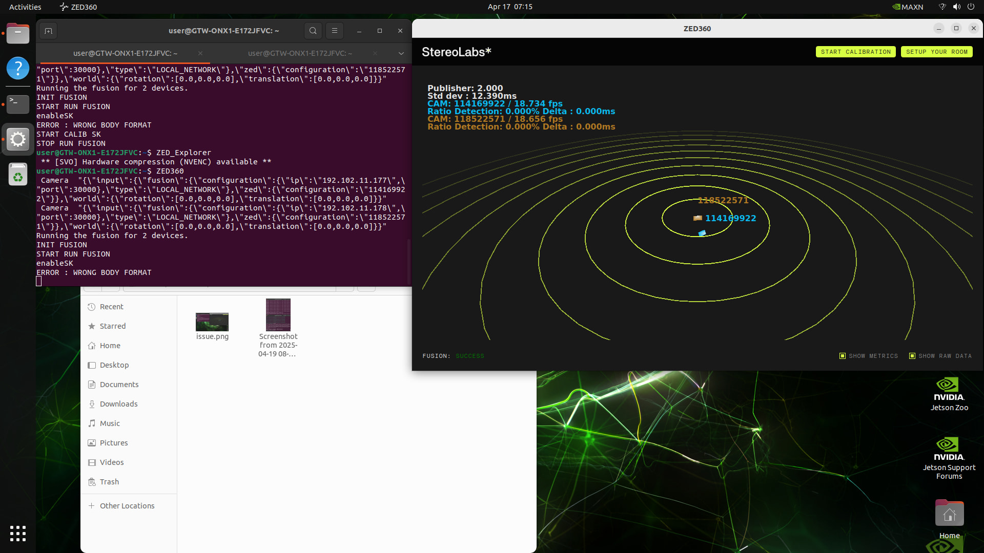

Quick update.
Upgraded to SDK 5.2, on jetsons and PC running ZED360
ZED360 terminal outputs “WRONG BODY FORMAT”
I have tried all combinations on senders .18 .34 .38, also different combinations of BODY_TRACKING_MODEL
On ZED 360 all possible body model combinations.
Both Senders output Adding Receiver with IP: 10.30.20.141 ID 1551339472
This is ZED360 output:
Camera “{“input”:{“fusion”:{“configuration”:{“ip”:“10.30.20.95”,“port”:31950},“type”:“LOCAL_NETWORK”},“zed”:{“configuration”:“1”}},“world”:{“rotation”:[0.0,0.0,0.0],“translation”:[0.0,0.0,0.0]}}”
Camera “{“input”:{“fusion”:{“configuration”:{“ip”:“10.30.20.98”,“port”:31980},“type”:“LOCAL_NETWORK”},“zed”:{“configuration”:“2”}},“world”:{“rotation”:[0.0,0.0,0.0],“translation”:[0.0,0.0,0.0]}}”
Running the fusion for 2 devices.
INIT FUSION
START RUN FUSION
enableSK
ERROR : WRONG BODY FORMAT
STOP RUN FUSION
So still failing to get skeletons on ZED360, any clue to why this workflow not working for us?
This error appears when both senders are using different formats.
I doubt that’s what’s happening here, but can you double check this is not the case?
If not, I’ll try to reproduce your issue at the office.
Best,

Hi, adding a third reproduction of this bug so it doesn’t look like a one-off. Same ERROR : WRONG BODY FORMAT in ZED360 as @Hedgehog and @ZavierL, with identical body formats on both senders.
Machine and camera setup
Two publisher hosts, each a ZED Box Orin NX running JetPack 6.0, on the same LAN as the receiver.
  • Publisher A: two ZED X One monos used as a virtual stereo rig. Using the new SDK for local virtual cam setup without streaming.
  • Publisher B: same rig type, same Python sender code.
  • Receiver: separate host on the same LAN, running ZED360 on Linux and, for cross-checking, a minimal Python sl.Fusion subscriber.
