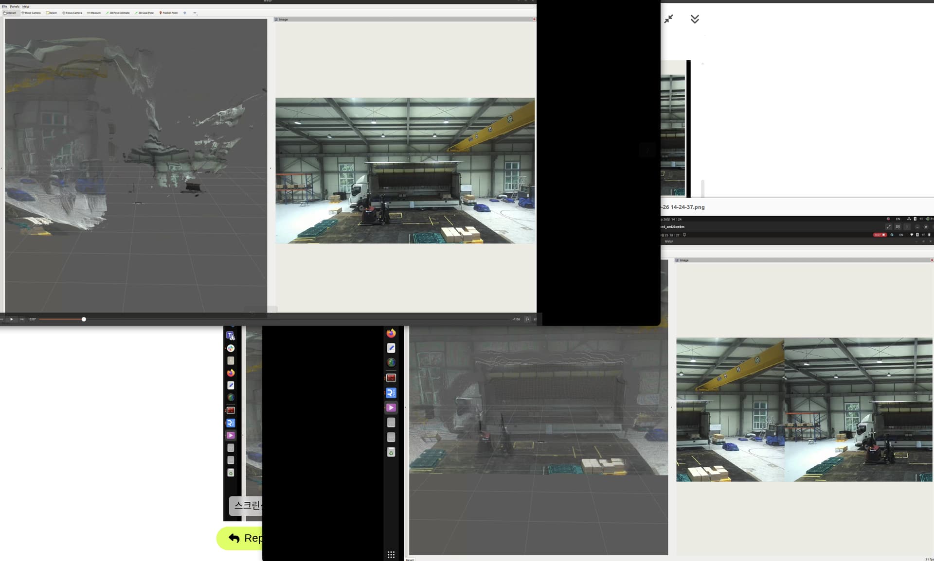

Hello.
I have a question about the ZED2i data flip intermittently when i used ROS2 package of ZED2i in GitHub and my recognize program.
And my program is using YOLO-v11 for detecting some of the object.
When running ZED2i using ROS2 package without my recognize program, ZED2i data is not flip.
But running with my program, ZED2i data is flip intermittently…
I didn’t touch anything when ZED2i running with my program.
Then, I was check ZED2i raw data and subscribed ZED2i data in my program.
As a result, ZED2i raw data was flipped when i checked.
I don’t know why raw data was flipped.
Somebody please help me about in this happening…

Hi, Myzhar.
I wanted to upload a recorded video or some of picture about this issue, but I can’t since I’m a new user. haha
So I attached a replacement image instead of the video.

Hi @NGS
The problem that you reported is a typical case of frame tearing that different factors can cause:
The host is overloaded, so the USB 3 controller buffer is not flushed in time, causing overflows.
The USB 3 connection is not stable
USB 3 connection instability can be caused by:
A damaged USB 3 cable
USB 3 extenders
USB 3 hubs
Unstable USB 3 port
Cable placed close to the power cables of other devices
other factors
Please verify that none of the factors listed above are affecting your setup.
