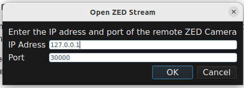

I tried ZED_Explorer but nothing is being streamed there, either. These are the logs of sender and receiver:
Sender:
nvidia@r3001:~$ ZED_Explorer
 ** [SVO] Hardware compression (NVENC) available **
[Streaming] Use Transport layer mode : 0
Receiver:
[ZED][Streaming] No SHM-boost topic found for port 30000. Using UDP backend input.
[Streaming] Warning : receiving port 30000 is not available (already used)... switching to port 30002. Retrying...
[Streaming] Warning: Failed to retrieve camera settings from sender
[Streaming] Error: Stream Opening returned TIMEOUT (350)
The video playback in the sender instance runs without any issues while the whole UI of the receiver becomes unresponsive and it just shows “WAITING FOR CAMERA..” at the top.
