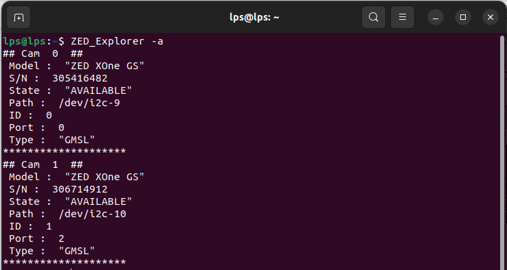

What is the output of the command ZED_Explorer -a?
ZED_Studio and ZED_Explorer are working and open my cameras, in the configuration I can’t use the depth view.

when running ZED_Explorer -a i got this output:
lps@lps:/usr/local/zed/tools$ ZED_Explorer -a
Cam 0
Model : “ZED XOne GS”
S/N : 305416482
State : “AVAILABLE”
Path : /dev/i2c-9
Port : 0
Type : “GMSL”
Cam 1
S/N : 306714912
State : “AVAILABLE”
Path : /dev/i2c-10
Port : 2
Type : “GMSL”

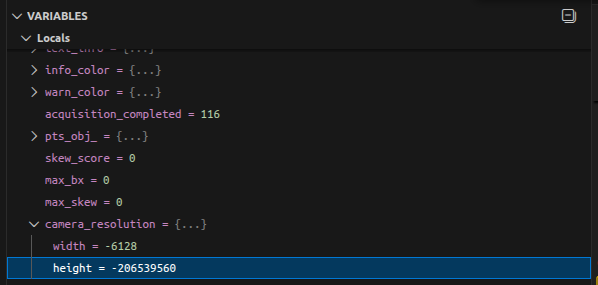

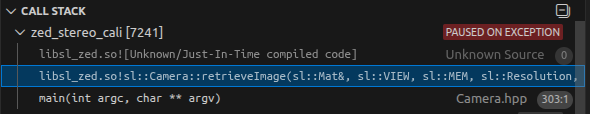

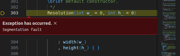

It’s not possible to understand the cause of the crash without information.
Have you tried to debug the code to understand at what line the crash happens?
What’s the output of the command ZED_Explorer -a?
