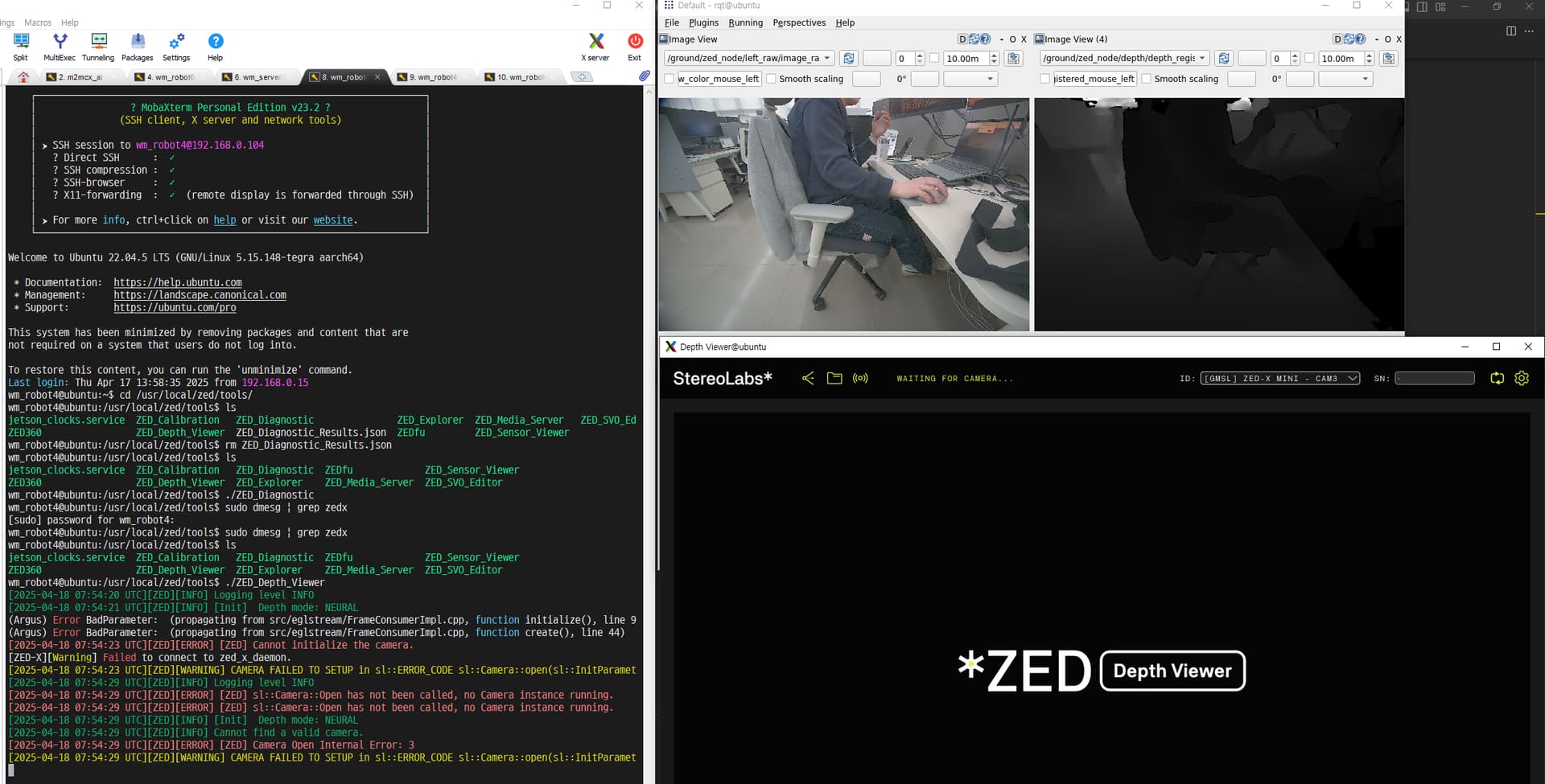

According to your answer, ZED_Depth_Viewer and ZED_Explorer should work if the camera is working properly. I ran the camera with zed_wrapper first and saw that raw_image and depth_image are coming out, and ZED_Explorer is working relatively well, but ZED_Depth_Viewer is not working properly.
I’ll attach related images. Is everything okay with the camera?

You cannot open the camera in different applications simultaneously.
If the ROS Wrapper opened the camera, ZED Depth Viewer cannot see it as available.
