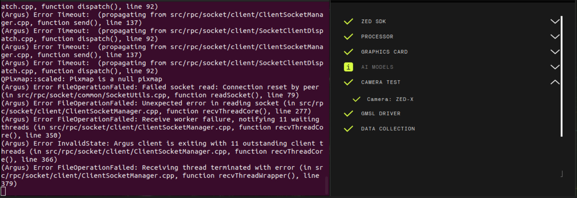

I’m trying to work with my setup of Zed X with a GMSL board (ZED Link Capture Card Mono) connected to a Jetson Orin Nano Devkit. I’m facing the dreaded Argus Timeout error, but it does not seem consistent. Sometimes, the tools included with the SDK work fine, sometimes they stop working after some time passes, and sometimes they immediately crash with:
(Argus) Error Timeout:  (propagating from src/rpc/socket/client/ClientSocketManager.cpp, function send(), line 137)
(Argus) Error Timeout:  (propagating from src/rpc/socket/client/SocketClientDispatch.cpp, function dispatch(), line 91)
or
[2025-11-18 12:42:50 UTC][ZED][INFO] Logging level INFO
[2025-11-18 12:42:51 UTC][ZED][INFO] Using GMSL input... Switched to default resolution HD1200
[2025-11-18 12:42:52 UTC][ZED][INFO] [Init]  Camera FW version: 2001
[2025-11-18 12:42:52 UTC][ZED][INFO] [Init]  Video mode: HD1200@30
[2025-11-18 12:42:52 UTC][ZED][INFO] [Init]  Serial Number: S/N 41165475
[2025-11-18 12:42:52 UTC][ZED][INFO] [Init]  Depth mode: NEURAL LIGHT
(Argus) Error Timeout:  (propagating from src/rpc/socket/client/SocketClientDispatch.cpp, function dispatch(), line 92)
[2025-11-18 12:43:22 UTC][ZED][ERROR] [Init]  Corrupted frames detected. Check that your camera is connected properly.
[2025-11-18 12:43:26 UTC][ZED][ERROR] FAILURE in sl::ERROR_CODE sl::Camera::open(sl::InitParameters)
The same goes for the diagnostic tool - the diagnostic sometimes passes saying that everything should be working fine, when the camera is clearly not initialized, or right as Argus is throwing socket reading errors:
So far I have tried downgrading JetPack and L4T, different versions of SDK and driver, but this behavior remains consistently inconsistent.
At one point I managed to get far enough by restarting nvargus and zed_x daemons, but when I actually tried to do something with the output itself - by running the ros2 wrapper, it seemed to work, before hanging on ‘CAMERA REBOOTING’ (it didn’t). I was following this tutorial: Setting up Isaac™ ROS to work with ZED Cameras in ROS 2 - Stereolabs
My general assumptions/questions are:
  • Can this be caused by software incompatibilities? Something like a patch version difference in L4T and SDK requirements? Incorrectly installed drivers? The checks pass both during installation and diagnostics though.
  • Can this be a hardware issue? I’m not very experienced at tinkering with Jetson hardware, but I did follow the tutorials provided by NVIDIA. Jetson is set to MAXN SUPER mode and should be configured correctly.
I’m also including a diagnostics report:
https://drive.google.com/file/d/1waM2qc8j8K1lbXiv93SyQI65FKdkqUkC/view?usp=sharing
Any idea what could I be doing wrong? Thanks.

[component_container_isolated-2] [2025-11-18 17:31:49 UTC][ZED][INFO] Logging level INFO
[component_container_isolated-2] [ZED-X][Warning] Failed to connect to zed_x_daemon.
[component_container_isolated-2] [2025-11-18 17:31:51 UTC][ZED][INFO] [Init]  Camera FW version: 2001
[component_container_isolated-2] [2025-11-18 17:31:51 UTC][ZED][INFO] [Init]  Video mode: SVGA@30
[component_container_isolated-2] [2025-11-18 17:31:51 UTC][ZED][INFO] [Init]  Serial Number: S/N 41165475
[component_container_isolated-2] [2025-11-18 17:31:51 UTC][ZED][INFO] [Init]  Depth mode: NEURAL LIGHT
[component_container_isolated-2] (Argus) Error Timeout:  (propagating from src/rpc/socket/client/ClientSocketManager.cpp, function send(), line 137)
[component_container_isolated-2] (Argus) Error Timeout:  (propagating from src/rpc/socket/client/SocketClientDispatch.cpp, function dispatch(), line 92)
[component_container_isolated-2] [2025-11-18 17:32:21 UTC][ZED][ERROR] [Init]  Corrupted frames detected. Check that your camera is connected properly.
[component_container_isolated-2] [2025-11-18 17:32:25 UTC][ZED][ERROR] FAILURE in sl::ERROR_CODE sl::Camera::open(sl::InitParameters)
[component_container_isolated-2] [WARN] [1763479945.396327428] [zed.zed_node]: Error opening camera: FAILURE
[component_container_isolated-2] [INFO] [1763479945.396459273] [zed.zed_node]: Please verify the camera connection
[component_container_isolated-2] [ERROR] [1763479945.396531852] [zed.zed_node]: Camera detection timeout
Sadly, didn’t seem to help much.
I seem to be doing something really wrong, I guess.
In the meantime, I will reassemble my entire setup and replace the ribbon cable.
Thank you for your help so far.
Please check again all the connections because it seem a connection stability issue.
Do not unplug/replug cables and camera when the device is on, always remove the power before.
Hello.
Getting back to you, I can now confirm that this is not a physical connection issue. I have checked all the connections and replaced the ribbon cable, but nothing changes - sometimes everything works fine, sometimes it doesn’t.
What else should I look into?
Thank you for your time.
I’m sorry, but this confirms a connection issue.
If the card were damaged, it would never work.
Have you tried replacing the ribbon cables with new, shorter ones?
Hello.
I finally had some time to return to this project, so I investigated.
Replacing the ribbon cable with shorter or longer ones had no noticeable effect.
Downgrading to older versions of SDK or JetPack also didn’t do much. I tried the fix offered by someone on this forum, which was to downgrade all the way to SDK 4.2.2, but on Jetson Orin Nano I ran into a lot of compatibility issues.
I also found seemingly nothing wrong with the capture card.
My team suspects the GMSL cable, because the stability of this setup seems to be affected by the cable positioning, folding, etc,
While the replacement card and the replacement cable are on the way, just in case, is there anything I should look into in the meantime?
Thank you.
This is a possible cause of the problem. Do you have electronic tools to check that the cable can correctly transmit data?
Checked in with the tech, I’m being told that we do not have the tools to check the data transfer quality for this particular case. Anything else I could do?
I recommend you replace the cable.
According to what you described, you damaged it in some way.
GMSL2 cables are not designed to be bent at very sharp angles. Is this the case?
