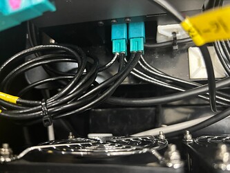

Please send me a picture showing the GMSL2 cable connections.

Hi @Myzhar
Here is GMSL2 cable pictures & dmesg.log in my jetson.
