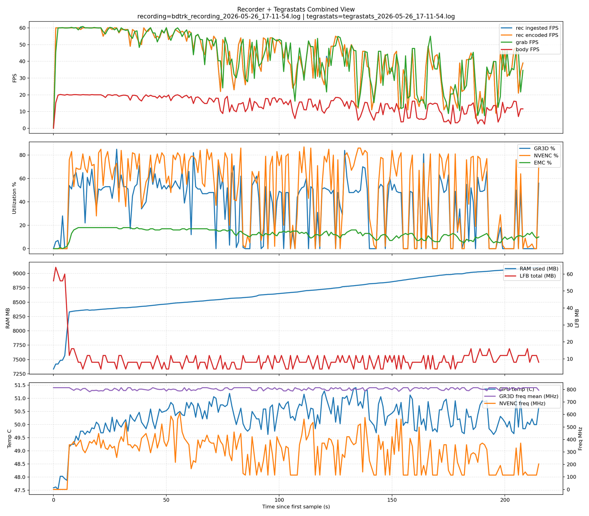

Actual Behavior with SDK 5.3.0
With SDK 5.3.0:
  • Recording starts near 60 FPS
  • grab FPS also starts near 60 FPS
  • body FPS is around 20 FPS after throttling
  • After some time, both recording and grab FPS become unstable and drop
  • rec ingested FPS and rec encoded FPS drop together
Example behavior from logs:
rec ingested FPS: 60 | rec encoded FPS: 60 | grab FPS: 60 | body FPS: 20
at the beginning, then later:
rec ingested FPS: 40~50 | rec encoded FPS: 40~50 | grab FPS: 40~50 | body FPS: 10~17
and sometimes even lower.
The important point is that:
rec ingested FPS ~= rec encoded FPS
So the bottleneck does not seem to be H265 encoding or disk writing. The slowdown appears to happen before encoding, around grab() / SDK internal processing.

5. tegrastats monitoring
With sudo jetson_clocks enabled:
  • CPU/GPU temperatures remain low, around 50C
  • No obvious thermal throttling
  • CPU clocks are locked
  • GPU/GR3D and NVENC are active but not always saturated
This again suggests the slowdown happens before encoding, likely inside the SDK capture / processing pipeline.

The most important observation is that rec ingested FPS and rec encoded FPS drop together, meaning the encoder is not falling behind. Instead, the recording input rate itself is reduced. This points to upstream SDK pipeline slowdown rather than disk or encoder throughput.

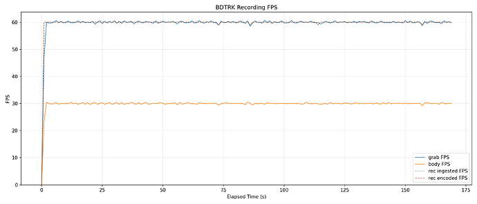

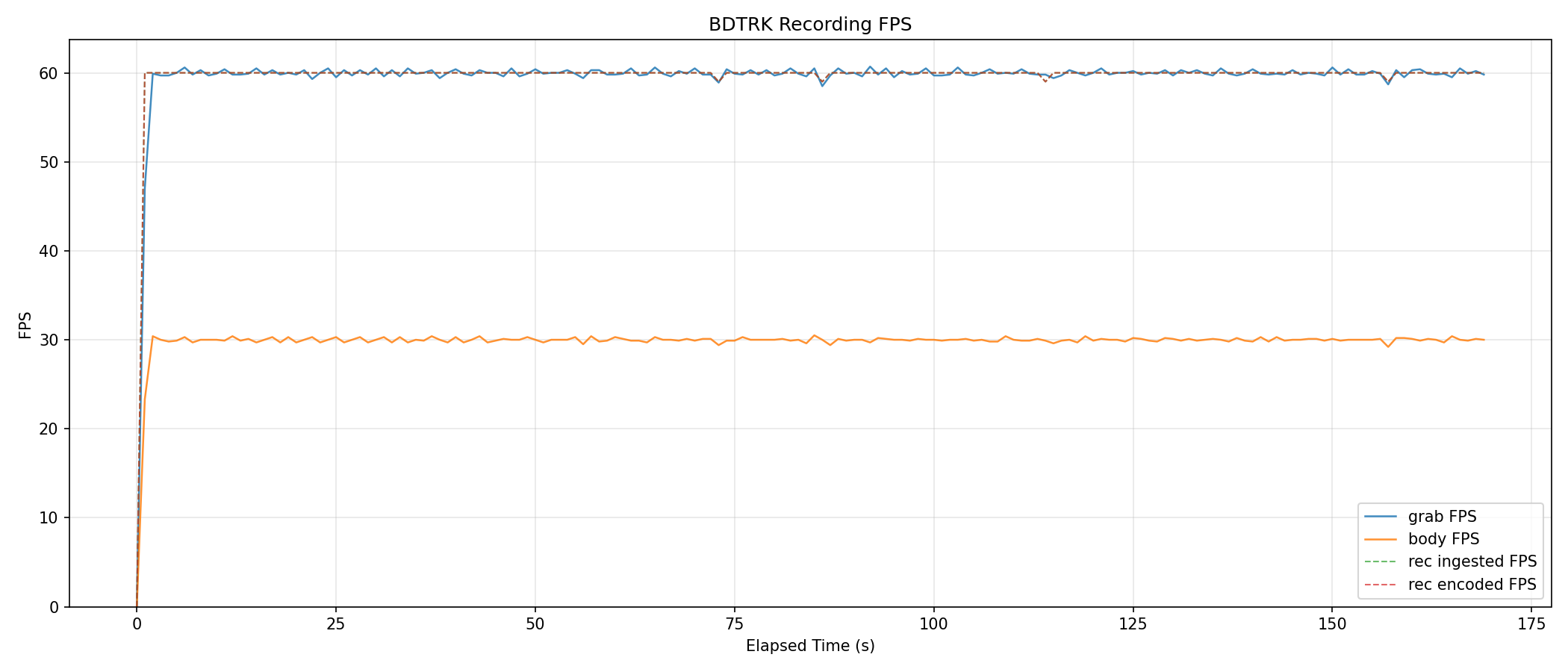

I found that when I comment the “PositionalTracking” part, Everything is back to normal. It seems PositionalTracking dragged down the entire process. I am not sure. If the camera is static, is it ok to cancel PositionalTracking?
    // Enable positional tracking
    // sl::PositionalTrackingParameters tracking_params;
    // // SDK 5.x: enable_area_memory removed (always available)
    // err = zed\_.enablePositionalTracking(tracking_params);
    // if (err != sl::ERROR_CODE::SUCCESS)
    //  RCLCPP_FATAL(get_logger(), "Positional tracking failed: %s", sl::toString(err).c_str());
    //  throw std::runtime_error(sl::toString(err));
If the camera is static, then you can disable Positional Tracking.
If you enable the Object Tracking feature that requires Positional Tracking to be enabled, the ZED SDK internally enables it with the lowest demanding settings.
if the camera is static it is better to set it with PositionalTrackingParameter::set_as_static: PositionalTrackingParameters Class Reference | API Reference | Stereolabs
this way the positional tracking module will be internally disabled (no compute power required) but the SDK will behaves as it is running, so you can enable Body Tracking.
