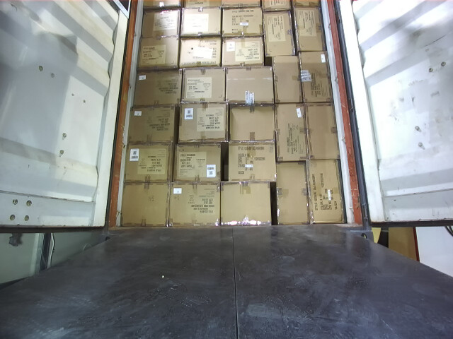

First, the following image was obtained using the ROS1 API after installing the following SDK on JetPack 5.1.2:

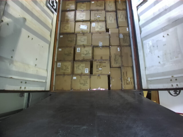

Next, the following image was obtained using the ROS1 API after installing the following SDK on the same JetPack 5.1.2 environment:
There was a noticeable difference in the level of blurriness, which resulted in significant differences in tasks such as object detection.

The two images have two different fields of view.
Did you perform some kind of “manual calibration”?
