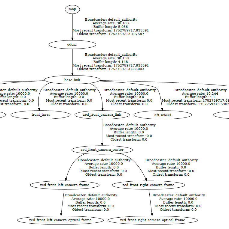

Please send a picture of your TF Tree.
You can use rqt to generate it

The TF tree is correct. To obtain the odometry in the base_link frame you can use TF tools to transform it.
