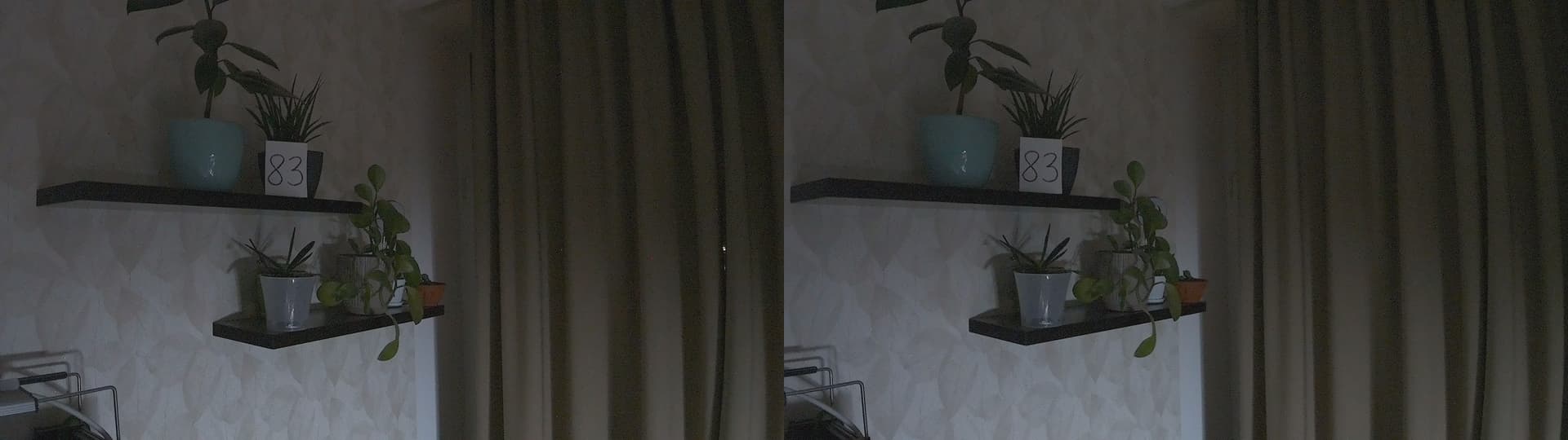

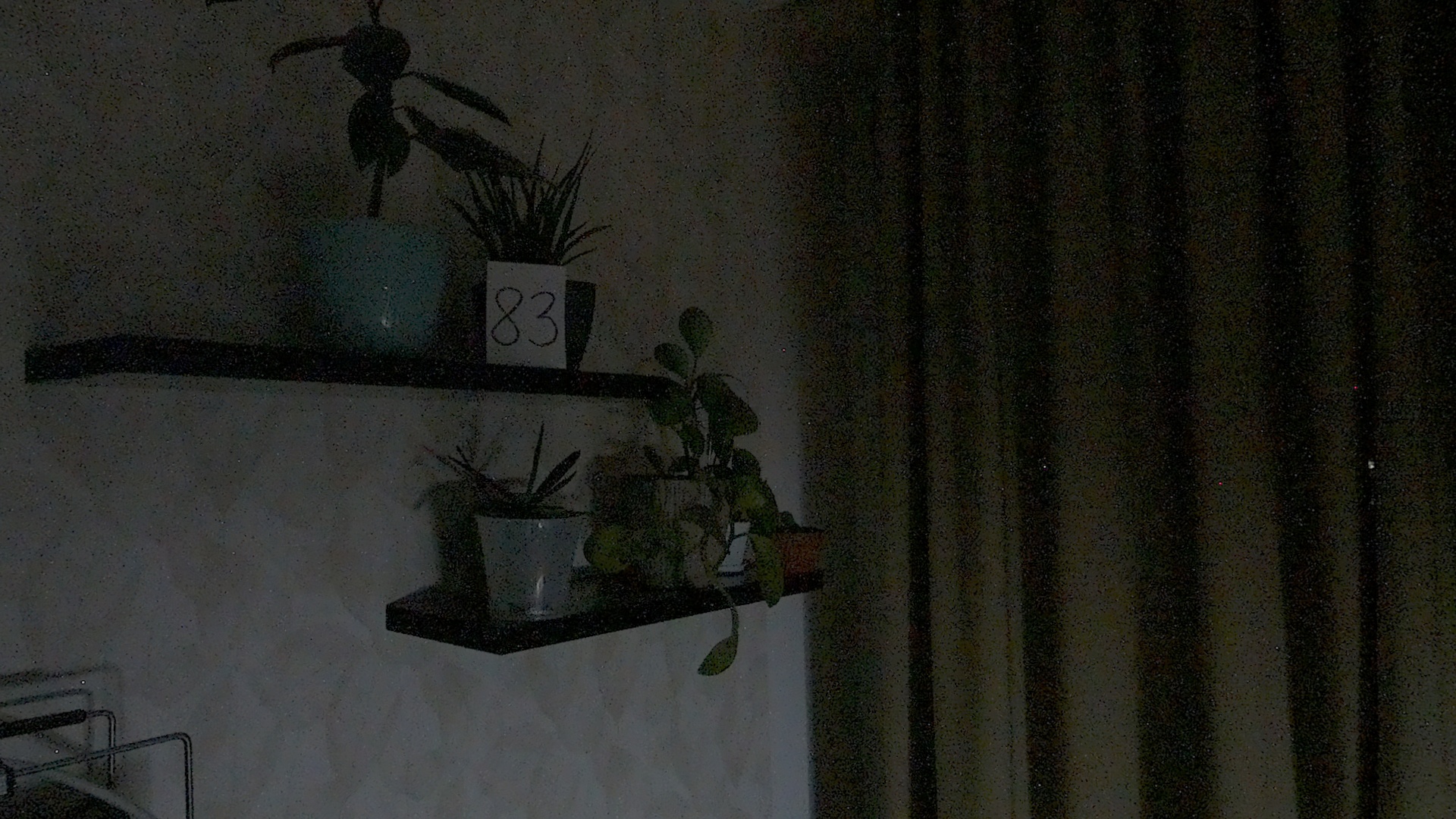

Hello.
I use a zedxmini camera, and I’m trying to get it ready in difficult lighting conditions. (low lighting)I could say that the conditions are too bad and it’s impossible primarily, but using ZED_Explorer I can get the normal picture but using common_stereo.yaml and zedxm.yaml from zed_ros2_wrapper, I changed tons of parameters, and I can’t even get close to the image that I got from ZED_Explorer.
Is it possible to recommend how to extract parameters from ZED_explorer and apply them to the wrapper configuration?
I tried to apply visible parameters as: saturation, sharpness, gamma,turn white_balance and exposure to auto and use the same denoising and exp. compensation but the picture is still different. A lot of noise in the picture.
ros2_wrapper
zedxm.yaml
video:
exposure_time: 16666
auto_exposure_time_range_min: 28
auto_exposure_time_range_max: 16666
exposure_compensation: 50
analog_gain: 8000
auto_analog_gain_range_min: 1000
auto_analog_gain_range_max: 16000
digital_gain: 128
auto_digital_gain_range_max: 256
denoising: 50
common-stereo.yaml
saturation: 4
sharpness: 1
gamma: 6
auto_exposure_gain: true
exposure: 100
gain: 97
auto_whitebalance: true
whitebalance_temperature: 42
enable_24bit_output: false
publish_rgb: false
publish_left_right: true
publish_raw: false
publish_gray: false
publish_stereo: false
I also tried to change the gamma to 2; the noise was lower, but the image was darker.
And I would prefer a setting with auto configuration. No one canceled the day.
Once again. ZED_Explorer can show a good picture, I need it in ros2_wrapper. Help me with it, please.
I really appreciate any help you can provide.

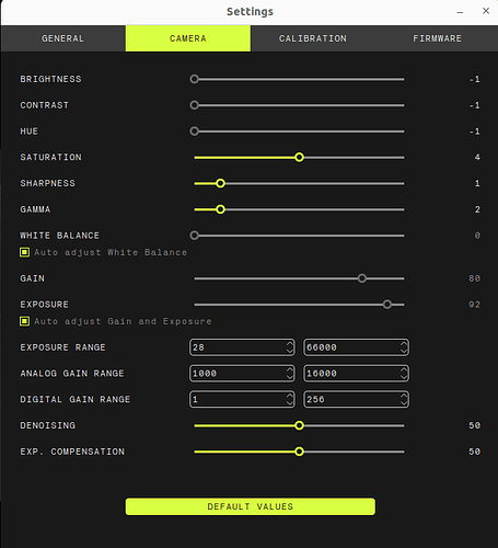

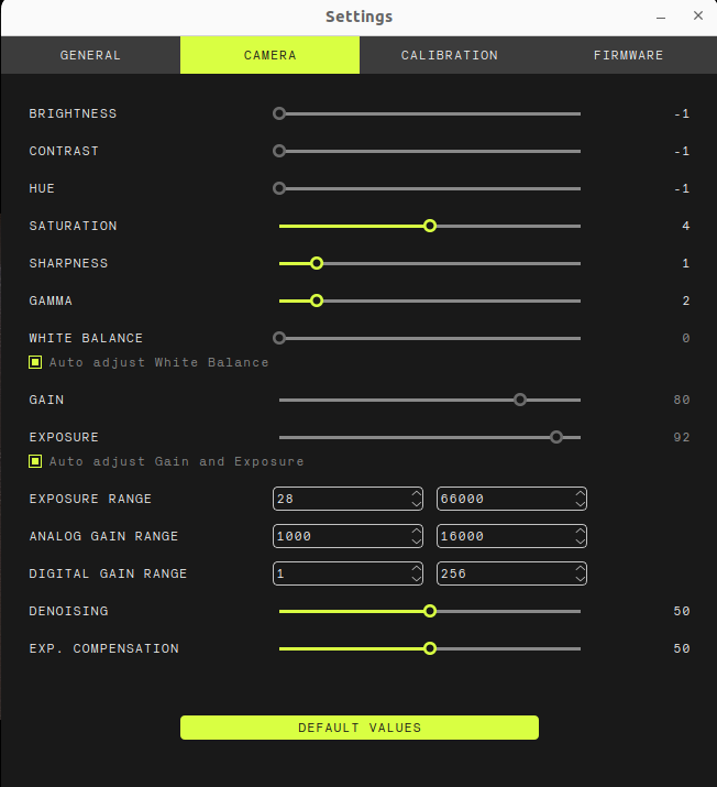

Please take a screenshot of the Camera Settings in ZED Explorer and share it here. I will help you set up the ROS 2 Wrapper the same.
sergii
November 26, 2025, 12:48pm
3
Hello Myzhar,
Here is my screenshot with the current settings from ZED_Explorer
I tried to apply these parameters, but I think there must be something else that can affect quality.
