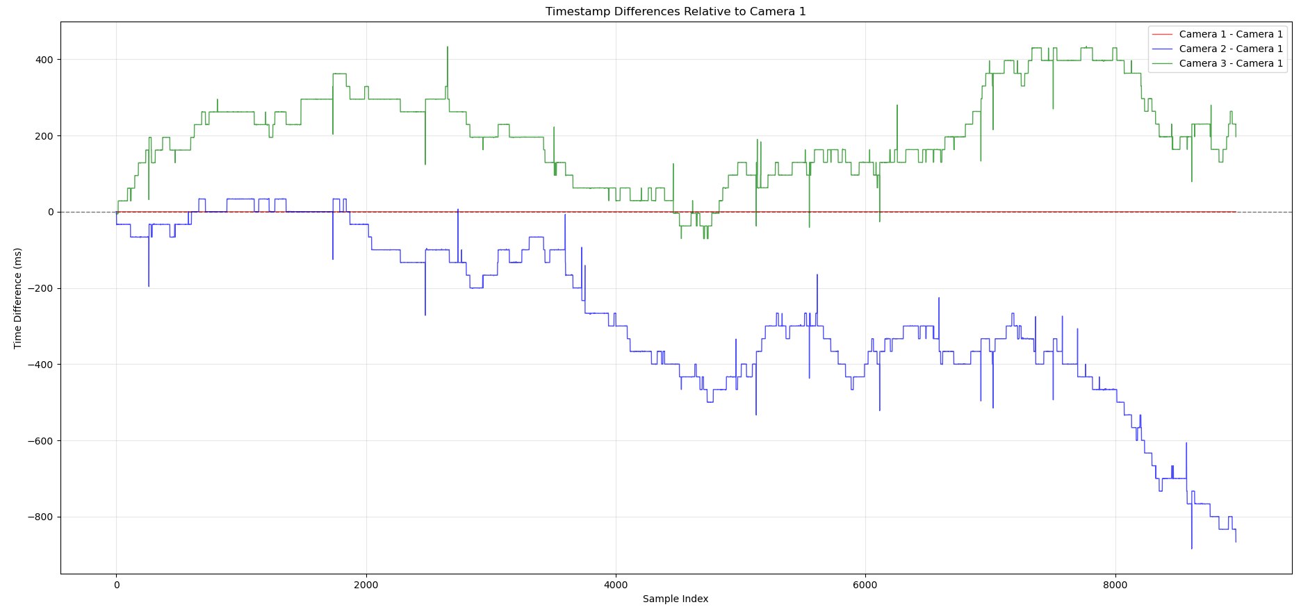

I followed the guide for Enable full onboard synchronization, but the ts of the images are drifting over time.
In this plot, the time difference of each camera wrt the camera 1 are shown. The plot is showing a recording of 9000 samples which is 5 min at 30 fps.
Thanks
Hi @LeoBrizi,
Would you be able to update to ZED SDK 5.2.3 and ZED X Driver 1.4.1 to benefit from all sync and performance improvements that may impact this?
Update to ZED SDK 5.2.3 and ZED link 1.4.1

I found out that I’m using an Aetina Carrier board. Should I ask their support to solve this synchronization issue?
I think it would be best to handle it with the Stereolabs team in the loop as well. Could you send an email to support@stereolabs.com with a link to this issue to discuss?
