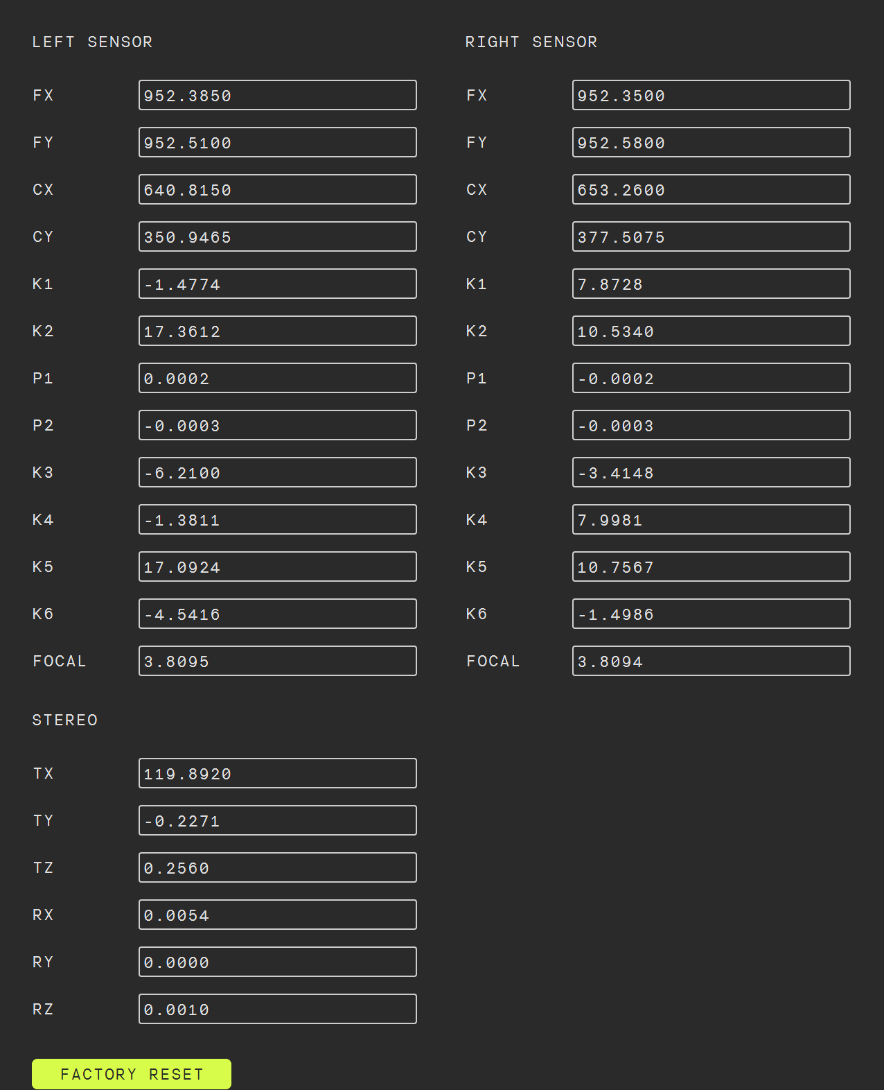

The values I can see in the Zed Explorer are like this (resolution is at HD720):

Hi @MathijsNL
What’s the version of the IMU firmware on your camera?
If it’s 777, please upgrade it to 778, retry, and let me know if the problem persists.
Firmware version is already at 778
I tested with another camera, which is running with firmware 777. Same issue.
PS C:\Program Files (x86)\ZED SDK\tools> & '.\ZED Explorer.exe' --dc
*** Restore Factory Calibration ***
[ZED 2i 32172731]
Downloading factory calibration...
Configuration file already exists... No changes applied.
Writing factory calibration to EEPROM...
Calibration differs from factory settings (LEFT RIGHT STEREO changed) ÔÇö updating...
Failed to update calibration for SN 32172731.
After updating this camera to 778 the issue remains.
Downgrading the SDK from 5.4 to 5.3.1 also gives the same error.
Can you try to delete the file SN32172731.conf from the C:\Program Files (x86)\ZED SDK\settings folder of your ZED SDK installation and let me know if this fixes the problem?
I couldn’t find the calibration files in there, they seem to be located here now:
C:\ProgramData\Stereolabs\settings
I deleted them and the output of ZED Explorer now says its downloading the file first:
C:\Program Files (x86)\ZED SDK\tools>"ZED Explorer.exe" --dc
[ZED 2i 34489494]
Calibration differs from factory settings (STEREO changed) ÔÇö updating...
Failed to update calibration for SN 34489494.
The error still occurs unfortunately.
Hi @MathijsNL
I’ve just reported your problem to the ZED SDK team.
They will analyze all the information you provided and fix it as soon as possible.

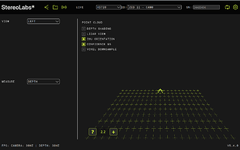

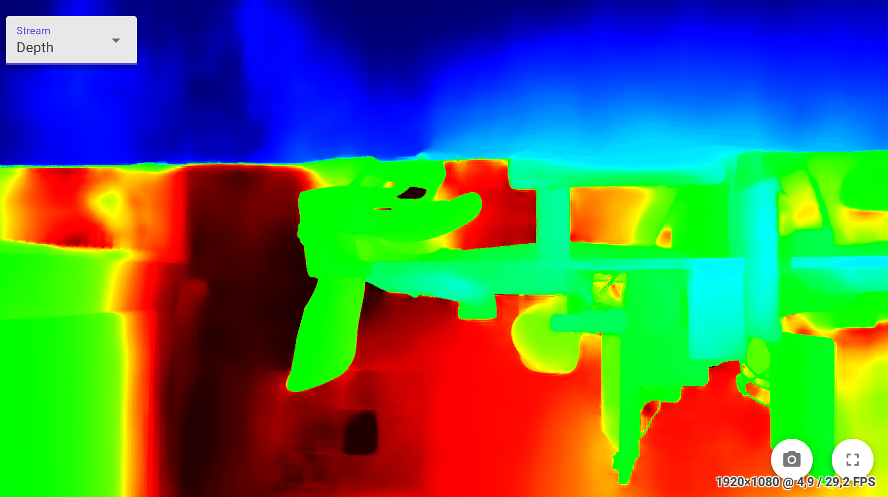

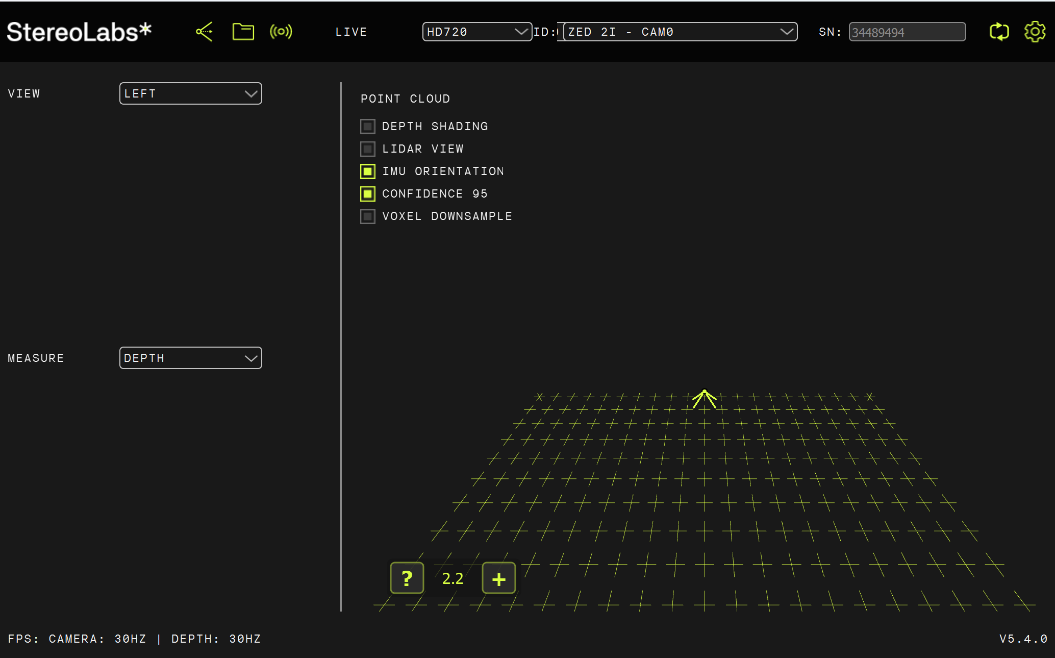

Can you tell me if ZED Depth Viewer works as expected?
ZED Depth viewer still works expected for me, it hasn’t given me any output since SDK 5.1. I can confirm the camera produces depth info though.
Thank you for the details.
We will try to understand the cause of the EEPROM saving issue.
If there is anything else you need from my side let me know!
Is there any progress on this issue?
I would very much like to write the calibration file to the camera if possible.
Hi @MathijsNL
have you tested the latest ZED SDK v5.4.1?
Normally, this feature should have been improved and validated.
Seems to be working now in 5.4.1 thanks!
