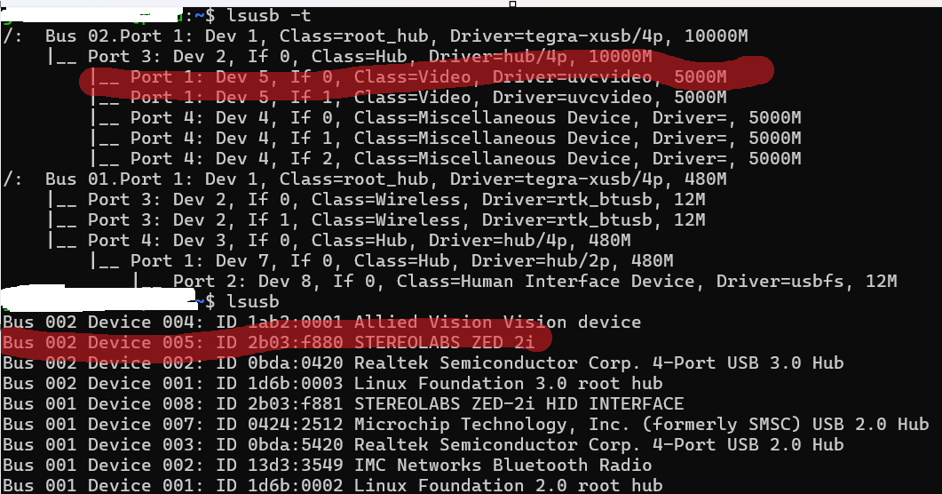

Recently, moved the Alvium camera from the USB type-A port next to the Ethernet port to the USB type-A port next to the 40-pin header. The camera works fine now, I’ll keep it running over the weekend.
  1. This bash command returns 16, so this is not the cause. But this might’ve been the cause some time ago, as I remember tweaking this value several weeks ago.This might’ve been the root cause after all, but I have no proof unfortunately.
  2. lsusb -d 2b03:
    1. Bus 002 Device 005: ID 2b03:f880 STEREOLABS ZED 2i
      Bus 001 Device 008: ID 2b03:f881 STEREOLABS ZED-2i HID INTERFACE
      1. So, both the video stream and the 9-DoF sensors are listed.
    2. lsusb and lsusb -t (also answer this answer, if I'm not mistaken?)
Hopefully the ZED 2i keeps working the upcoming days!
Kind regards,
Niels

There is an issue with either the cable or device:
lsusb -d 2b03:                # ZED 2i must be listed
lsusb -t | grep -A2 xhci      # the ZED 2i port must report 5000M, not 480M
sudo dmesg | grep -iE "usb|xhci" | tail -50
Bus 002 Device 007: ID 2b03:f880 STEREOLABS ZED 2i
