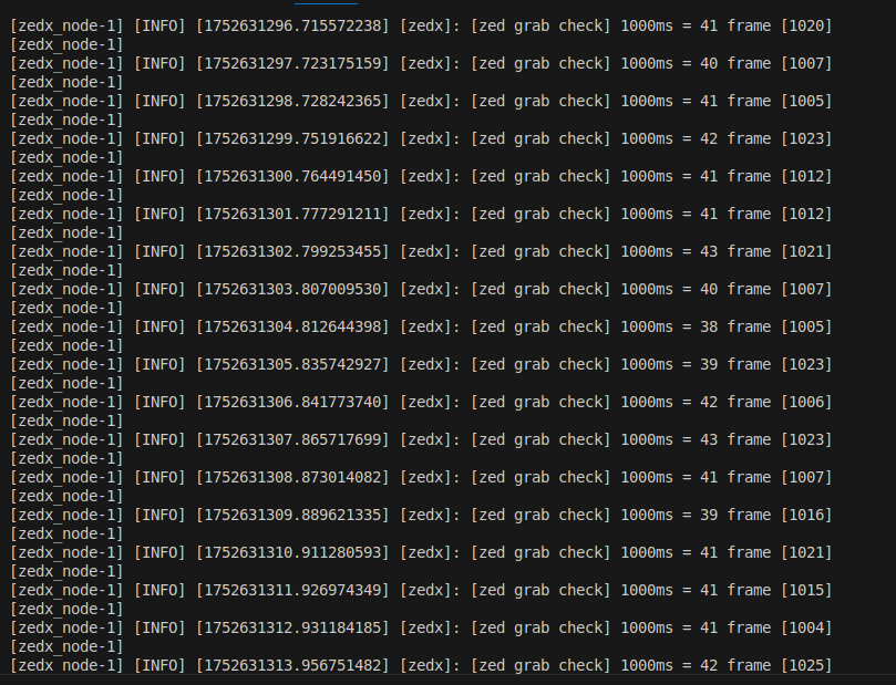

Initially, the system runs at around 30 FPS, but after 2–3 hours of continuous operation, the FPS increases to around 40.
What could be causing this gradual increase in frame rate over time?

After switching from Fast DDS to Cyclone DDS, I noticed the FPS still gradually increases over time. Would you have any advice on how to maintain a stable 40 FPS or higher from the beginning of the program?

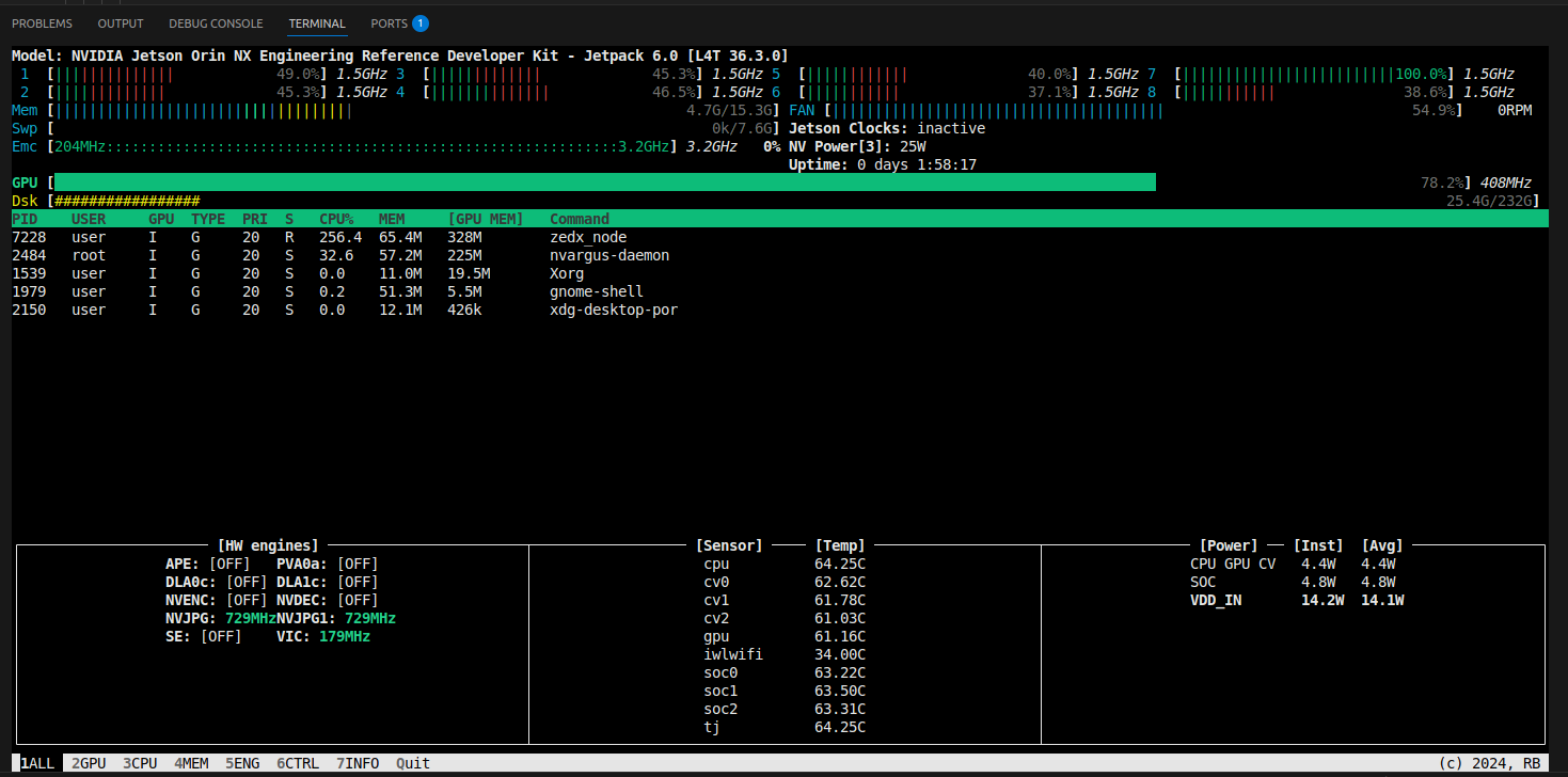

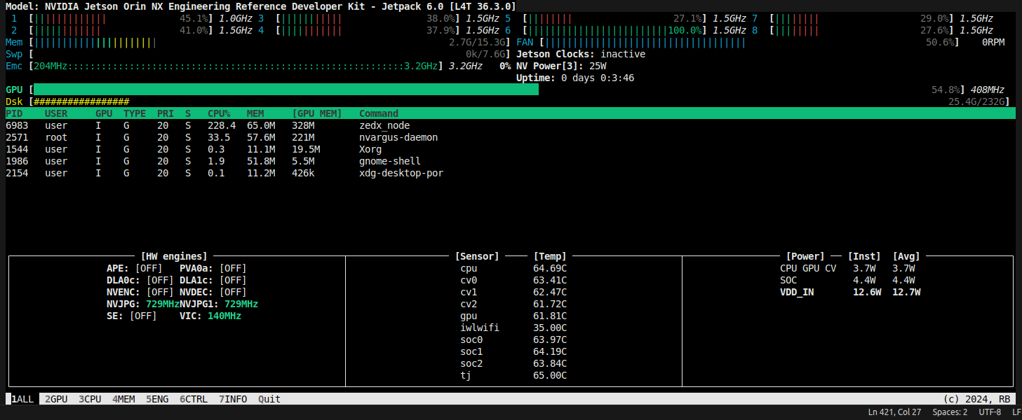

Test Results
Additional Observation
In the Power section at the bottom left of jtop, I noticed that the frame rate increased when the CPU, GPU, and CV exceeded 4W. So I ran the test with the command “sudo jetson_clocks” and the results were the same.
What power mode are you using? I cannot find this information in your screenshots.
Hi @Myzhar .
I’m currently using 25W Power mode.

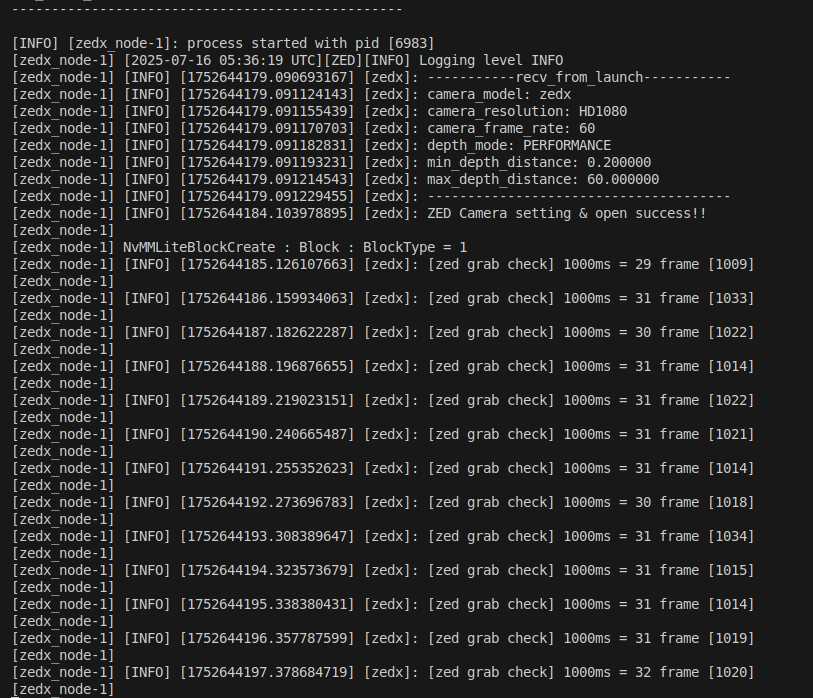

Is the behavior present also in MAXN mode with jetson_clocks.sh active?
Hi @Myzhar.
I switched to MAXN mode, enabled sudo jetson_clocks, and I’m running ROS 2 with Cyclone DDS.
However, I’m only getting around 29 to 33 FPS.
Please remove your code to check the frequency and use the Diagnostic information as explained in the documentation.
