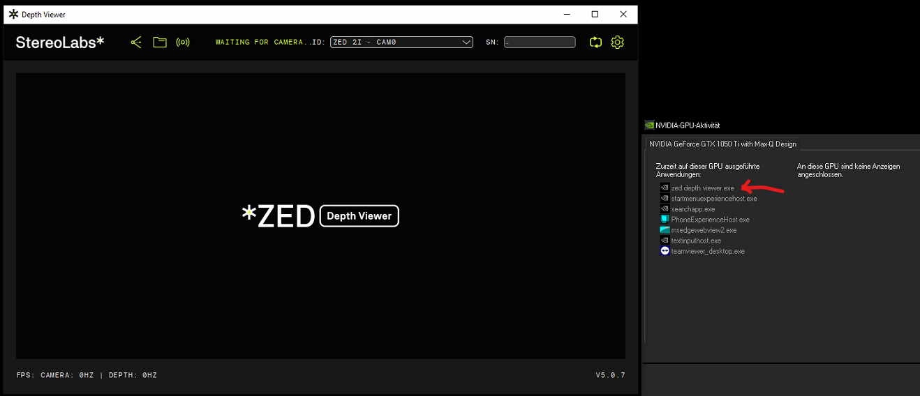

The ZED-Explorer shows the image fine. However ZED-Depth-Viewer will not connect to the camera. From the sample application ZED_Depth_Sensing from
the SDK, I get following output.

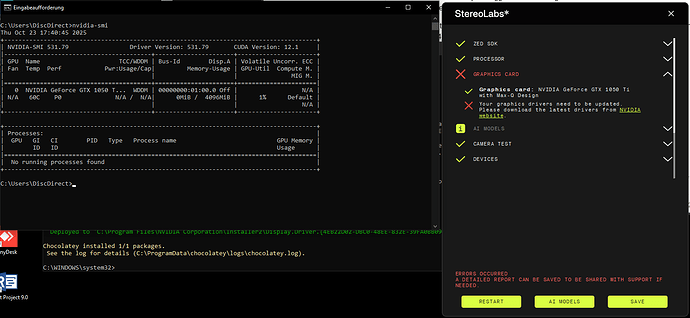

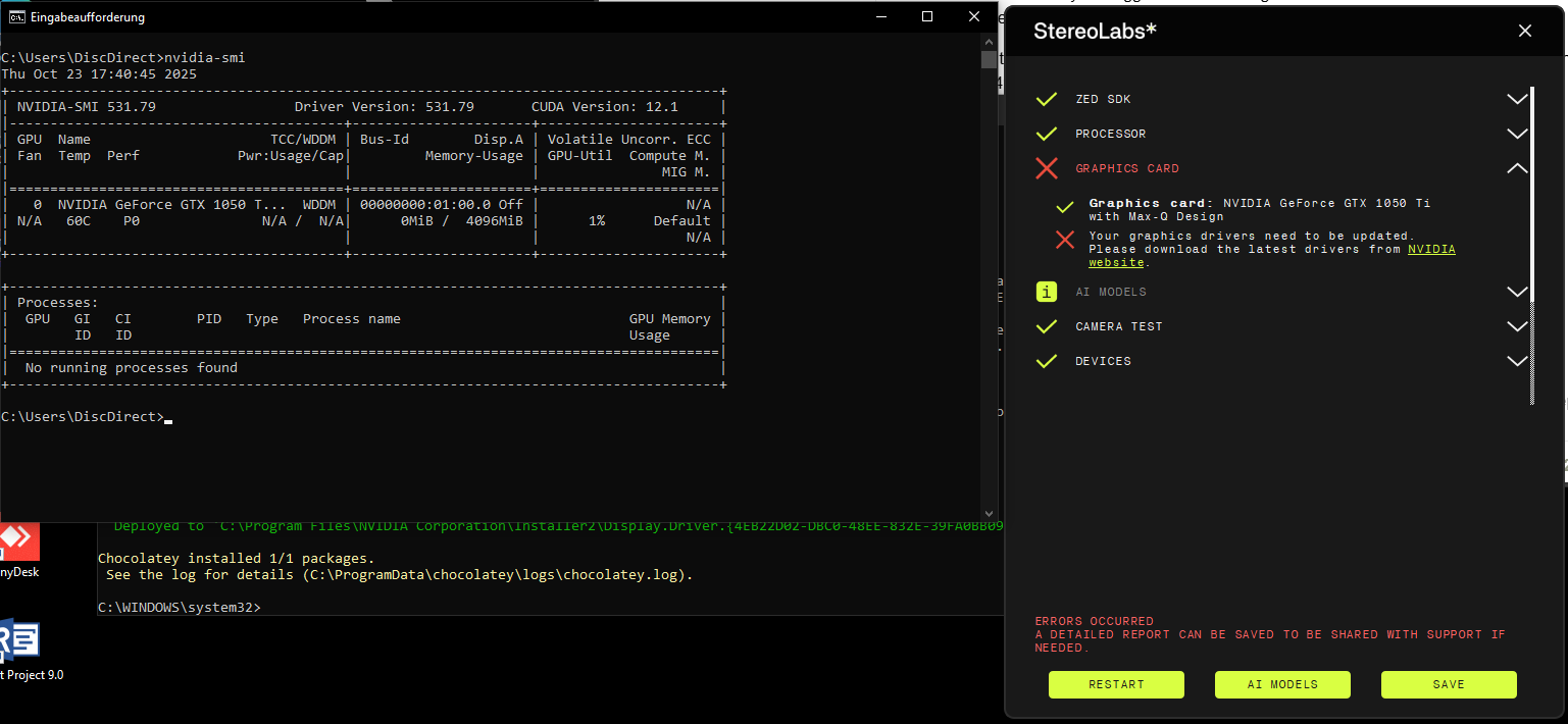

[Sample][Error] Camera Open | NO GPU COMPATIBLE : An NVIDIA GPU (Pascal
or newer) is required to run this software (for Kepler and Maxwell GPU,
please use CUDA 10.2 ZED SDK installers) Exit program.

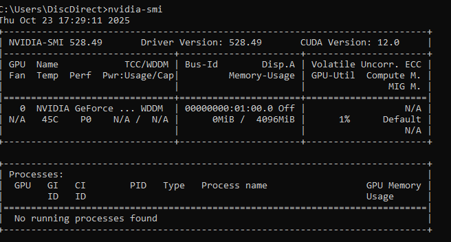

Obviously, the sample application doesn’t recognize my GPU (a
Pascal-GPU) correctly.
Can you please help me to diagnose the installation on the host system
(b)?

please run the ZED Diagnostic tool on the system “b”, save the report, then share the content here.
As a new user, I can’t attach a file so I just paste it here…

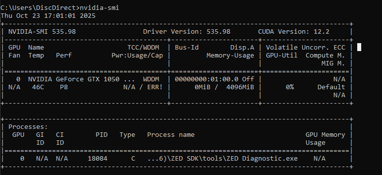

"Graphics Card": {
    "deviceCount": 1,
    "deviceDriverVersion": 13000,
    "devices": \[
            "arch": "Pascal",
            "computeCapability": "6.1",
            "cores": 768,
            "name": "NVIDIA GeForce GTX 1050 Ti with Max-Q Design",
            "totalMemoryBytes": "4294836224",
            "totalMemoryMB": 4095.875
    "initResult": 0,

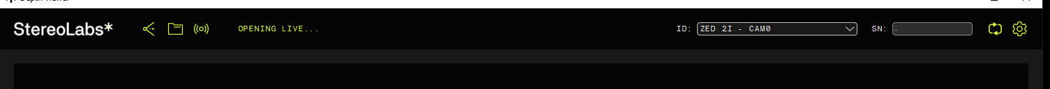

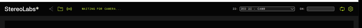

The depth-viewer deadlocks bw. “Waiting for camera…” and “Opening Live…”

I also followed your suggestion and downgraded the NVIDIA-drivers from 581.57 (newest as of today) back to 535.98 and to 528.49 (Feb/2023).
With the NVIDIA-drivers version 535.98, I’ve had the same problem, with the version 528.49, the ZED-diagnostic tool said that I should update.
Please see the diagnostics reports attached…

Just adding the nvidia-smi output for the two latest driver installations as previously mentioned…
One last downgrade of the NVIDIA-driver to the driver fitting the CUDA 12.1…
As you can see in the screen shot the diagnostic-tool doesn’t approve the graphics card.
ZED_Diagnostic_Results_cuda_12.1_driver_531.json (16.9 KB)

Is there anyway to enable any diagnostics output from the depth-viewer application to be able to perform more thorough diagnostics of the issue? I’ve been asking this already. Can you check this please?
Thanks for helping.
It can be a problem with OpenGL and your GPU.
Please try to use run this example application:
