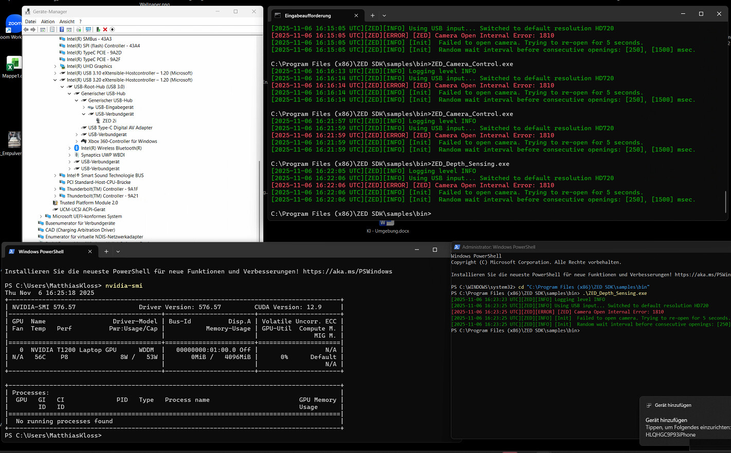

c) Windows11/ZedSDK5.1/CUDA12.9 (NVIDIA T1200/4GB)
I’ve installed the CUDA12-SDK and then Zed-SDK 5.1 for CUDA12 as provided by your website. Running the zed-diagnostic tool to verify the installation started fine, but the tool crashed without any error message, when “testing” the camera.
I run the sample-applications to get some more diagnostic help. Please see the screenshot:
I tried to put together all information about the system.
BTW, I can capture the image from the camera using the “Camera” app of windows…
What does the “Internal Error: 1810” mean?
Thanks for helping!
In the list of available devices you should find two “ZED 2i” items:
  • a video device
  • an HID device
Can you see both or only the video?
Hello @Myzhar ,
I don’t see any HID-devices there. However, reinstalling the NVIDIA-drivers made the camera on system (c) working. I’d still like to know what the “Internal Error…” mean, but today it is gone and everything works fine on system (c).
Thanks!

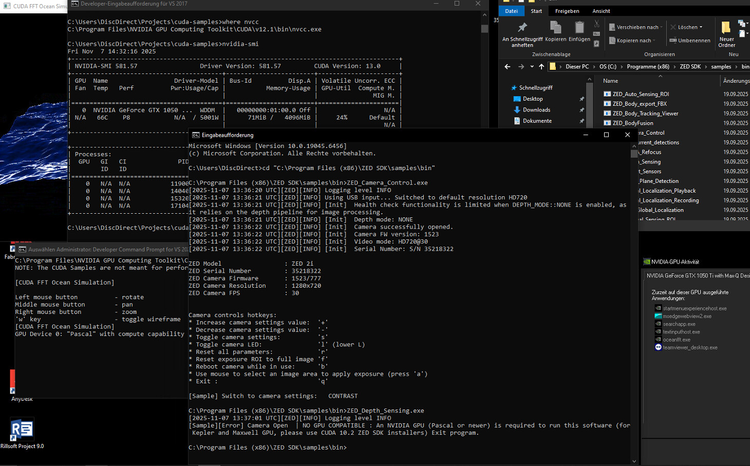

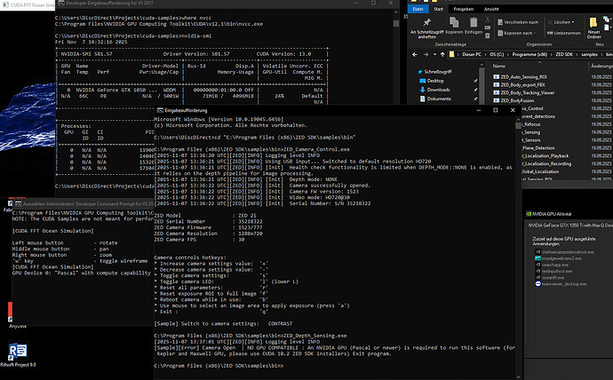

Hello @adujardin
I verified the CUDA-installation with the “oceanFFT” demo (top left corner). The I tried the zed-sdk samples again. ZED_Camera_Control works find, but the ZED_Depth_Sensing can’t detect the GPU.
What should I do next? Maybe downgrade the zed-sdk/cuda? To which version?
Thanks for helping!
@pavolk Did you changed the depth mode to ULTRA or PERFORMANCE before running it as suggested ?
If my hunch is correct and the GPU is not compatible with the NEURAL depth mode you can try ZED SDK 4.2.X
