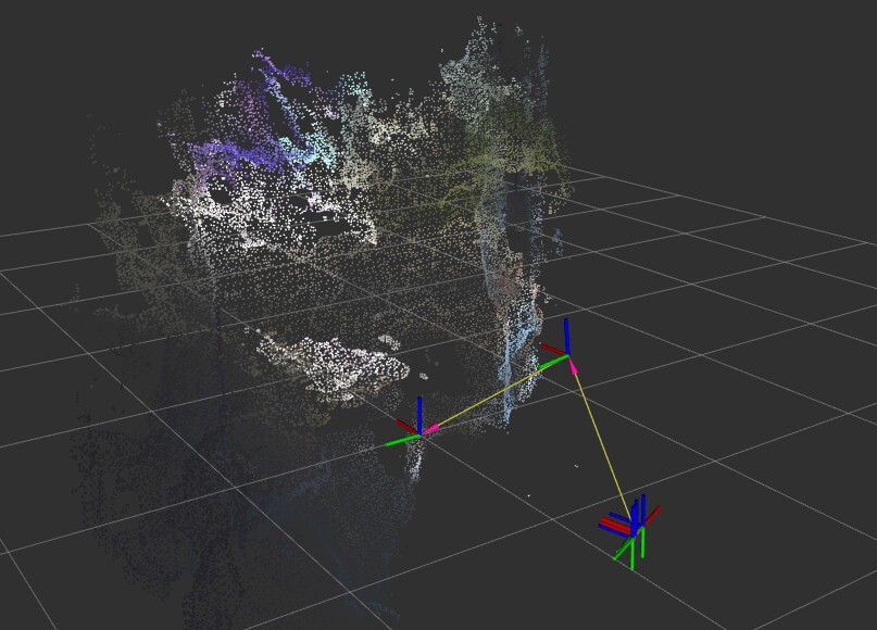

Hi @Myzhar! Yep, ZED_Sensor_Viewer verifies that the accelerometer and gyroscope are available. However, when I try to visualize the camera’s position using Rviz by looking at the camera’s transforms:
They start flying around even though I barely move the camera by a fraction of an inch to produce the above image. My best guess is that this has something to do with the camera being unable to localize since the IMU topic is not being published, but I am not sure.
