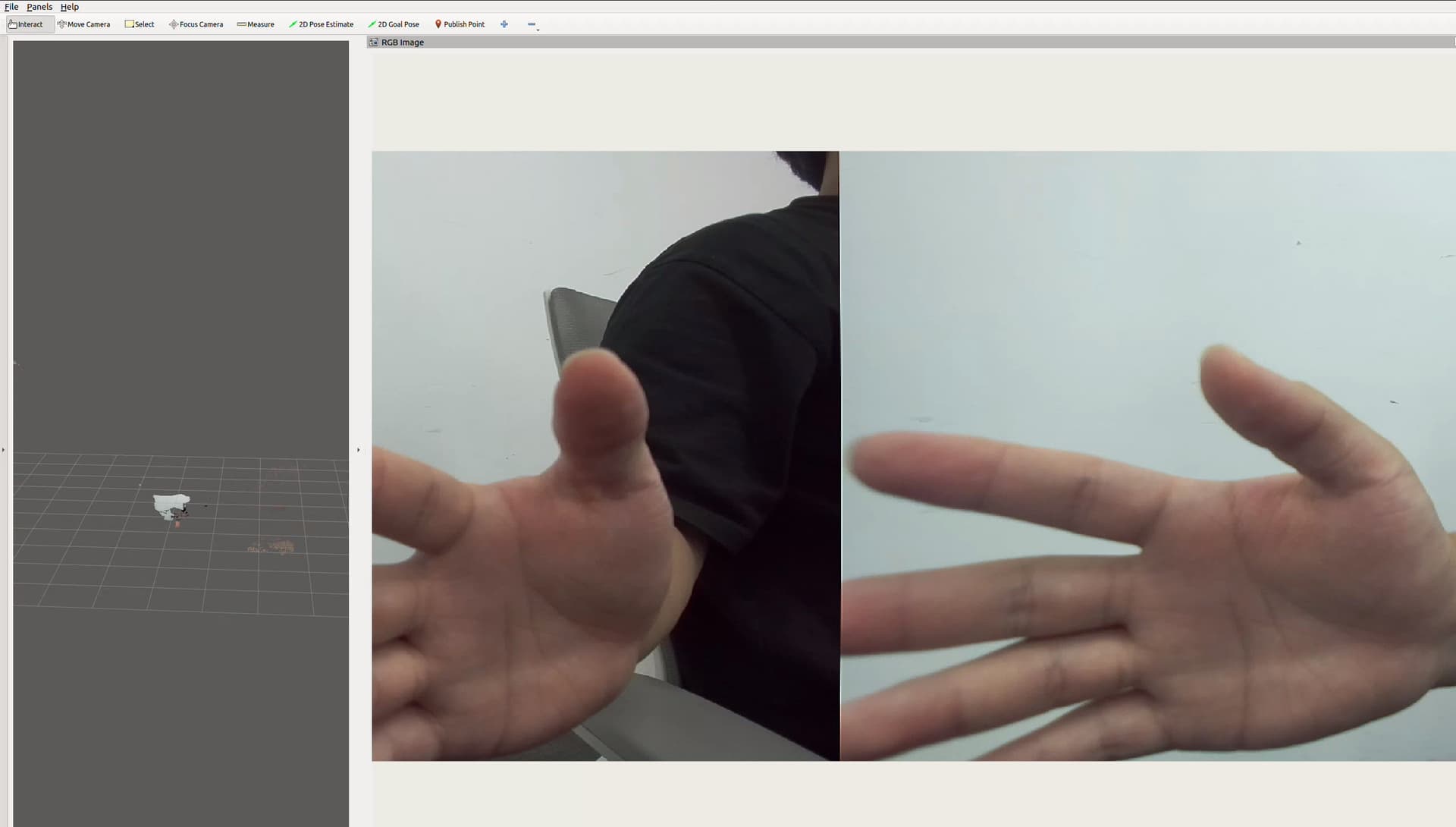

"We are using a ZED2i camera with zed_ros2_wrapper. However, when using cv_bridge and Open3D, there is an issue with the ROS2 image topic—it seems like the image is being distorted. Please see the attached images for reference. Could you help us identify the cause?

The problem that you reported is a typical case of frame tearing that different factors can cause:
- The host is overloaded, so the USB 3 controller buffer is not flushed in time, causing overflows.
- The USB 3 connection is not stable
USB 3 connection instability can be caused by:
- A damaged USB 3 cable
- USB 3 extenders
- USB 3 hubs
- Unstable USB 3 port
- Cable placed close to the power cables of other devices
- other factors
Please verify that none of the factors listed above are affecting your setup.

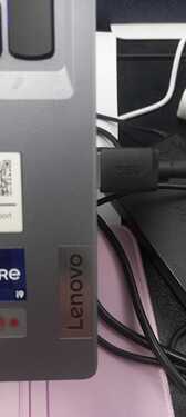

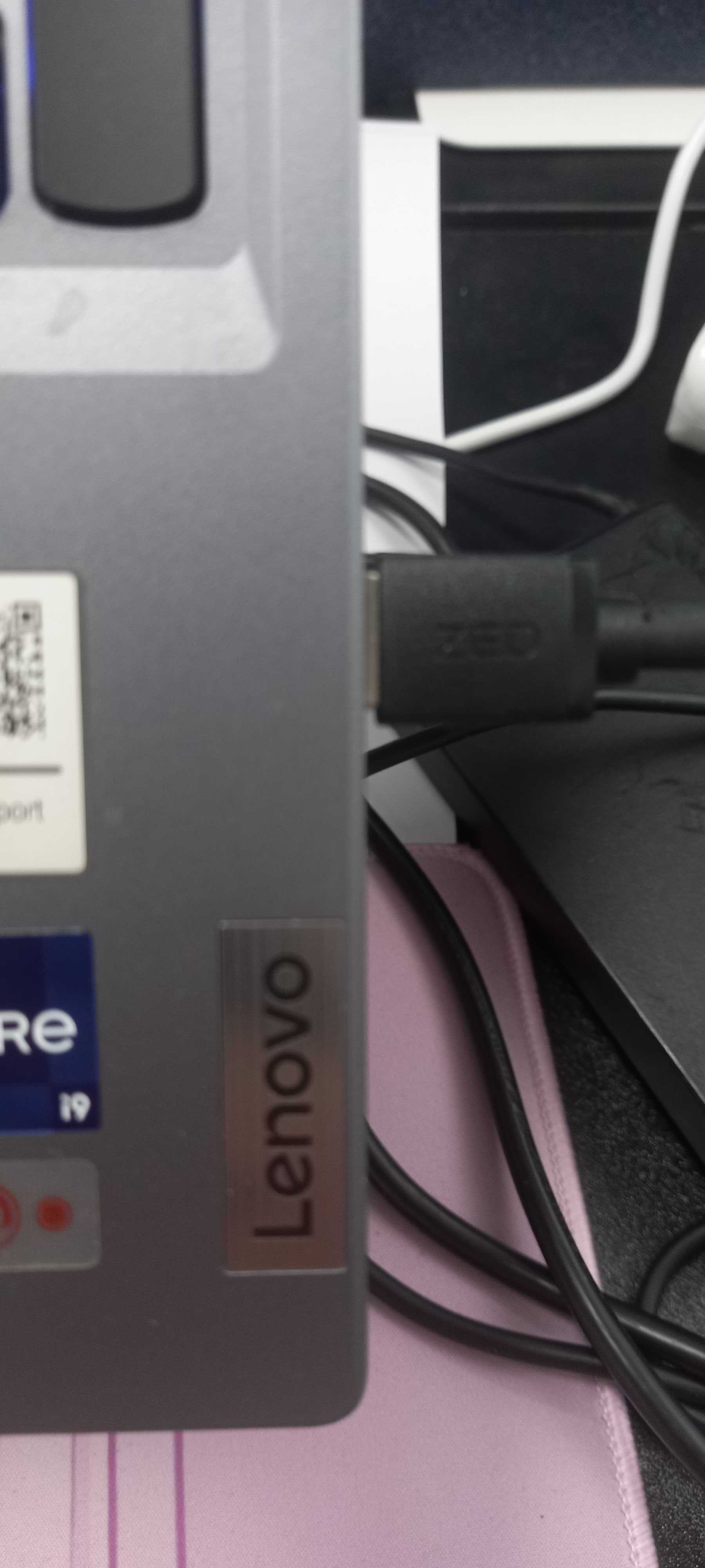

We are currently using Stereolabs’ official USB 3 ZED cable and a USB 3 port.
Nevertheless, the issue described above is still occurring.
Therefore, it doesn’t seem to be a problem with the cable or hardware.
