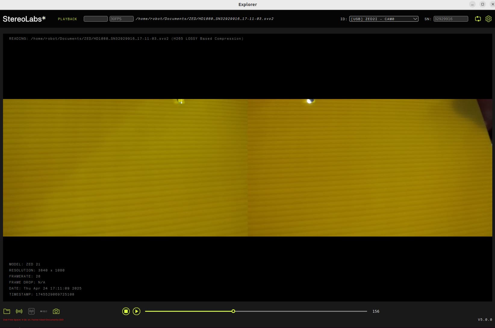

Additionally there is another issue I have found while recording the SVOs. Some frames seem to have been shifted towards the right as shown in the first image. I have also shared how all the other frames look like in the SVO. Any idea on why this could be happening?
You can use ZED Depth Viewer
This problem affects the USB cameras; it happens when the USB 3 controller buffer is full because the host’s CPU is overloaded, and frames are not processed quickly enough.
The ZED Depth Viewer (v 5.0.0) has a problem replaying the SVO files. I do not see the point clouds nor the images in the viewer
