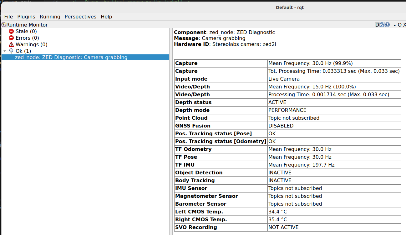

Can you also check the Diagnostic with rqt (Plugins → Robot Tools → Runtime Monitor)?
We provide all the available statistics to understand how well is the node performing with respect to message-receiving performance.
