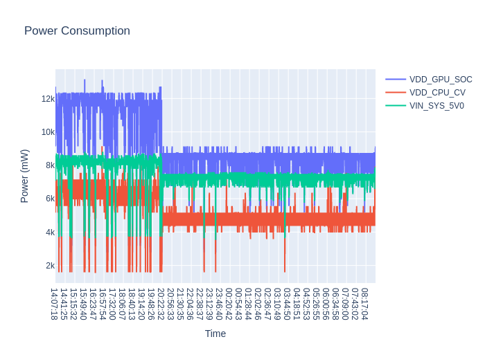

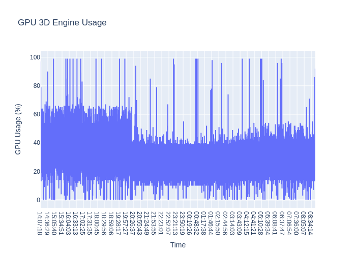

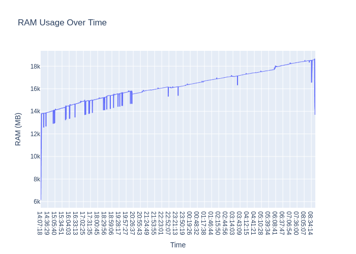

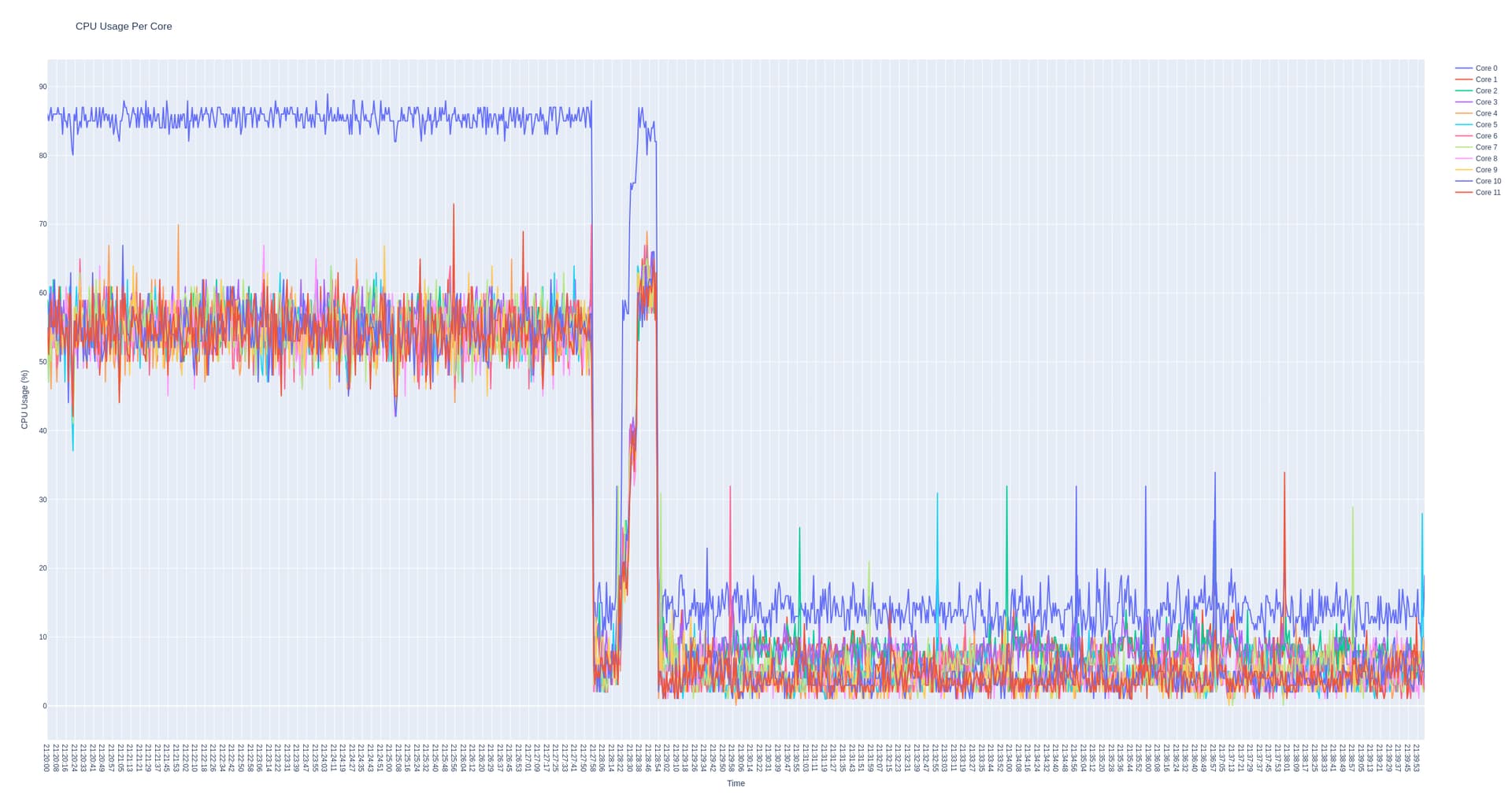

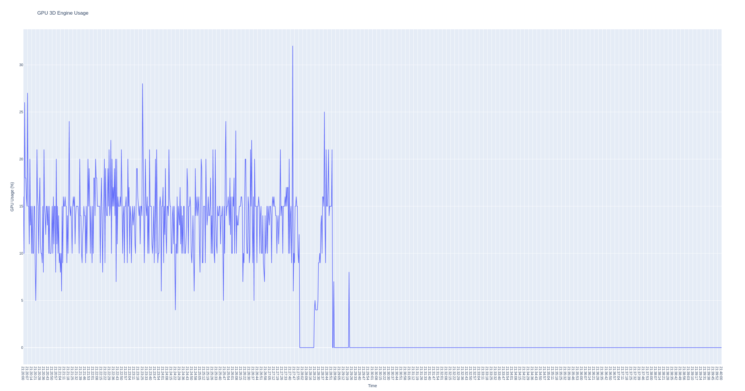

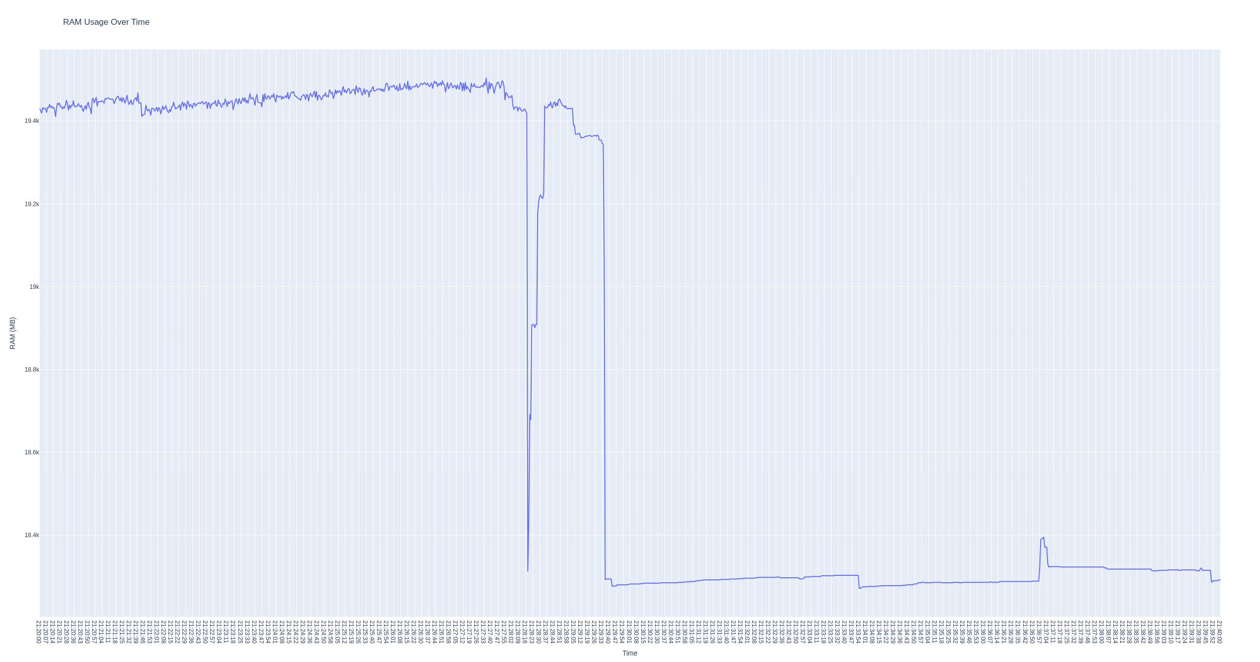

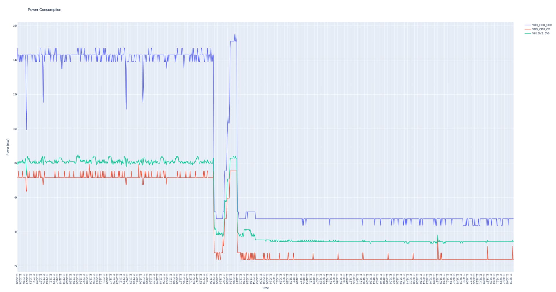

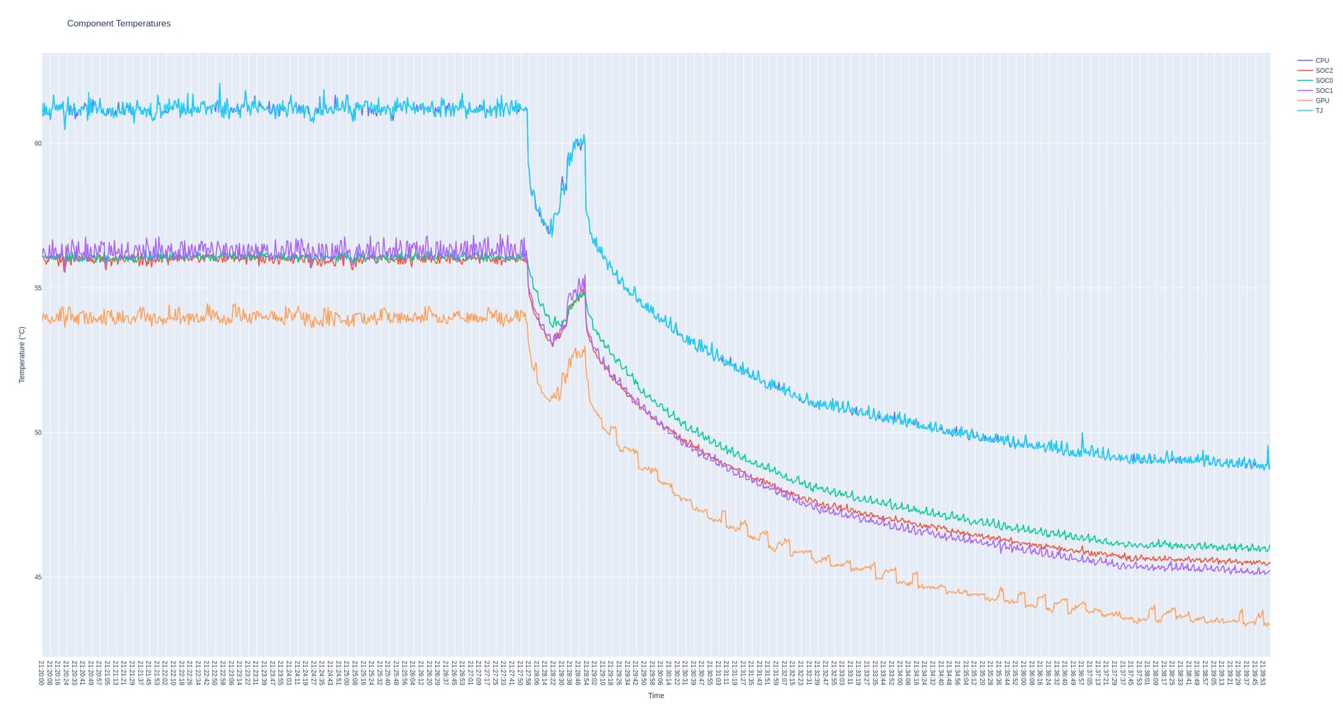

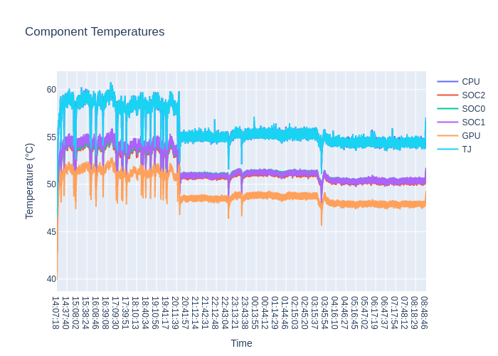

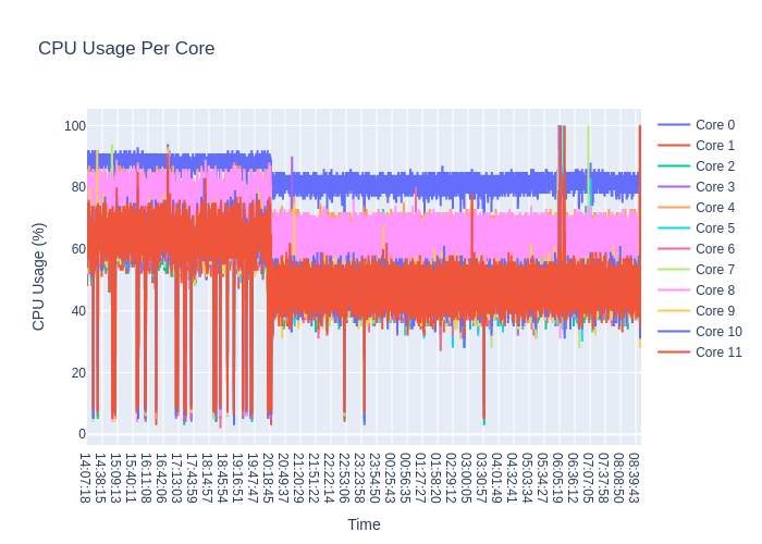

Hi @Myzhar, we tried streaming the 3 cameras again for a longer period and found that the cameras error out after approximately ~8hrs of streaming. We monitored the all the Jetson stats(eg: cpu, gpu, temp etc.) throughout the process and also collected logs for each of the cameras as well as the jetson.
I am sharing the zoomed in version of the time interval where we noticed the streaming to have been stopped. There are a couple of things we wanted to bring to your attention that were observed in the streaming camera logs.
  1. We quite often observe the following error during streaming but the streaming again runs fine after a while and the jetson ram,cpu,gpu,temperature everything looks normal. One additional thing to note here is we have been monitoring the time interval between 2 consecutive frames and the error below comes when the time between 2 consecutive frames is ~10000ms. I have shared a link to all the logs at the bottom of this post
(Argus) Error Timeout:  (propagating from src/rpc/socket/client/ClientSocketManager.cpp, function send(), line 137)
(Argus) Error Timeout:  (propagating from src/rpc/socket/client/SocketClientDispatch.cpp, function dispatch(), line 92)
(Argus) Error InvalidState: Argus client is exiting with 11 outstanding client threads (in src/rpc/socket/client/ClientSocketManager.cpp, function recvThreadCore(), line 366)
(Argus) Error EndOfFile: Unexpected error in reading socket (in src/rpc/socket/client/ClientSocketManager.cpp, function recvThreadCore(), line 277)
(Argus) Error EndOfFile: Receive worker failure, notifying 11 waiting threads (in src/rpc/socket/client/ClientSocketManager.cpp, function recvThreadCore(), line 350)
(Argus) Error EndOfFile: Receiving thread terminated with error (in src/rpc/socket/client/ClientSocketManager.cpp, function recvThreadWrapper(), line 379)
(Argus) Error InvalidState: Receive thread is not running cannot send. (in src/rpc/socket/client/ClientSocketManager.cpp, function send(), line 96)
(Argus) Error InvalidState:  (propagating from src/rpc/socket/client/SocketClientDispatch.cpp, function dispatch(), line 92)
  1. All the three cameras stopped streaming at the exact same instant with the error. This was the time where you see the trend of a sharp dip in the graphs and then it rises again until it permanently drops and the cameras are no longer streaming
[ZED-Argus][Error] Port 1: Reboot has failed for CAM 1 and status 4
[ZED-Argus][Error] Port 2: Reboot has failed for CAM 2 and status 4
[ZED-Argus][Error] Port 0: Reboot has failed for CAM 0 and status 4

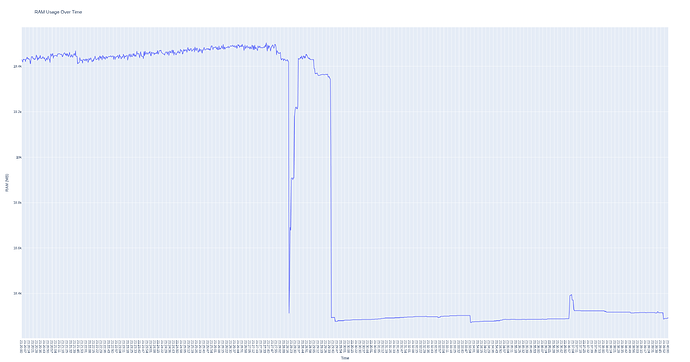

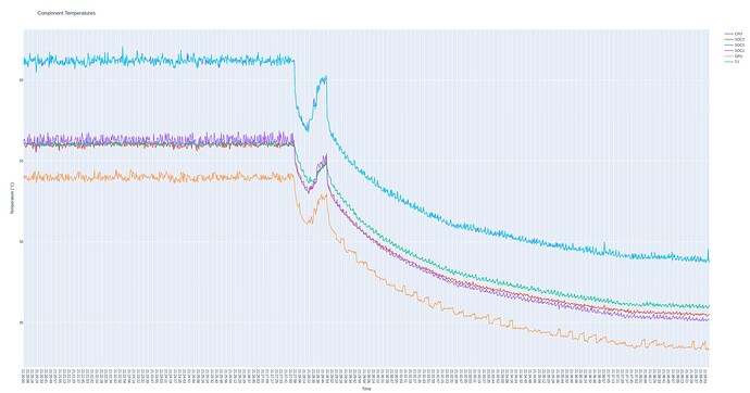

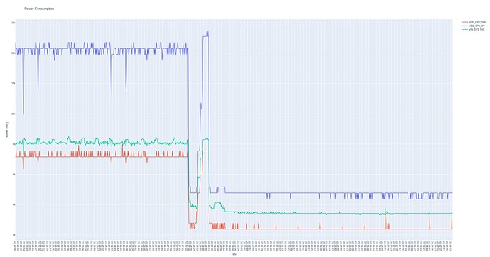

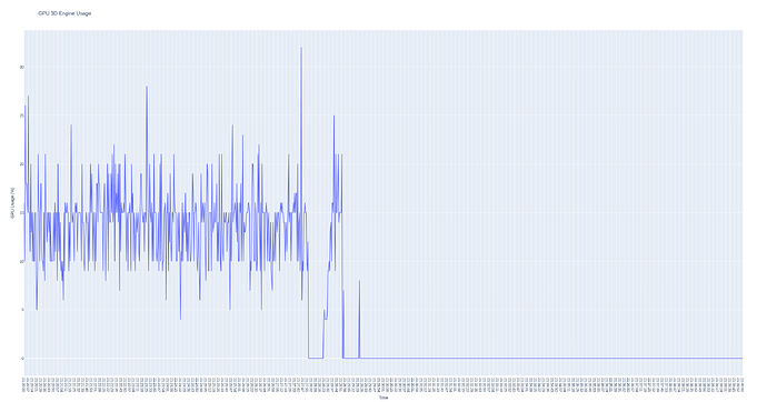

Hi @Myzhar, here is additional data from another test we ran for streaming three cameras. This time only one of the cameras errored out after ~6 hrs of streaming and the other two cameras continued streaming. I am sharing all the jetson plots here as well as the logs from the tests we ran. We observe a little
dip in the cpu usage over time (around 20:18:45 as seen in the plot) plot and also some other plots. This is when one of the streaming cameras stopped with the error
Please note that the other two points that were brought to your attention yesterday still hold true for camera which stopped as well other cameras which continued streaming. We observe that the time between 2 consecutive frames becomes ~10000ms just before the Argus error pops up. What we are not sure is whether there was data that was being received when we see this error message.
