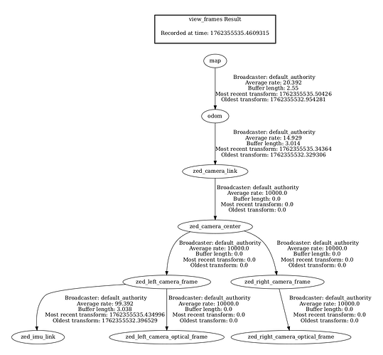

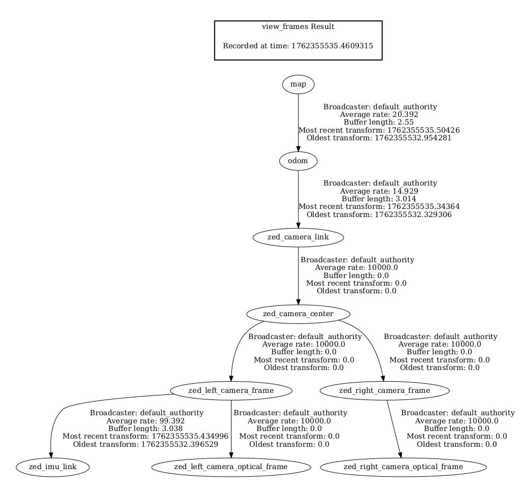

Hi @betelgeuse
It seems that you modified the TF structure.
Please send a picture of the TF tree after you started your node.
Have you read how to do that correctly in the Robot Integration guide?
The important concept is use_zed_localization.
Hi the tf tree was fine infact I was testing the system and everything was working after shutting down and until re launching the camera. And yes I have read the guide
