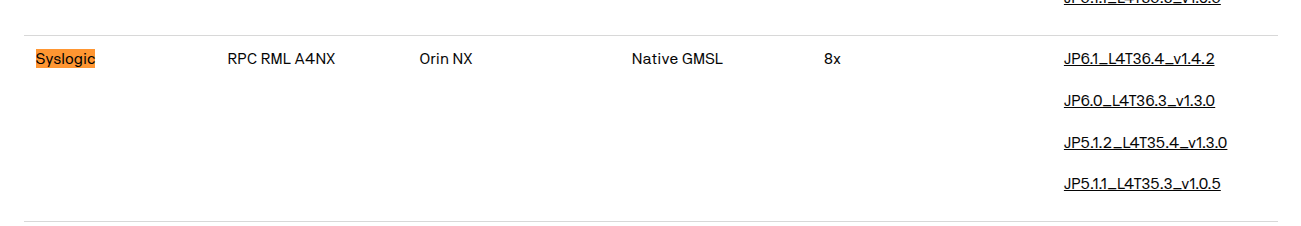

Can you please confirm, in order to get the latest functional zed_x_daemon for the syslogic RMLA4NX box (JetPack 6.0) I should download it from here? Because downloading that was named
syslogic-zedx_1.3.0-L4T36.3.0_arm64.
Yes, that’s the correct link.
Please note that if you want to use the latest ZED X Driver v1.4.2 you must upgrade the device to JP 6.1
