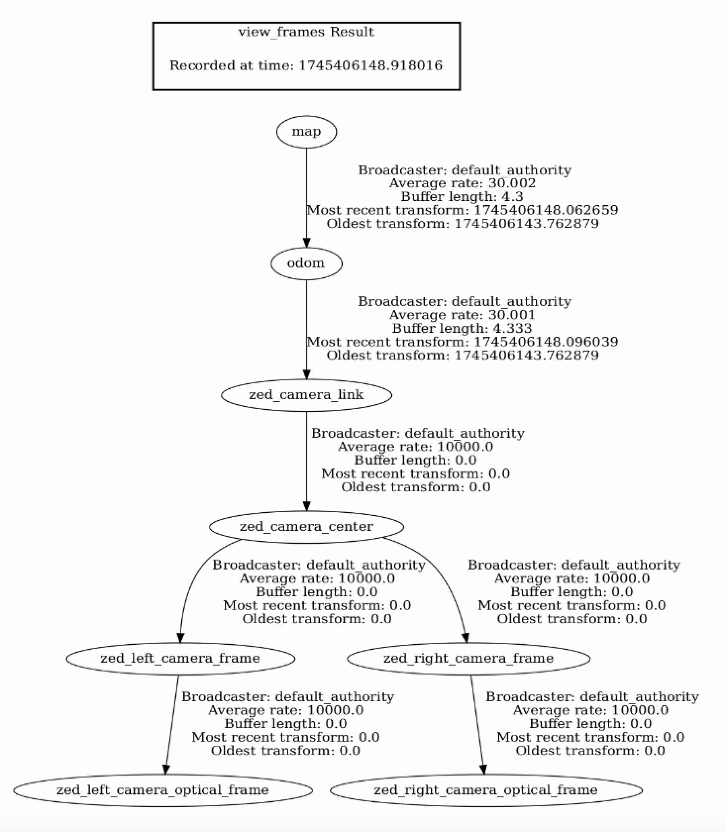

Hi all,
since I’ve updated the ZED SDK to 5.0 EA and pulled the latest ROS 2 wrapper changes I’m having problems launching the ZED node with a recorded SVO file. The node starts up correctly but outputs a message "SVO reached the end. The node has been stopped." right away, even though the SVO should play over 30 seconds.
I think I had the problem with previous SDK versions but with v4.2 everything was working fine.
Detailed log:

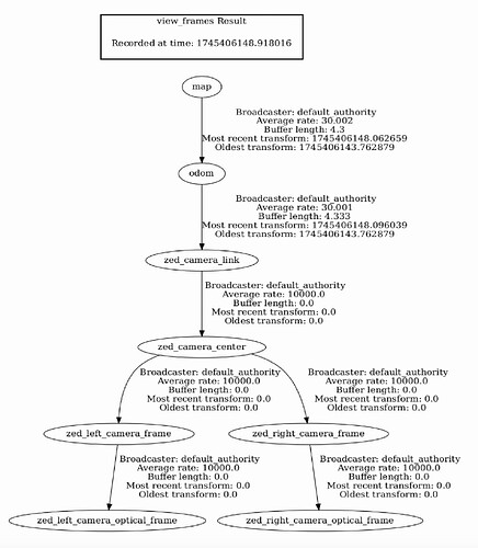

There’s one more issue introduced by the latest changes though, which might be related to the realtime mode: In my custom logic (python node) I’m subscribing to object detections on the /zed_node/obj_det/objects/ topic and map the detection’s bounding box to the map frame using tf2’s transform interface:
for corner in bounding_box_3d.corners:
            try:
                point_stamped = PointStamped()
                point_stamped.header.stamp = self.get_clock().now().to_msg()
                point_stamped.header.frame_id = origin_frame
                point_stamped.point.x = float(corner.kp[0])
                point_stamped.point.y = float(corner.kp[1])
                point_stamped.point.z = float(corner.kp[2])
                position_in_map_frame = self.tf_buffer.transform(point_stamped, 'map', Duration(seconds=5))
               # Additional logic omitted for readability
            except (tf2_ros.ExtrapolationException) as e:
                self.get_logger().warn(f"Extrapolation error: {e}")
With the 4.2 SDK version I had no problems with a timestamp mismatch but now I do. With default parameters I get the following message:
Extrapolation error: Lookup would require extrapolation at time 1745406207.072573, but only time 1744904398.413232 is in the buffer, when looking up transform from frame [zed_left_camera_frame] to frame [map]
Seems like the tf2 frames are published with the recorded timestamps whereas self.get_clock().now().to_msg() uses the current system time. Next, I tried setting the svo.use_svo_timestamps to false. Unfortunately there’s still a major mismatch between the time stamps, it seems like the tf frames data samples are lagging behind a lot:
[detection-3] [WARN] [1745406559.457465536] [detection]: Extrapolation error: Lookup would require extrapolation into the future.  Requested time 1745406553.450406 but the latest data is at time 1744904400.380255, when looking up transform from frame [zed_left_camera_frame] to frame [map]
[detection-3] [WARN] [1745406565.476422963] [detection]: Extrapolation error: Lookup would require extrapolation into the future.  Requested time 1745406559.458283 but the latest data is at time 1744904400.380255, when looking up transform from frame [zed_left_camera_frame] to frame [map]
[detection-3] [WARN] [1745406571.483640751] [detection]: Extrapolation error: Lookup would require extrapolation into the future.  Requested time 1745406565.477858 but the latest data is at time 1744904400.380255, when looking up transform from frame [zed_left_camera_frame] to frame [map]
[detection-3] [WARN] [1745406577.501113730] [detection]: Extrapolation error: Lookup would require extrapolation into the future.  Requested time 1745406571.484627 but the latest data is at time 1744904400.380255, when looking up transform from frame [zed_left_camera_frame] to frame [map]
[detection-3] [WARN] [1745406583.513814884] [detection]: Extrapolation error: Lookup would require extrapolation into the future.  Requested time 1745406577.501969 but the latest data is at time 1744904400.380255, when looking up transform from frame [zed_left_camera_frame] to frame [map]
[detection-3] [INFO] [1745406583.520578206] [detection]: Detected 2 objects.
[detection-3] [WARN] [1745406589.529128968] [detection]: Extrapolation error: Lookup would require extrapolation into the future.  Requested time 1745406583.520891 but the latest data is at time 1744904420.149381, when looking up transform from frame [zed_left_camera_frame] to frame [map]
I followed the suggestions for debugging tf problems. I do see the frames correctly within rviz2 but looking at the graph produced by view_frames the most recent and oldest transforms of the zed tree don’t contain any data:
I was really confused by that and did try to launch the zed node without any of my custom logic by running ros2 launch zed_wrapper zed_camera.launch.py camera_model:=zedx → the tf_tree looks the same. This shouldn’t be that way, or am I missing something?
Here’s the output of launching zed_camera.launch.py:

Hi @birneamstiel,
Can you please share the config yaml file that you are using to run the node?
The output logs don’t suggest anything wrong happening, can you confirm that the zed node has no topics available at that time?
Thanks @mattrouss for taking a look.
I’m overriding the unmodified yaml from latest zed-ros2-wrapper master with these values:

The published topics seem to be fine:
