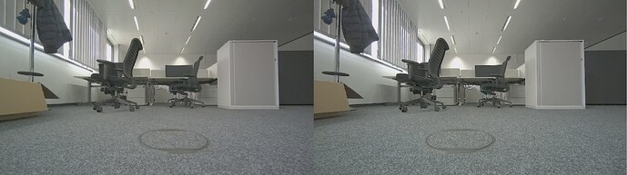

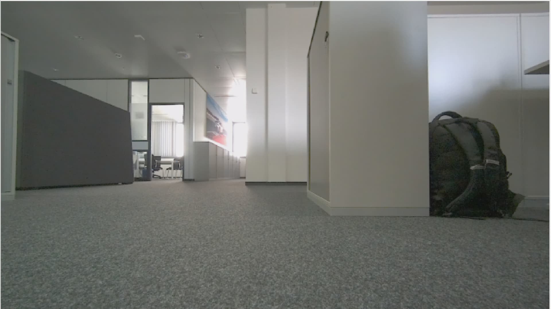

When I set downscale=3 in the ROS 2 wrapper config, I encounter the following:

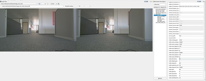

  • /left/image_rect_color becomes noisy

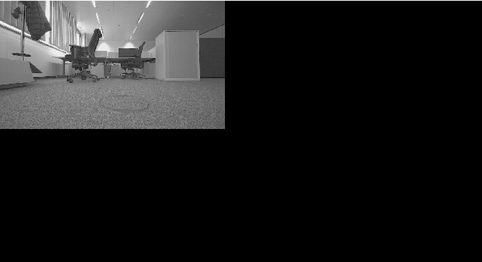

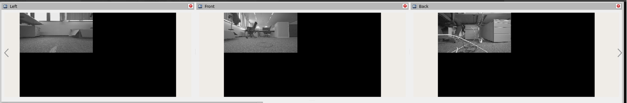

  • /left/image_rect_gray appears downsized, but only fills the top-left part of the frame. The rest is black (see attached image).

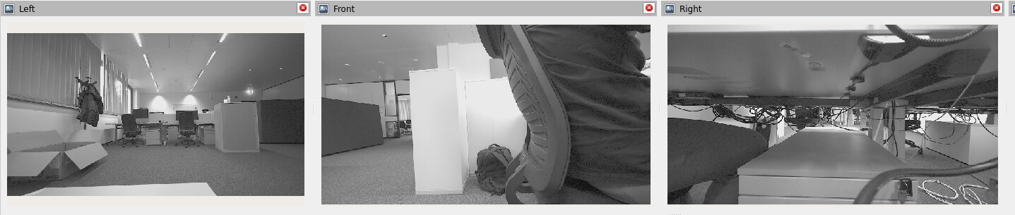

  • This issue happens on all 3 cameras.
  • No issue occurs when using downscale=2.
IMG_RECT:
IMG_LEFT_GRAY:
IMG_RIGHT_GRAY:
IMG_RAW:

Also here is my diagnostic report. I would love to hear a response, if there is some triaIs I can do or some actions I can take.
I would like to work with NEURAL_LIGHT, therefore I cannot rollback to previous SDK.

Hi @ba2sakal
I tried to replicate the described behavior, with no success.
Are you using the latest version of the ZED ROS2 Wrapper from the master branch?
Can you try to git pull and rebuild your packages?

Hey @Myzhar
This morning I tried my configuration with 3 cameras and it again gave the wrong sized gray image. I connect 3 cameras into the same serializer port.
I cloned master and rebuild and tried but result is the same:
/left/image_raw_gray is indeed without problem:
This problem occurs from Downscale 3. Any idea what might cause the problem or how I might solve?
Thanks!
Also good to include,
The rectified left/img_rect_color has the noise as it had with SDK 4.2( or the driver that time)
left/img_raw_color
left/img_rect_color
The /right/img_rect_color doesn’t have this blur therefore it doesn’t have the resizing issue of the gray image .
So I assume there would be a problem in the rectification step of the left images.
I just rolled backed to SDK 4.2.3, and the problem doesn’t occur.

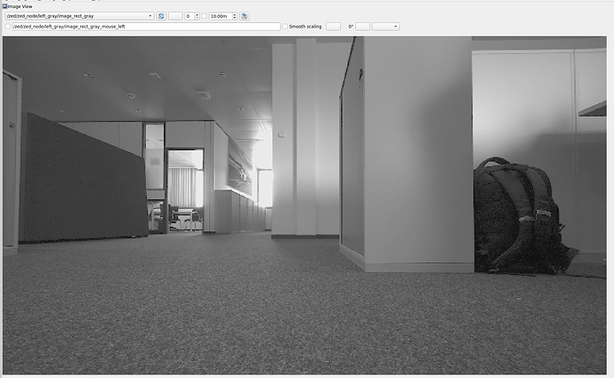

For now to isolate the problem I only connect 1 camera.
To further isolate I tried the error more with different configurations.
In ZED SDK 4.2.3 + Driver 1.3: there is never problem.
When I switch back to ZED SDK 5 + Driver 1.3:
With NONE = There is no problem
With NEURAL_LIGHT = I have the error that
left/img_rect_color → becomes blurry
left/img_rect_gray → becomes cropped
right images are all right.
Same with NEURAL…
Do you think maybe it is issue with GPU Memory or ?
I can provide some more log if you want.
Thanks!
Can you try to tune the dynamic parameter video.denoising
The VIEW::LEFT_GRAY is not cropped, it’s wrongly copied in the memory at the SDK level.
The bug has been reported.
The VIEW::RIGHT_GRAY image is not affected by this problem
Hi @ba2sakal
Thank you for all the important information that you provided.
The ZED SDK Team will fix this bad behavior in one of the next ZED SDK releases.
