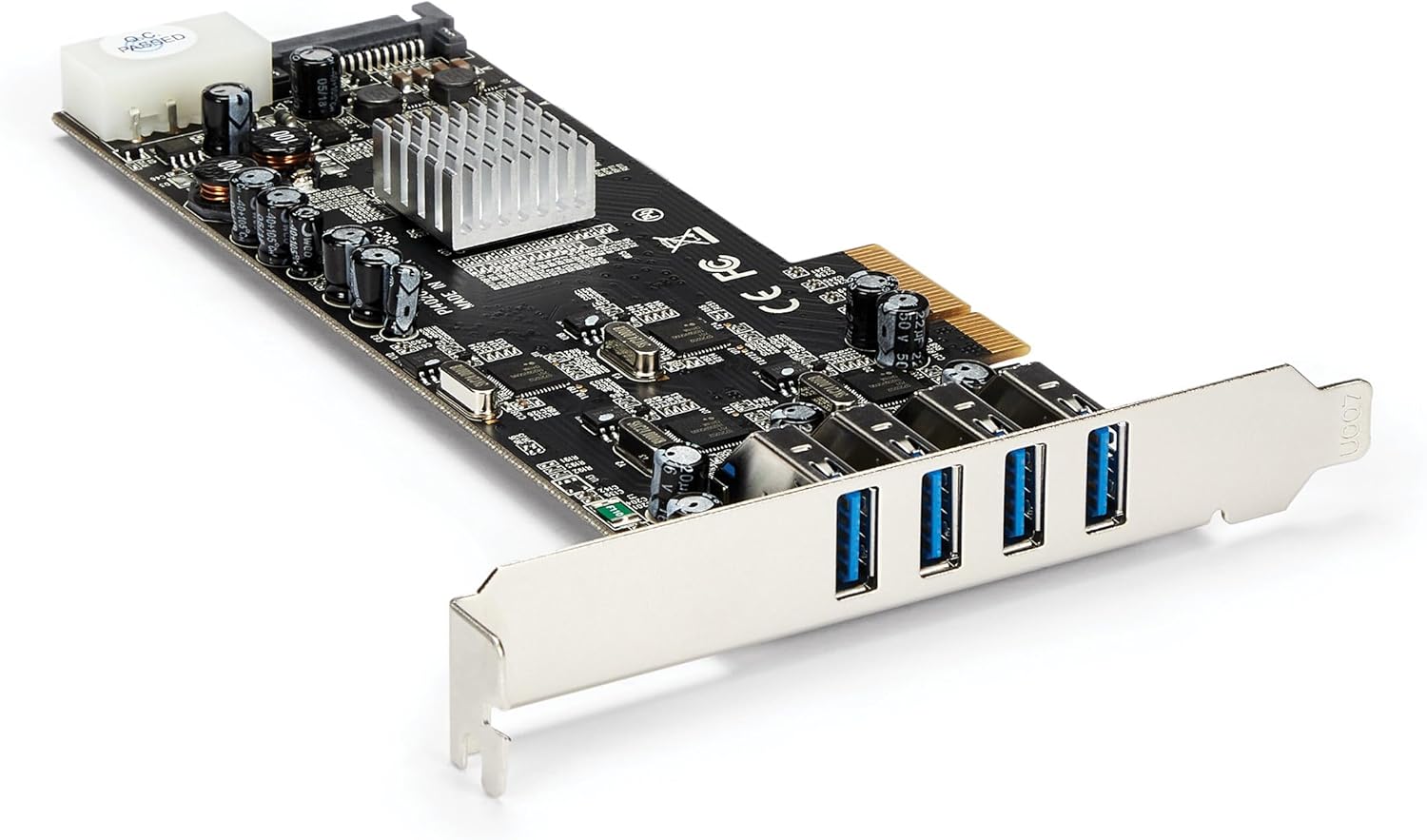

I purchased the pcie usb card and attached it to connect all cameras and now it shows

I tried on several different cables that works fine on other cameras, also flipping it upside down.
two out of three camera works just fine.

all cams are connected to this card.
zed mini is always working, and one zed 2i works perfectly fine, but one specific camera keeps showing that error.
if i connect that cam to computer port, it show low bandwidth error, while connecting to pcie card’s port show that the cam is detected, but cannot detect motion sensors

Have you connected the PCIe card to an external power source using the appropriate connector?
pcie card is being powered directly from 1600w power with sata cable
