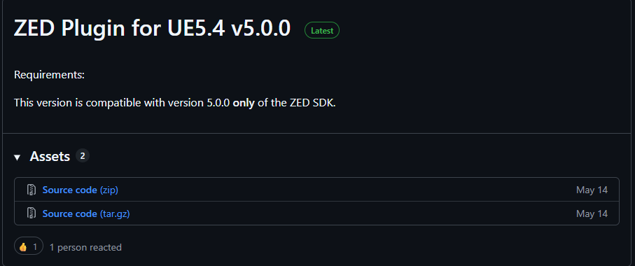

wut? So it is possible to install the plugin on UE5.6 as well? May I ask why you don’t advertise this on the github repo and on the help files?
LE: I just saw that you were talking about the livelink version. BTW, is there a place where I can find the difference between the 2?
Thank you!!
I can’t find the new version. May I ask that you share it? Or just downloading the github repo is ok?

You can use the latest available version of the LiveLink plugin with UE 5.6; no modifications are required for compatibility.
