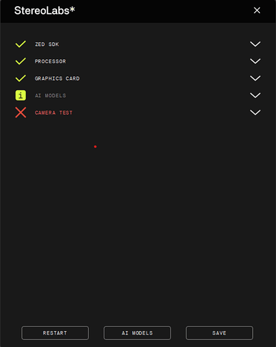

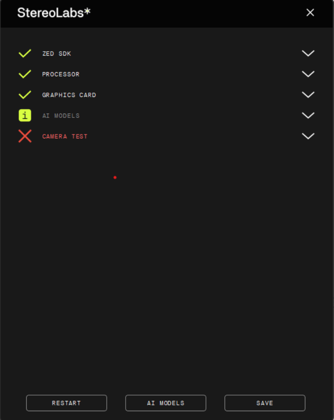

  1. ZED Diagnostic - Please see screenshot below. I believe the camera test fails because I am not using a physical camera. Instead, I am trying to setup the virtual camera. Also, ZED Diagnostic suddenly crashes and I am unable to save the results from the diagnostic. I have seen other people see this issue as well where the ZED Diagnostic just crashes.

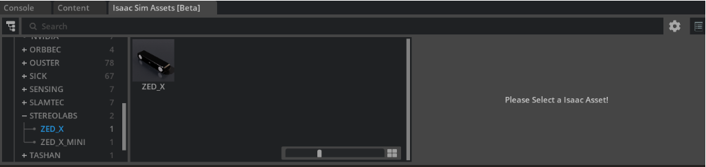

  2. Following the tutorial, I do see the ZED X Camera in Isaac Sim Assets Tab

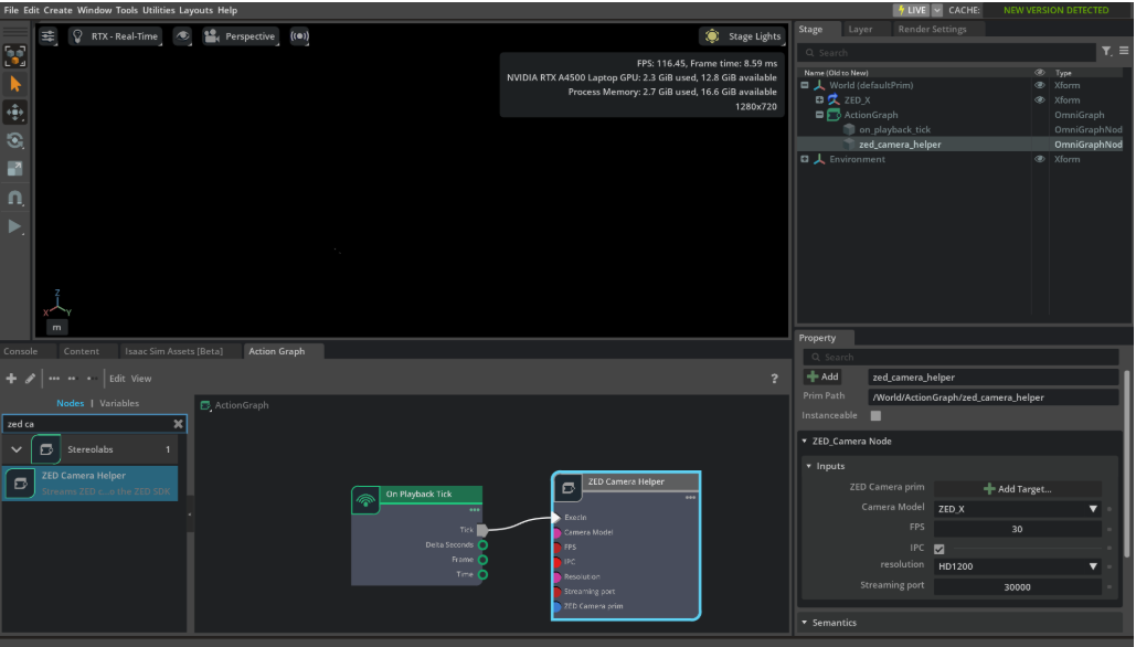

  1. Then, I created the Action Graph as mentioned in the tutorial. However, when I create the ZED Camera Helper node, I get the following warning
  2. Here is how it looks like after creating the action graph

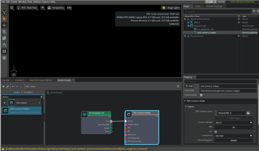

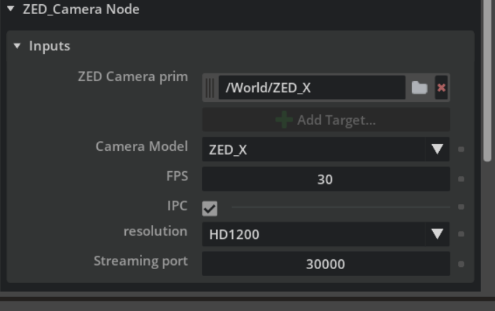

  3. Then, I add the target in ZED Camera prim property

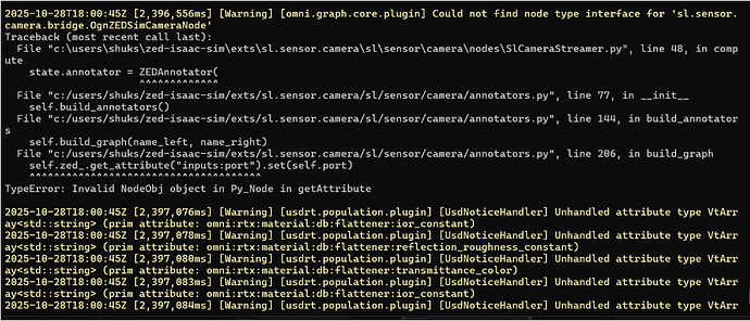

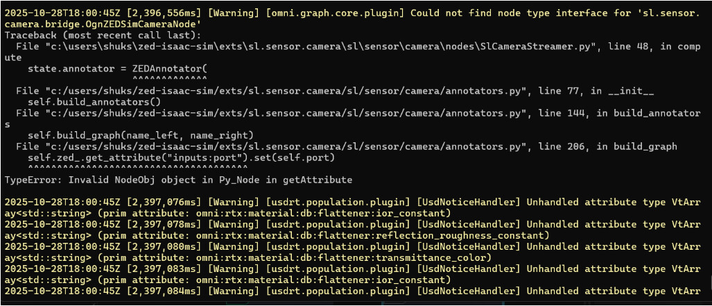

  4. As soon as I hit the play button, I get a warning. It can be seen in the screenshot below -
  5. This is what I get in the console after clicking the play button. First I get a warning about “not being able to find a node type”, then a type error and then a warning about “unhandled attribute”.

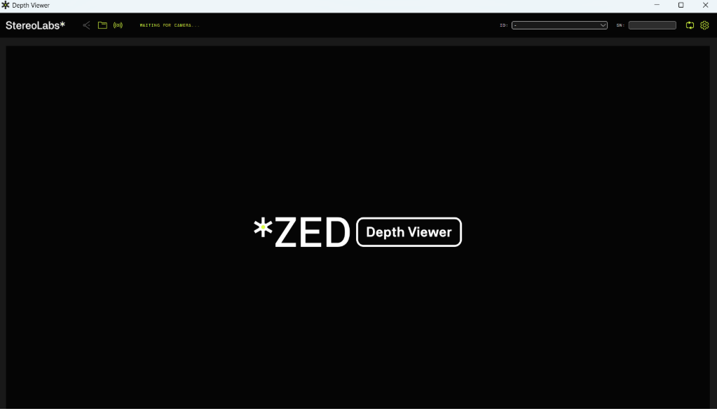

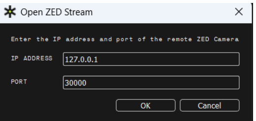

  6. Finally, when I open ZED Depth Viewer, I don’t see anything, not even being connected to any camera.
  7. Here is the IP Address and port number -
