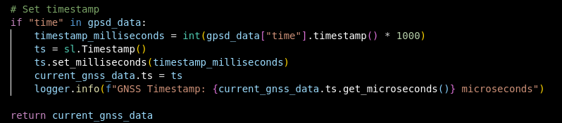

Hello @nathanL,
It seems to be an error related to timestamp unit. Could you print current_gnss_data.ts in micro_seconds to confirm it ?
Regards,
Tanguy

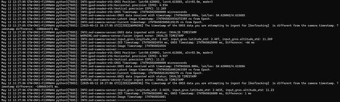

Hi @TanguyHardelin,
Thank you for your reply.
I have added a log as follows :
And this is what I get :
The timestamp in microseconds seems fine to me…

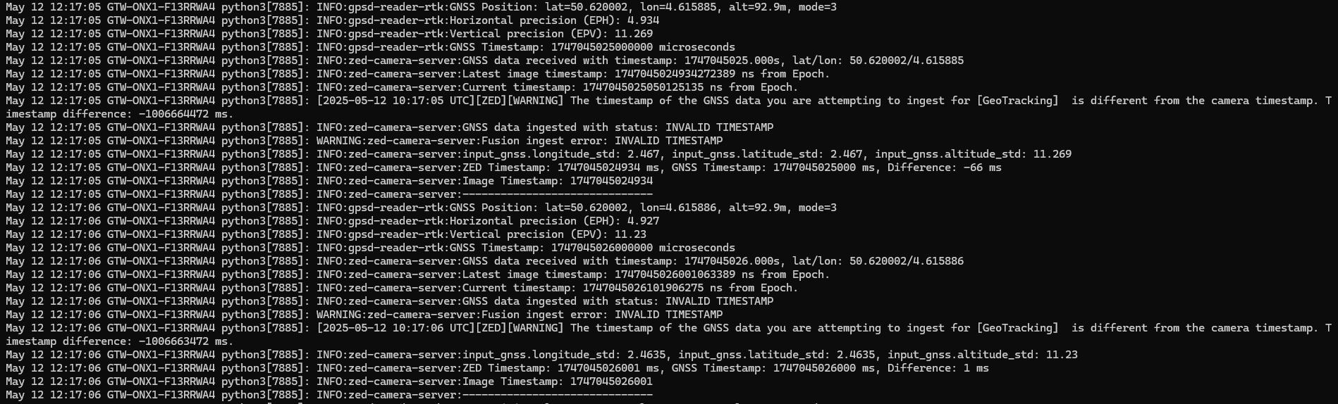

Some additional information:
I have logged the value of sl.get_current_timestamp() as well, and there is no difference either.
Where does the ingest_gnss_data() get the timestamps from ?
I’ve checked zed_camera.get_timestamp(sl.TIME_REFERENCE.IMAGE), zed_camera.get_timestamp(sl.TIME_REFERENCE.CURRENT), input_gnss.ts and sl.get_current_timestamp() and they all have reasonable values.
I updated my zed sdk to version 5 and I have the same issue. As stated before, I had no timestamp issue in version 4.1.3, only a covariance one, which to me seems less severe but I don’t know which error is treated first in the sdk…
From what I understand, the camera timestamp treated by the fusion is 11 days in the future from now (-997924472 ms). At the time of posting, it was 17 days (-1494893472 ms). So the “camera” timestamp used by the fusion is a fixed value in the future which corresponds to :
Sat May 24 2025 01:54:49 GMT+0000 (1748051689472 ms).

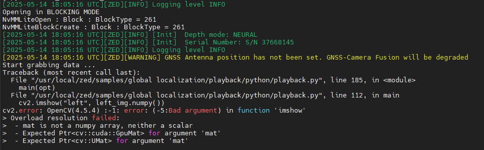

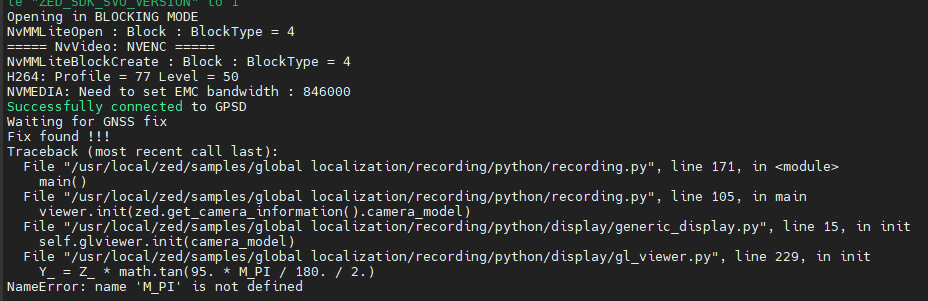

I’ve used the recording and playback samples and I had the same error. Interestingly, I’ve also had issues before I could run them.
First issue (recording sample) :
Second issue (playback sample)
I’ve simply changed M_PI to math.pi and commented the imshow function so that I could send you the svo2 file, but now I’m thinking these issues might give a hint of why the “invalid timestamp” error happens ?
