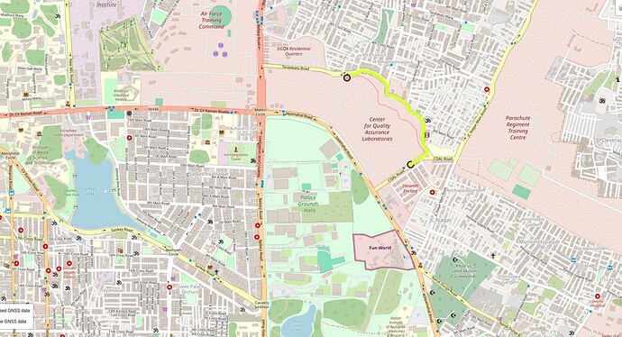

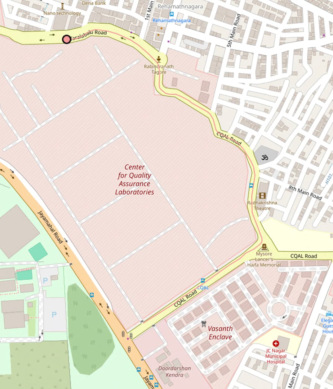

Also, could you please let us know the maximum vehicle speed we can maintain to achieve good sensor fusion accuracy, assuming a camera frame rate of 60 FPS?
You can view the visualized fusion results here:
on original covariance
on hardcoded covariance
Looking forward to your insights.

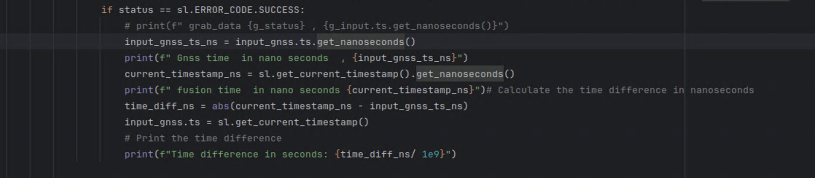

As you suggested i have set my mode to NEURAL but while ingesting GNSS to zed i am getting INVALID TIMESTAMP issue apart from any Non performance depth mode iam getting INVALID TIMESTAMP but As u informed in the difference is expected to be less than 4 seconds i have verified difference betweeb GNSS Time and sl.getCurrentTimeStamp() it is less than a second still iam getting INVALID TIMESTAMP.
Observations:
  • The GNSS timestamp and the sl.getCurrentTimeStamp() are less than 1 second apart, which is well within the <4s threshold mentioned in the docs.
  • The issue disappears when switching to a performance depth mode (e.g., PERFORMANCE).
  • The error only occurs in NEURAL and other non-performance depth modes, which are necessary for our use case due to the scene’s complexity and speed.
CODE
LOGS
Additional Notes:
  • As you suggested earlier, we are actively working on increasing the GNSS covariance to assist with fusion stability.
  • The INVALID_TIMESTAMP issue appears tightly linked to NEURAL mode — possibly due to an internal delay or different sync behavior compared to PERFORMANCE mode.
