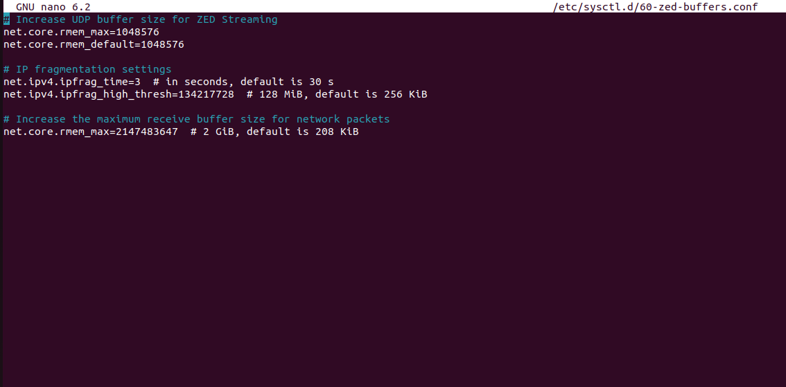

Hi @hamdan11
I recommend you read the DDS tuning documentation:
In particular, regarding this:
you must apply this:

even after tuning that the buffer issue still pops up and i configured the x86 in the same way and now

Have you rebooted the devices after setting these values?
What’s the output of the command sysctl net.core.rmem_max net.ipv4.ipfrag_time net.ipv4.ipfrag_high_thresh?
YES i have rebooted the systems post configuration..
net.core.rmem_max = 2147483647
net.ipv4.ipfrag_time = 3
net.ipv4.ipfrag_high_thresh = 134217728
the above is for agx
lwalpha@lwalpha:~$ sysctl net.core.rmem_max net.ipv4.ipfrag_time net.ipv4.ipfrag_high_thresh
this is for x86…

You set the grab rate to 30 Hz
You set the publishing rate to 15 Hz
You have no “cap” limits
You set point cloud publishing to 10 Hz.
In this case, you should receive image and depth map messages at 15 Hz, point clouds at 10 Hz
okay now i have set the capping limit and configured according to this Stereo Node Frequency Tuning | StereoLabs
im getting around 45 FPS when the node is at 60 but the question is .. when i cap the compute using general.grab_compute_capping_fpsas ive set this at 45 ish the quality wont be compromised ryt?
What do you mean? What “quality” are you afraid is compromised?
i mean to say the Depth and the image quality woudnt be affected ryt??
No, the FPS does not affect the quality of images and depth
