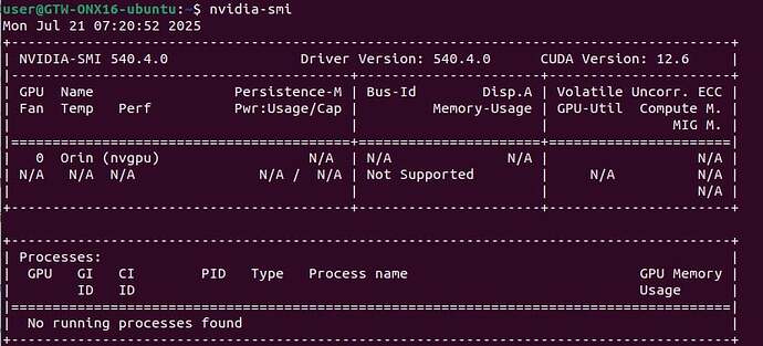

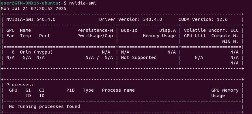

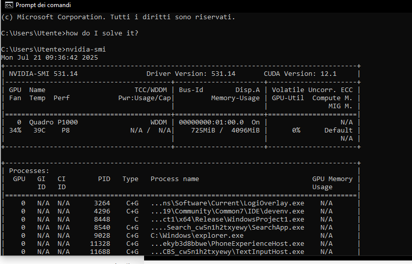

When I run the nvidia-smi command on both machines, I get these results:
In prompt I run nvidia-smi and I have
In Windows now I can’t even open videos recorded in Linux before the SDK update.
As suggested in a previous post( your GPU (Quadro P1000) is actually not compatible with TensorRT 10, you must install TensorRT 8.) I installed the SDK 5.0.3 for Windows TensoRT 8 and CUDA 12.

Hi, I have CUDA 12.1.
Before SDK 5.0.3, I had SDK 4.1.4 and was able to run applications… Do you still recommend uninstalling CUDA 12 and install CUDA 11? Thanks in advance.

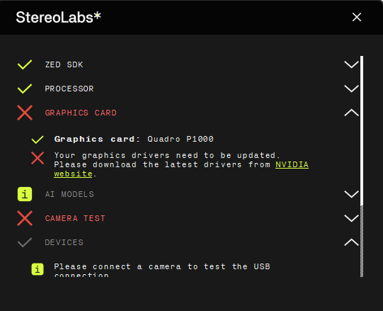

Please run ZED Diagnostic and send the report file that it generates.
I don’t have the camera connected
ZED_Diagnostic_Results_2207.json (7.4 KB)
Hi, I updated graphics drivers and now the ZED Diagnostic no longer give errors for drivers, but when I run ZEDfu I get the error: ‘NO GPU COMPATIBLE’.
This is new ZED Diagnostics file
ZED_Diagnostic_Results.json (7.2 KB)

In the Diagnostics results file I have “CUDA loading”: false

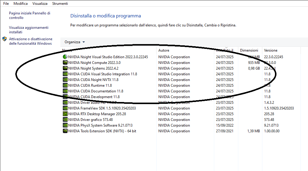

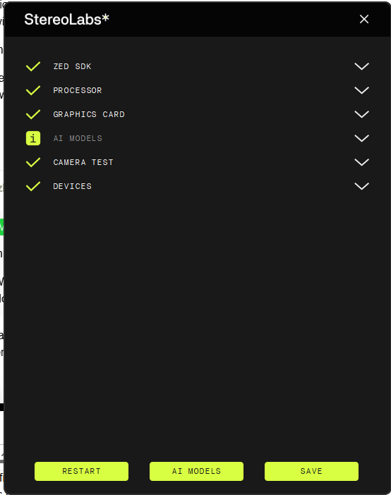

I uninstalled CUDA 12 and installed ZED SDK and so CUDA 11… Now ZED Dignostic seems to be error-free… I’ll send the saved file (it still has “CUDA load”: false) and the screenshot of ZED Diagnostics… But ZEDfu(whether I run it in LIVE mode or in SVO mode) still gives me the usual ‘NO GPU COMPATIBLE’ error.
I’ll also send the screenshot with the NVIDIA installation files…

ZED EXPLORER works!! How do I solve ZEDfu error: ‘NO GPU COMPATIBLE’?

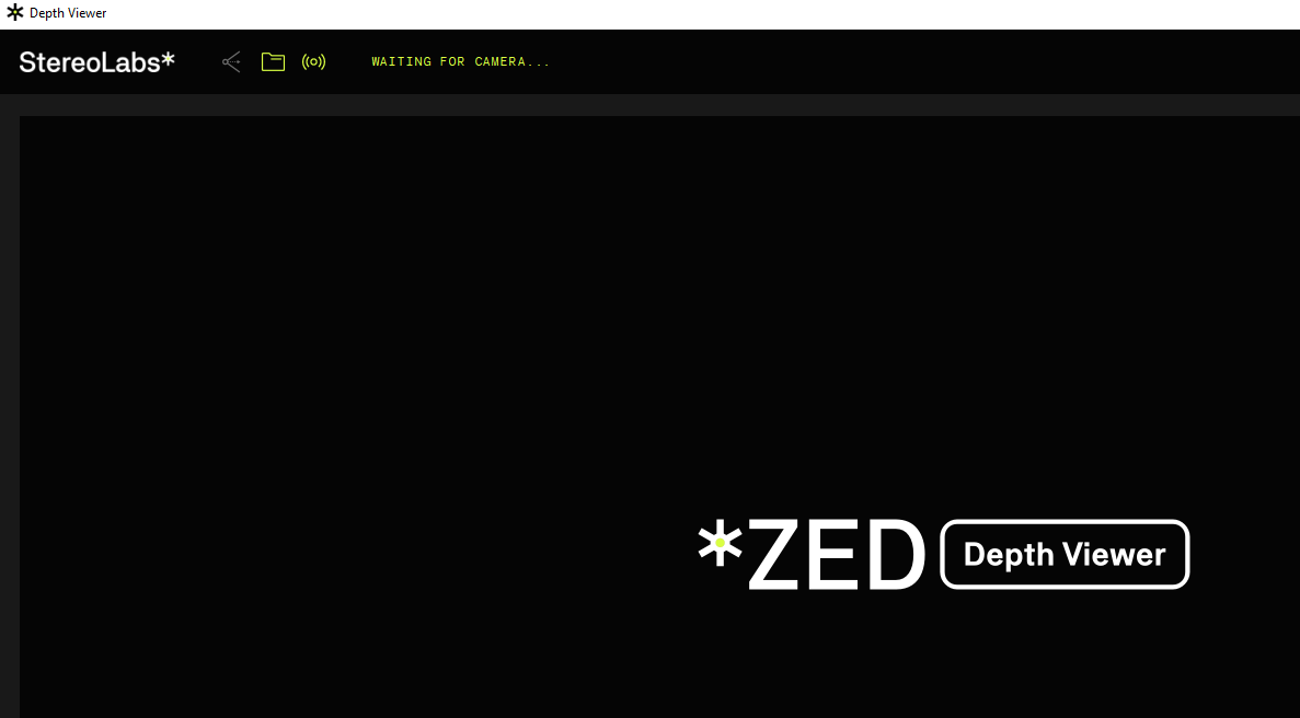

Does ZED Depth Viewer work?
I tried to open an svo2 file in ZED Depth Viewer, but the program keeps displaying, after five minutes, the message ‘waiting for camera …’ See attached image
