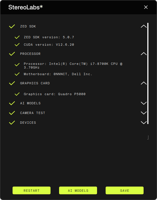

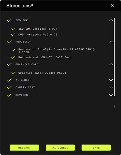

I have a Quadro P5000 and installed the ZED SDK 5.0 for Pascal GPUs for Ubuntu 24. Like "@masaan” the ZED Diagnostic is error-free and the ZED Explorer works, but I get the same ‘NO GPU COMPATIBLE’ error when opening ZEDfu and the ZED Depth Viewer doesn’t work either.

Unfortunately I can’t upload files yet as I’m a new user. But here is its content:

Hi @legasi
First of all, I recommend you upgrade to the latest ZED SDK v5.1.1.
Are you using a laptop or a desktop PC?
Hi @Myzhar
I’m working on a PC. I have already tried to install the newest SDK, but it couldn’t optimize the ai models as I have a Pascal GPU (Quadro P5000), which I think isn’t adequate with TensorRT 10. But SDK 5.0 offers versions with TensorRT 8 for Pascal GPUs, which passed through all the tests of the ZED Diagnostic.
