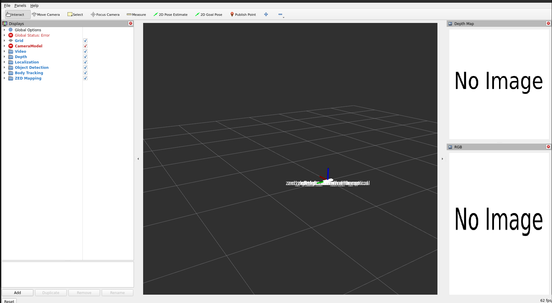

ros2 launch zed_display_rviz2 display_zed_cam.launch.py camera_model:=zed2i enable_ipc:=false
Afterwards the Figure below showed up. Camera was connected but no image was displayed.
Can you help me with this connection?

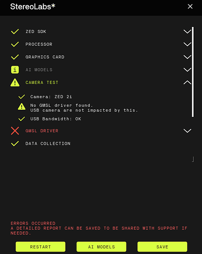

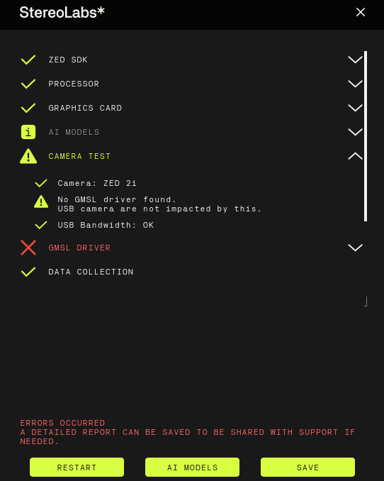

Can you share the log of the node and a screenshot of the diagnostic status?
when we start the node ros2 launch zed_wrapper zed_camera.launch.py camera_model:=zed2i enable_ipc:=false &we often at first recieve this message

This is the expected output. The node is running.
Please take a screenshot of the Diagnostic and share it.
The diagnostics is fine I just tested on the jetson. It is a matter of starting your node which blocks everything and does not accept request of ros2 topic echo etc.
I ran the Diagnostics on the Jetson
In this section we defnetly need the two terminals and echos which are actually blocked. Tutorial - AprilTag Detection with ZED and Isaac™ ROS - Stereolabs
I think that the basic docker setup of your package is not enough. Can you please check which options you have to switch on to be able to see everything. I printed everything out in the run_dev.sh

How can I visualize the detection in rviz like this? In rviz there is this topic not there. Tutorial - AprilTag Detection with ZED and Isaac™ ROS - Stereolabs
Please add details. What entry point script was wrong? Your custom entry point or the entry point described in the documentation?
This is simply a point cloud + TF visualisation, no specific settings are required.
Have you applied the fix to the AprilTag package as described here?
