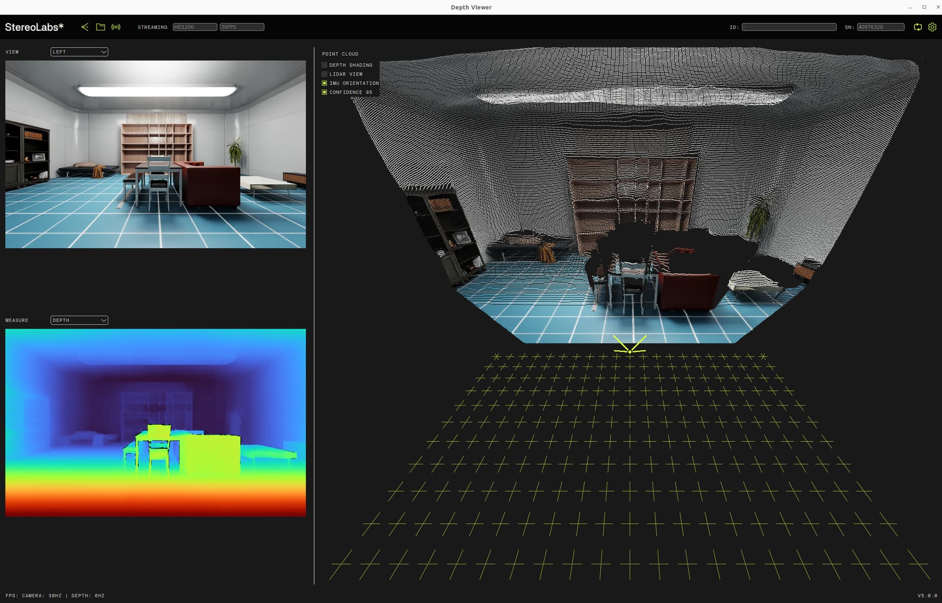

However I can visualize the data through ZED_Depth_Viewer

Can you try to open the virtual stream with ZED Depth Viewer and check that the depth is correctly extracted?
Actually I sent you the screenshots from ZED tools in my first post, I wanted to send them in advance in case if needed. Can you please check the first post for the screenshots and the terminal loggings ?
It seems like ZED_Depth_Viewer can correctly show the depth.

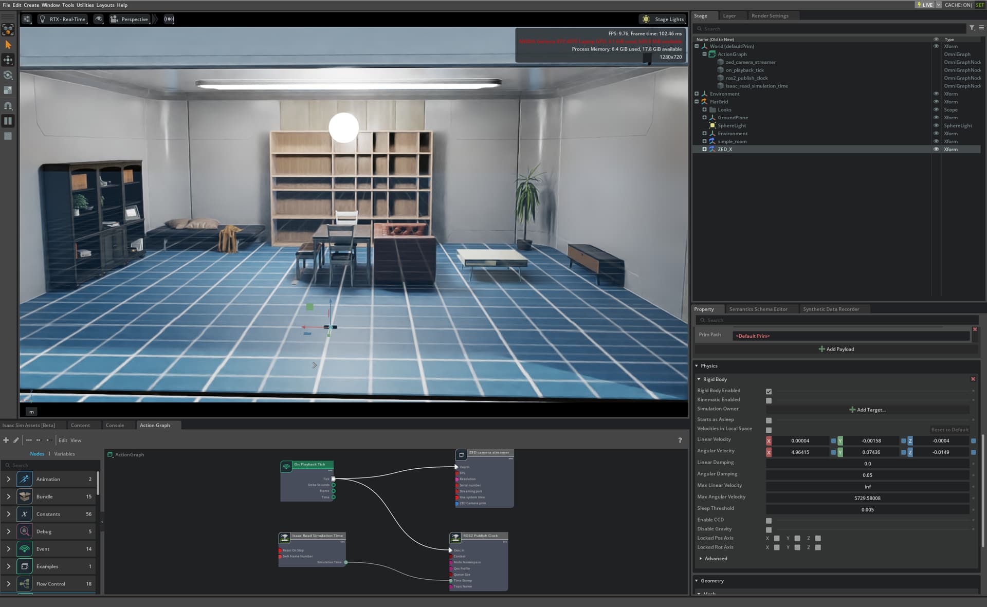

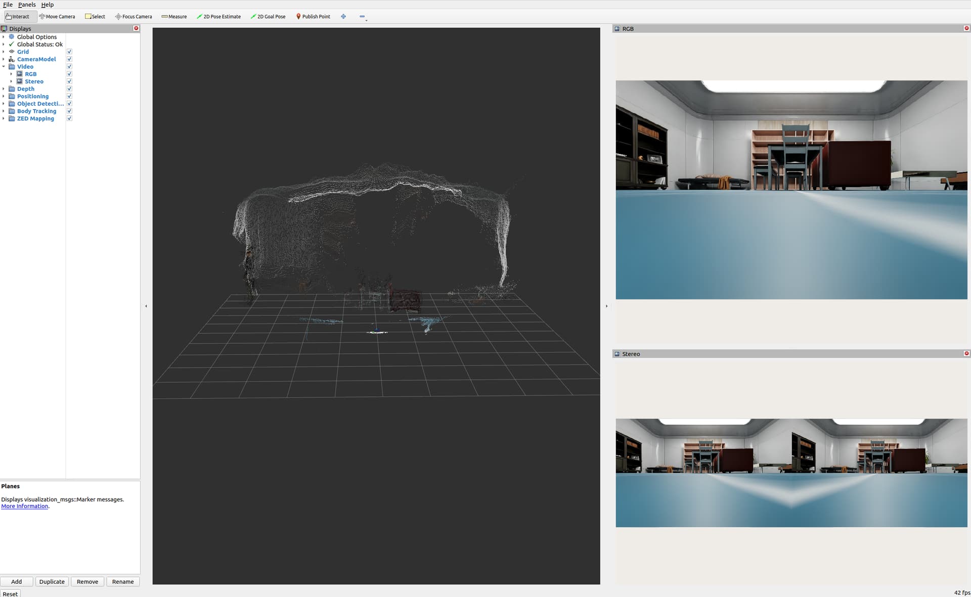

here is the rviz and isaac sim

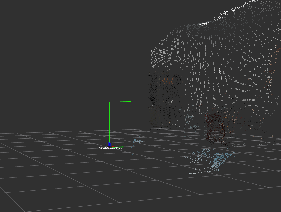

and i can actually see the path generated on rviz, but the camera doesnt moving there. And I wonder if there could be a parameter or something else that blocks it.

How are you moving the camera? Are you sending commands to ISAAC Sim?

Should I have sent the commands to Isaac Sim by adding new components to my action graph?
The ZED Node does not have this feature.
You must move the camera in the simulator environment to see the camera move. The ZED SDK Localization module will process the information and track the movements and the ZED ROS2 Wrapper will update the TF and the pose and odom messages
Yes, exactly :slight_smile:
