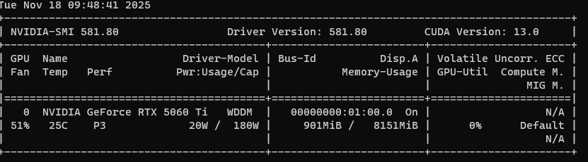

Yes, still same issue persists. Here is more information on latest graphics driver cuda 13 compatibility and zed sdk for cuda 13 and cuda 13 sdk install.

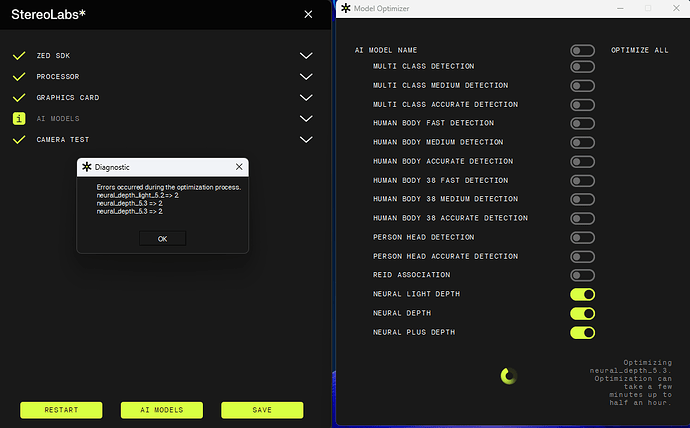

Also tried the command line version of model optimization. Failed there as well.
C:\Program Files (x86)\ZED SDK\tools>“ZED Diagnostic.exe” --nrlo
[ZED_Diagnostic] Optimizing NEURAL depth mode for target device
Optimizing: NEURAL DEPTH…
Downloading neural_depth_5.3 100.0%[========================================] 27.7/27.7 MB Done
Optimizing neural_depth_5.3 | 0.0% [> ] ETA: 33min 20s
See attached diagnostics
ZED_Diagnostic_Results.json (8.5 KB)

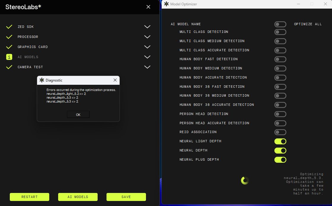

As a final test, please clean all the AI models and try to download and optimize them all from scratch.
did run the ZED Diagnostics.exe with aic parameter. Cleared. Same result. Optimization fails.
