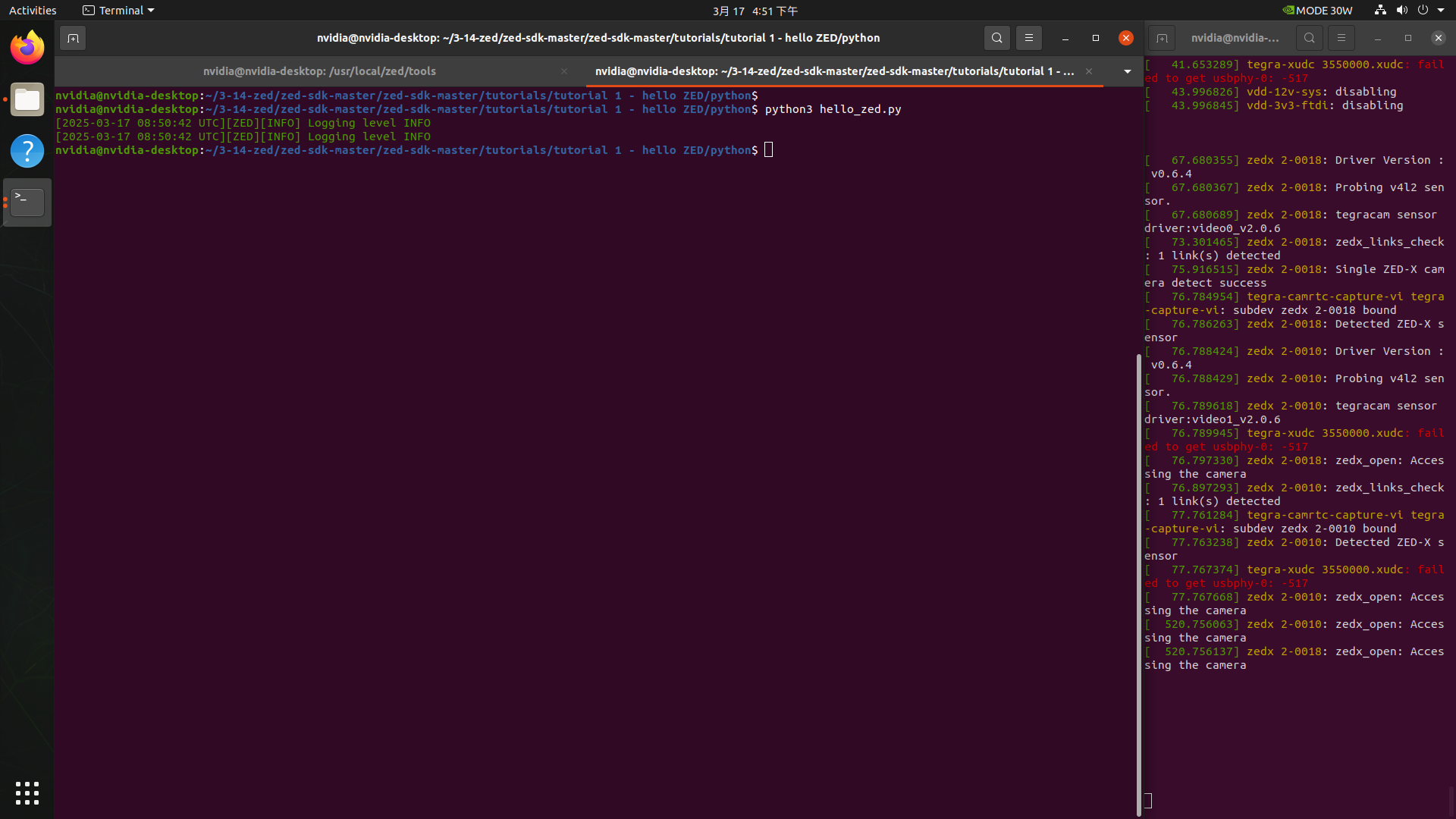

When I execute the command python3 hello_zed.py, I didn’t see the SN of the camera.
(upload://kTlWHBpLWG902QduFYQ0YYHFy3d.png)

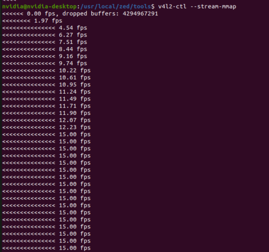

If you are creating a driver with a custom board, we would recommend checking if the v4l2 devices are correctly created with this command:
v4l2-ctl -d /dev/video0 --stream-mmap
As we focus on supporting our products and the systems of our partners, we do not have the resources to support all carrier boards that are available.
For this reason we will not be able to assist in the development of a driver for your specific carrier board.
I will leave the post open for other users to help if you are willing to share information on your board / capture card.
Thanks for your understanding.
Hi,very glad to see your reply.
And command:
$ v4l2-ctl --stream-mmap --stream-count=1 -d /dev/video0 --set-fmt-video=width=1920,height=1200,pixelformat=UYVY --stream-to=output.yuv
I get output.yuv
But when I input the command nvgstcapture-1.0 or other, I fail to capture the image.
And when I execute the files in the engineering directory, I still fail to obtain the images from the camera.

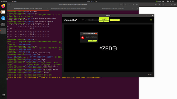

Hi, are you able to detect the cameras when you run ZED_Explorer -a ?
Hi, when I run ./ZED_Explorer -a, I get
No ZED detected
And, when I run python3 hello_zed.py in the directory /usr/local/zed/samples/turotials/tutorial 1-hello ZED/python/, I fail to obtain the camera’s SN.
Thanks.
